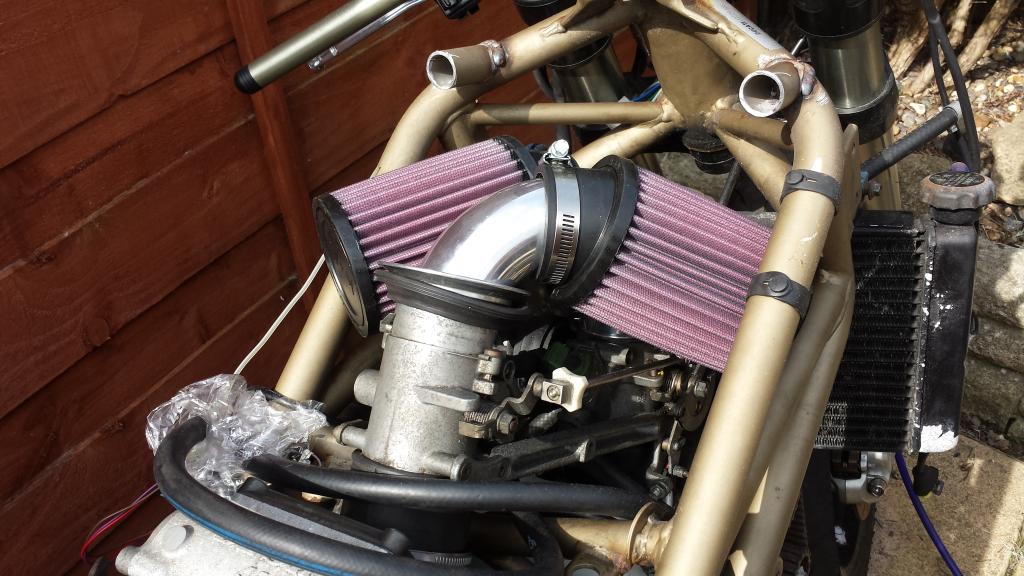

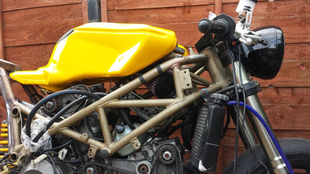

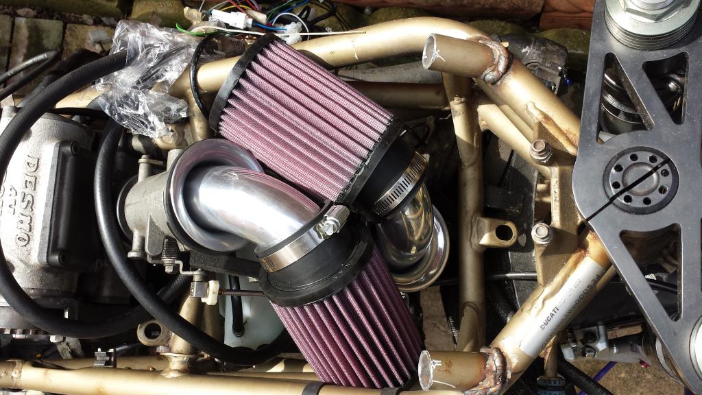

  2. Finally a bit more progress, after some advice from PHILLIPO and Mark I have trial fitted the air filters. It all fits perfectly, all I need to do now is cut off the top of the intake trumpet and have the 90 degree bends welded into them.
    Unfortunately it means that the panel I made to fit under the tank doesn't fit so I will have to rethink a couple of bits and pieces.
  3. Looking good mate. I'm going to go back to making an air box for mine. I'm loosing a lot of power top end and the intake noise is crazy.
  4. The stock airbox should go back in with a few modifications if its too loud but I kind of like the idea of it being a bit lairy...

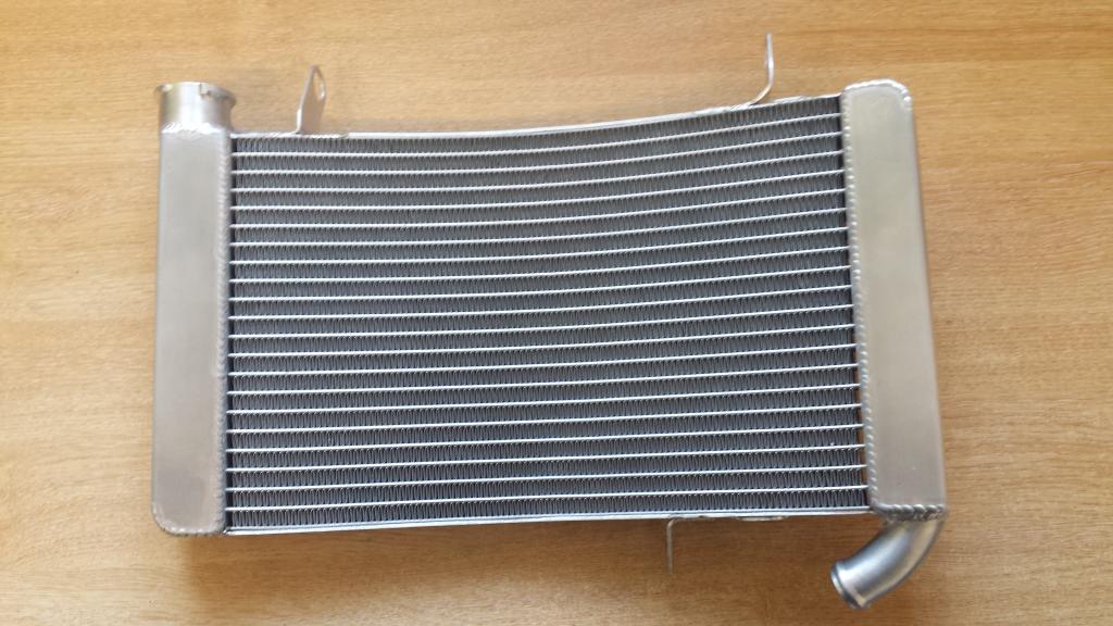

  6. I decided that the stock radiator was not worth saving so I commissioned Forge Motorsport to build me a custom one, I'm REALLY happy with the results too!
    As the bike is water cooled it was always going to be a challenge to hide the rad and pipework away, so instead I'm making a feature of it...
  7. Is it a modified 916 unit?
  8. Its all new mate, based on the measurements of my ST4 rad with the overflow pipe relocated

  10. I like the rad a lot, I was thinking having one made for the ST2 not as long (wide) but double core to cope with the heat. Was yours top dollar??
    Yorkie
  11. It was cheaper than a new one from Ducati...
    £400 not exactly cheap but a good chunk cheaper than most of the radiators I have seen online.

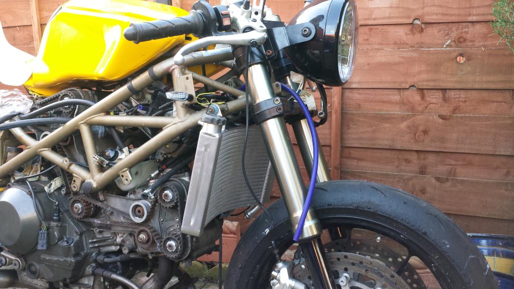

    Well i trial fitted the new rad, it's near as damn it perfect!
    I have also finalised the location of the front indicators (I just need to trim the plate they are fitted to down). The rear light is wired in and working perfectly too.
    It's coming together now, I still have the monumental job (for me anyway) of shortening and tucking away the loom, it scares me tbh...
