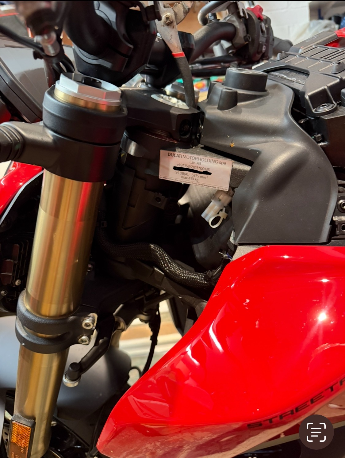

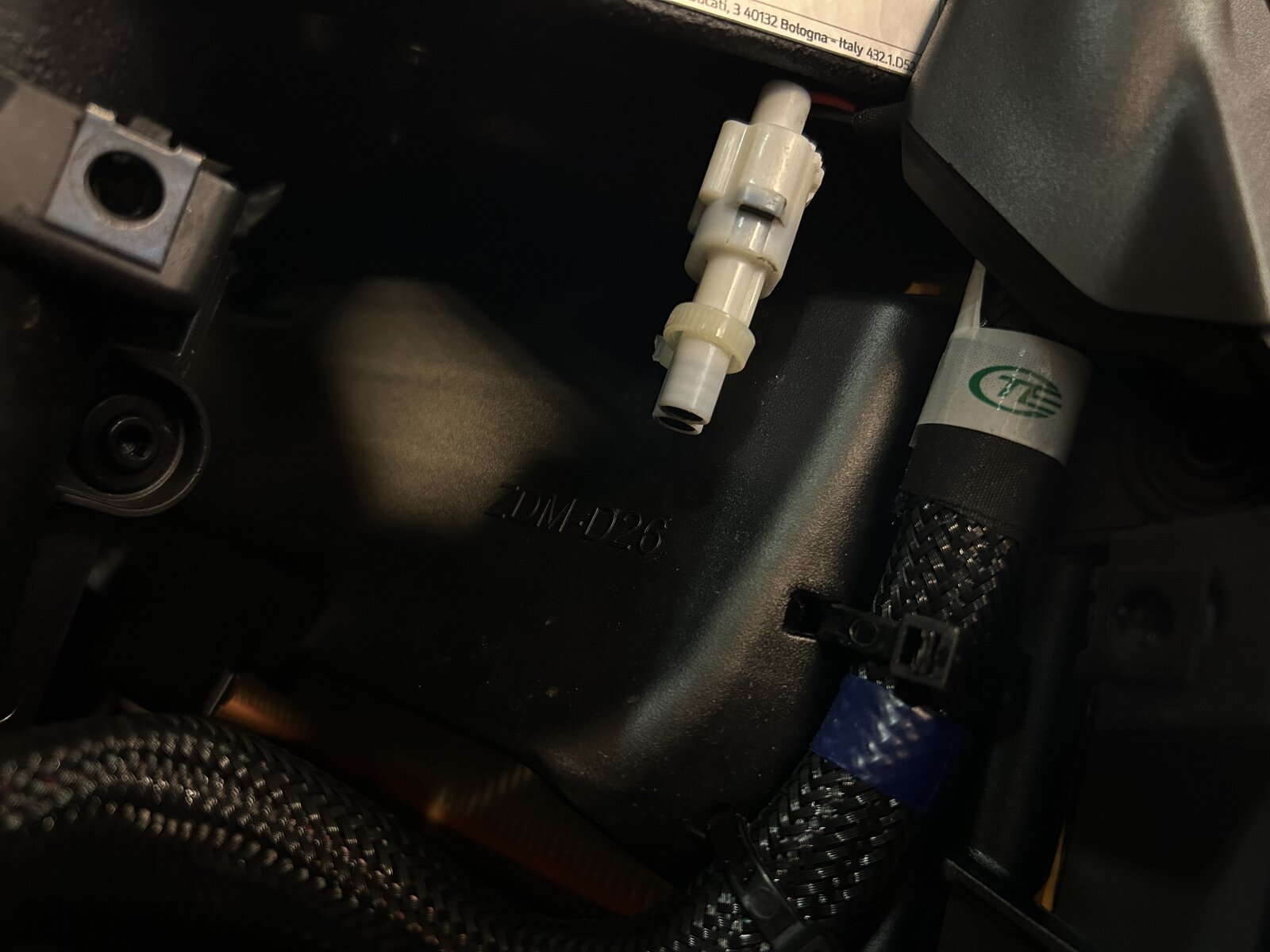

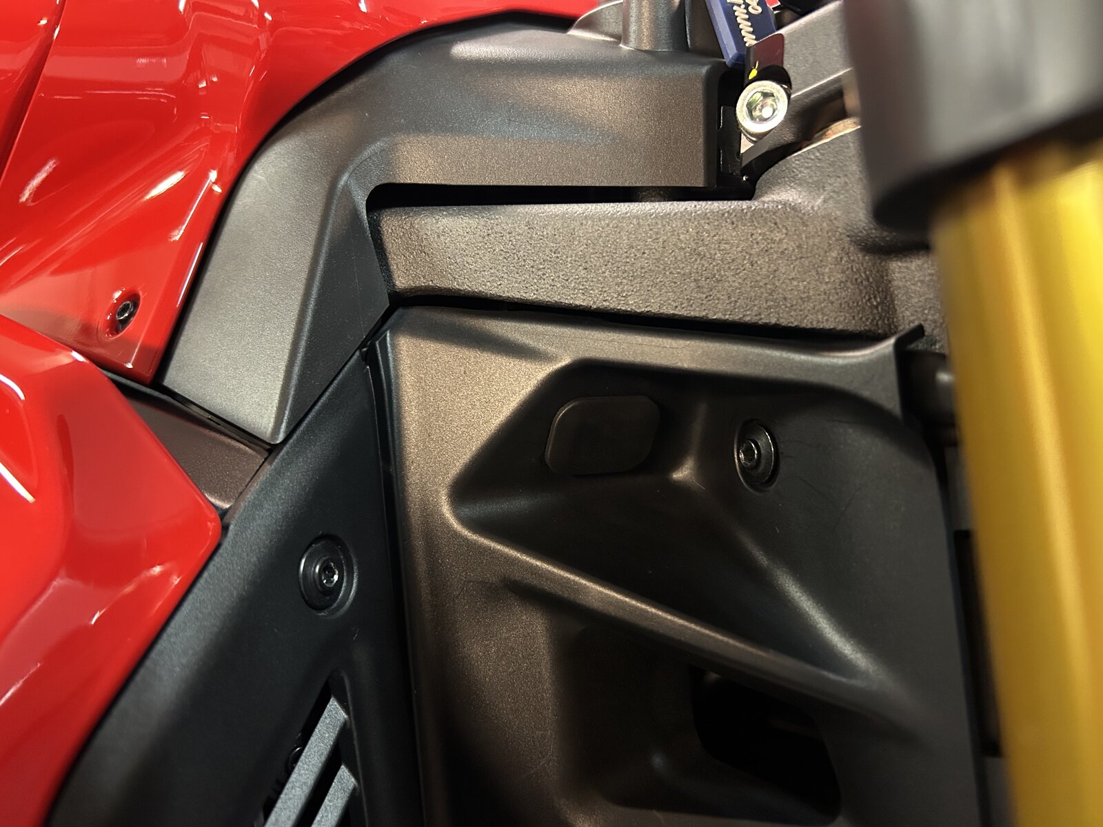

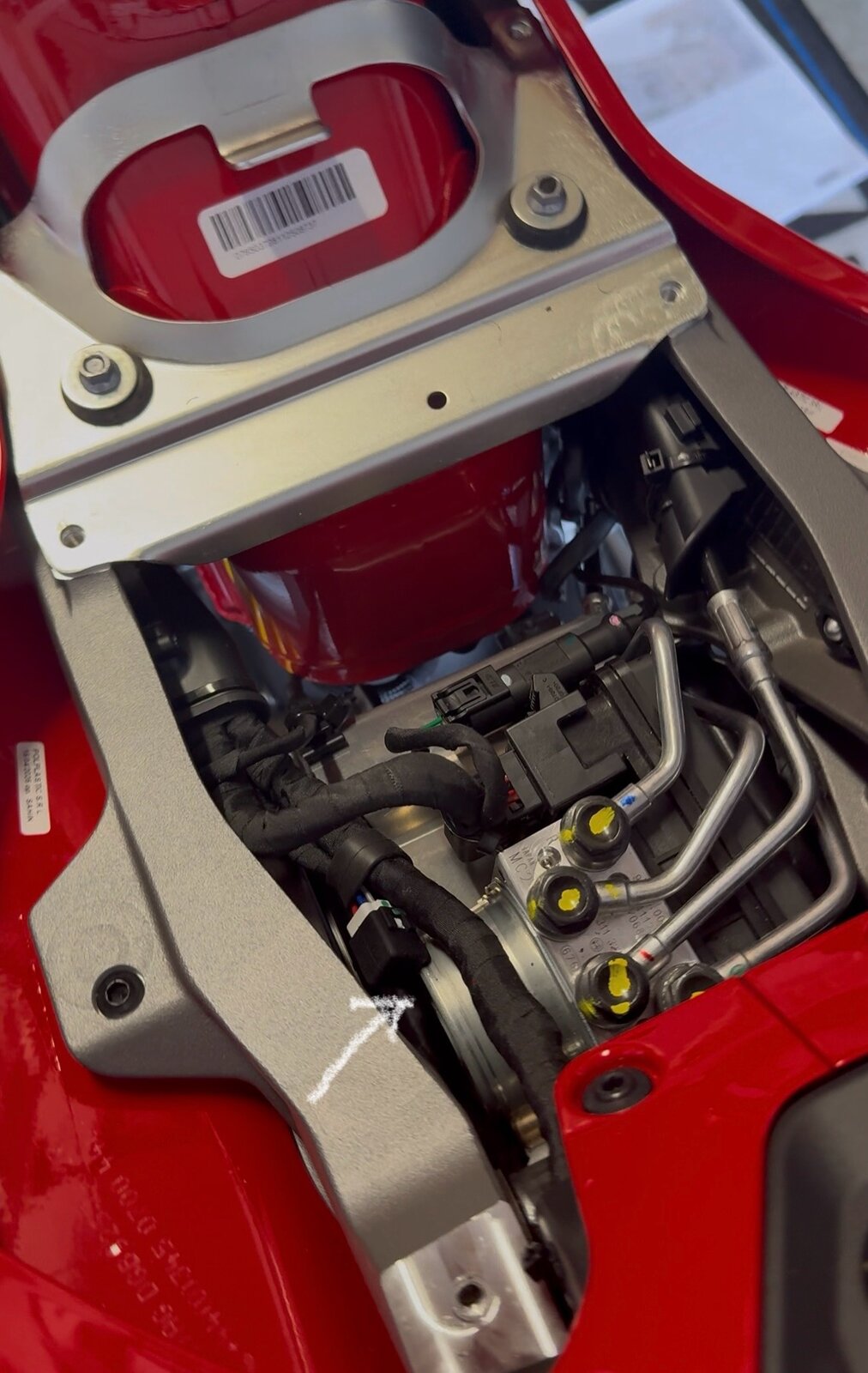

  5. I also have the USB plug on back order.
    The install location is right below the ignition key on the right hand side.
    There is a rubber grommet that you remove.
    On the second picture I have removed the plastic shields to reveal the power plug and the last picture is from the left hand side with the plastic shields removed.

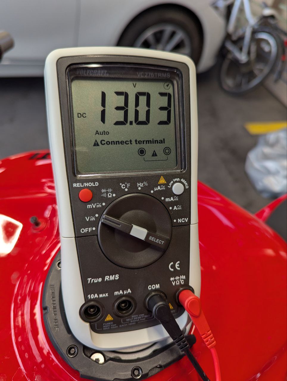

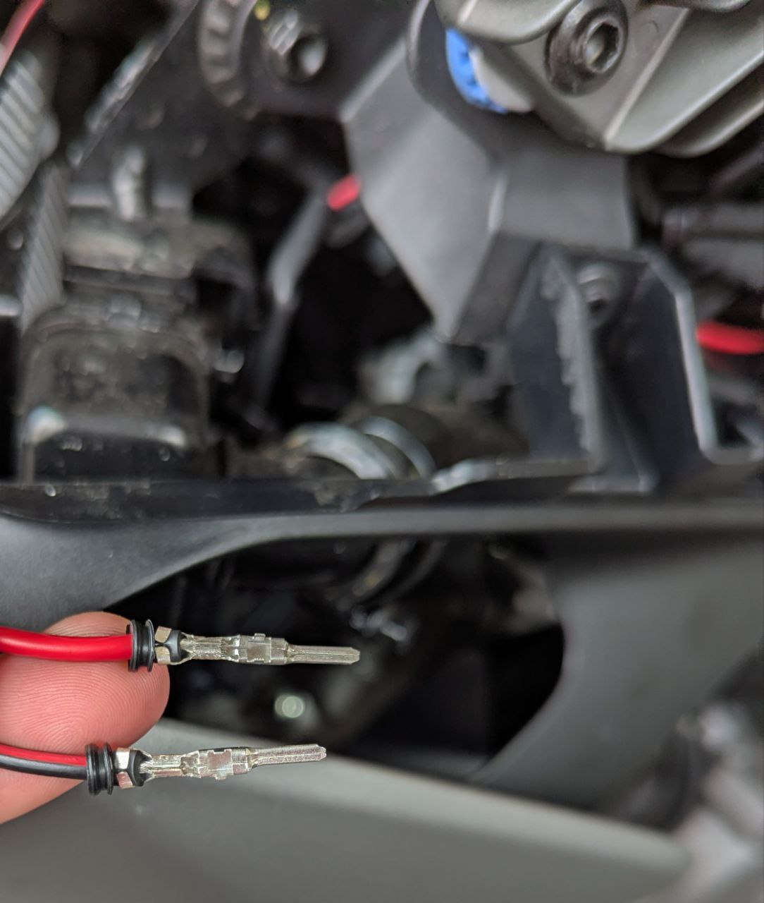

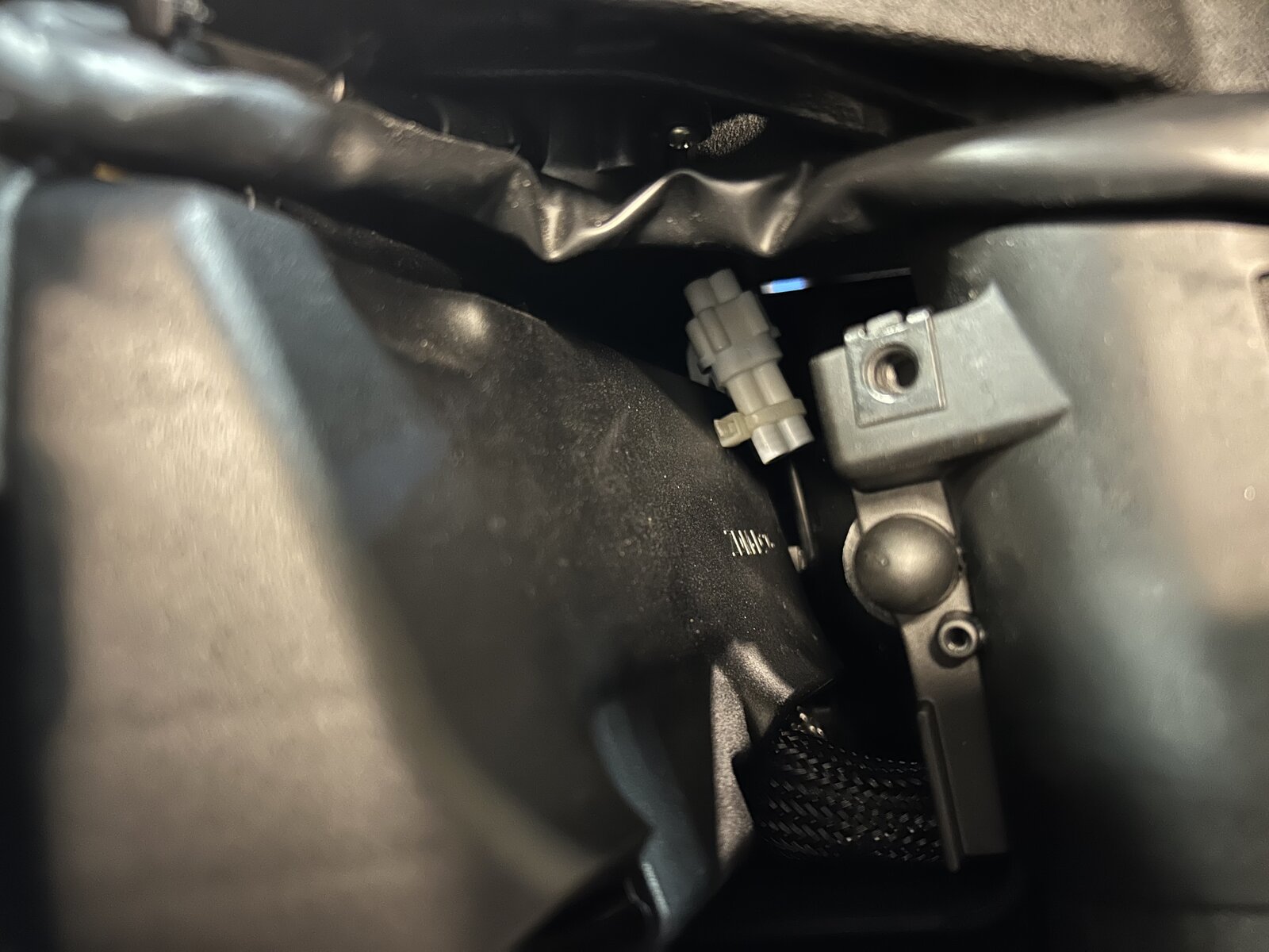

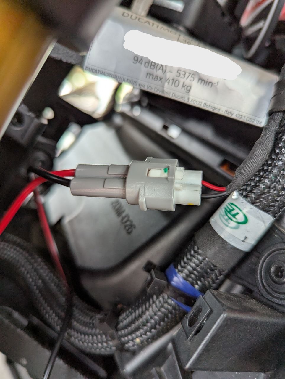

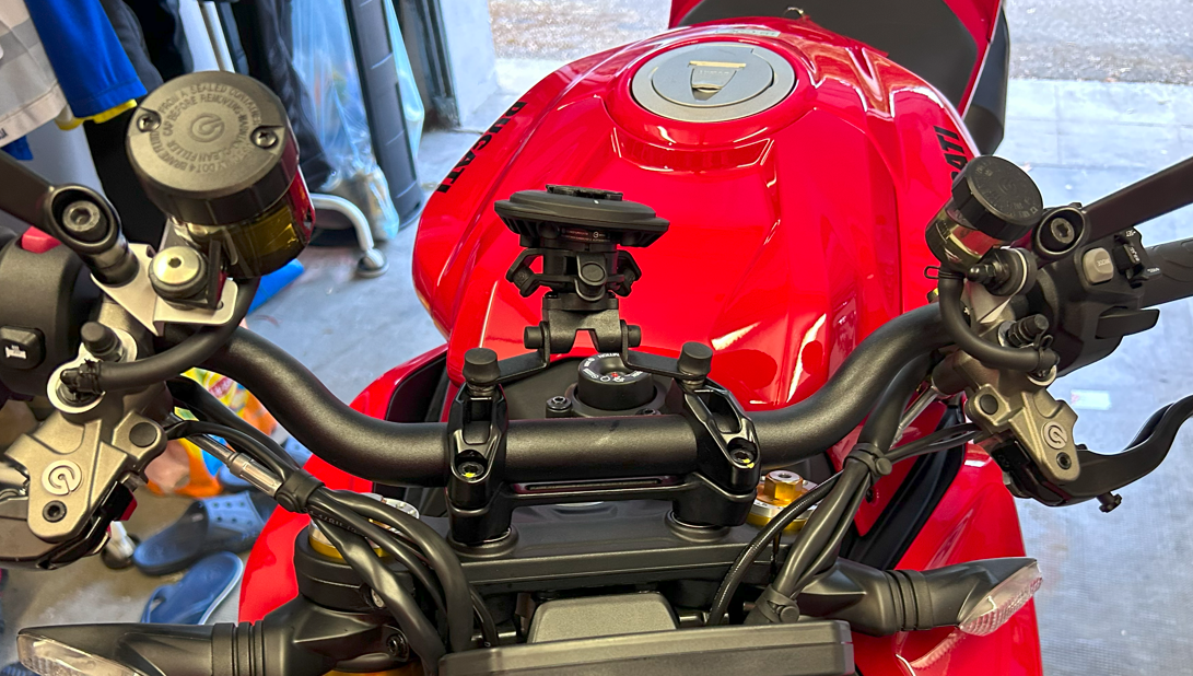

  13. Thanks to your connector link and information, I've been able to successfully install my Wireless Charging head from Quadlock.
    I can confirm that the connector has 13V available without any activation required and the connector from Amazon works well and is of good quality (thx Stripy!!).
    As for installation, if you have the 12V native wireless head from Quadlock, any 12v native accessory or the official Ducati accessory, everything can be setup easily next to the connector.
    If you have a bigger setup, like mine, you can put any bulky piece under the seat, there is plenty of room. Then, it is easy to route the cables to the front, hidden from sight and well secured with zip ties. I don't think it is a good idea to try to put everything next to the connector as it is also the location of the air filter and air intake. Would be a bad idea to block the airflow.
    The issue for me is that I need the 12V to USB adapter from quadlock so that I have maximum compatibility with some (Google) Pixel phones. If you don't need that, the normal 12V wireless head is way cleaner and easier to install (no bulky adapter and extra cabling). See this comment for better explanation.
