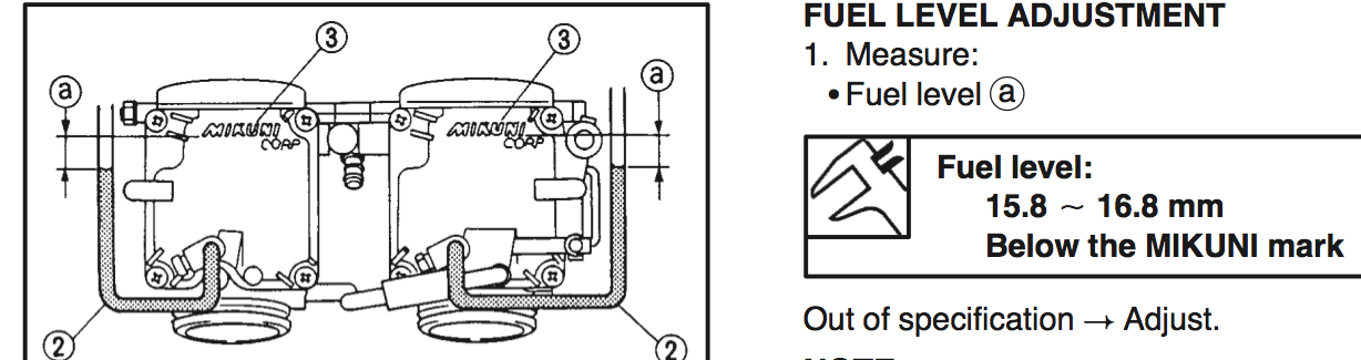

    When I was trying to find out what was causing the carburation problems, I looked at loads of information on these Mikuni BDST38 carbs; because I recalled having some issues with a Kawasaki engine that was doing similar things (it was the ZZR1100 engine in our outfit).
    I knew the float / fuel level would partly control the primary circuit, so if the level was wrong it would cause slow running issues and/or overflowing. If the fuel level is too low the pilot screw has to be turned out more and vice versa.
    I remember when I stripped the SS carbs the first time, that the float levels were 9.5mm and 12.5mm which were obviously less than the 14mm. Anyway I set them to 14mm - but that is not the actual fuel level until the carb is the right way up.
    So once I got some non-faulty float assemblies, I set the carbs in a vice at the right angle and I spotted a line on the outside of the float bowls which seemed first of all to be a casting fraze, but I wasn't sure.
    I eventually saw the same carbs are fitted to TDM Yamahas. I also found a diagram of how to check the fuel level on them.
    So I did the same with mine in the vice - a few times as it happens, because they were way out of the Yamaha spec.
    I reset the float heights at 13mm and then re-checked and the fuel level was higher but not enough - I couldn't be sure about the Yam check diagram, so I set the floats at 12.5mm and the level was more or less correct with the Yam diagram ---- and the line on the float bowl.
    I should really have set the floats at 12mm but as it was running OK at 3.5 - 4 turns out on the pilot screw; I couldn't be bothered to take the carbs off again.
  10. So you set the level according to your own experimentation plus some clues from the TDM installation and a cast-in mark on a he outside of the bowls, wow, well done.
    And the effect???
    BTW, I ended up with a TDM pilot screw in one of my Mikunis.
    One of mine was seized, so I managed to gently drill it out and went to see if I could order one from a local shop.
    I couldn’t but they had the s/h TDM one.
    Luckily, although it was pretty different, the different variations were all greater, so I was able to get it pretty damned close by sticking it in a drill chuck and ‘turning’ it down to size.
