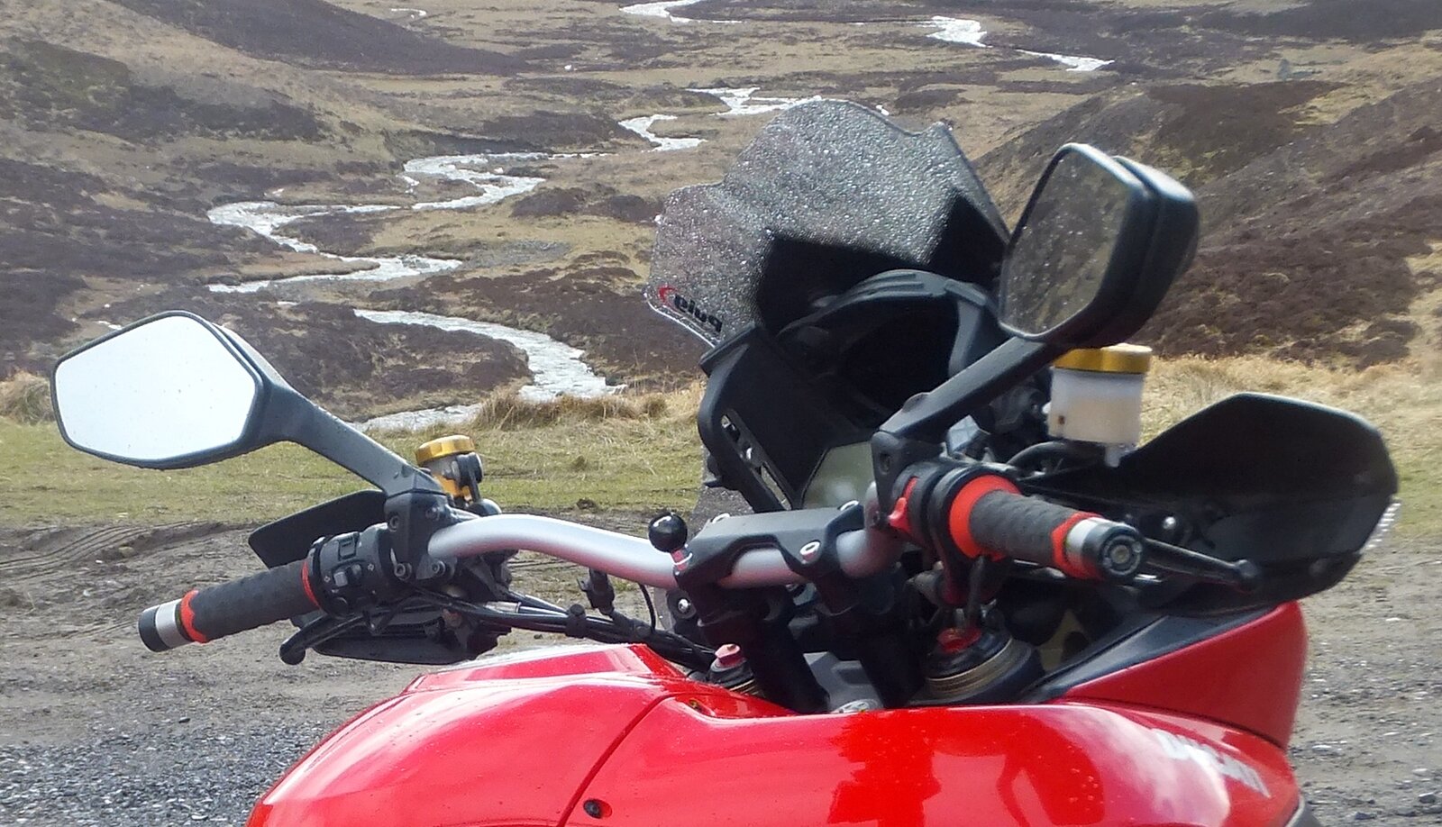

  10. I fitted a very similar set of risers to my previous MTS1200. My issue wasn't that I needed the bars higher, I wanted them flatter and closer to me but that meant the bars hit the top of the tank on full lock. 20mm risers gave them sufficient clearance. Not very obvious in this picture.
