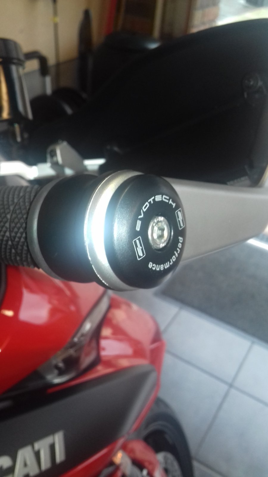

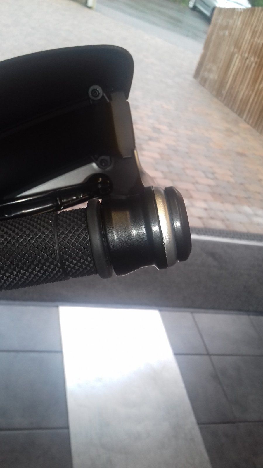

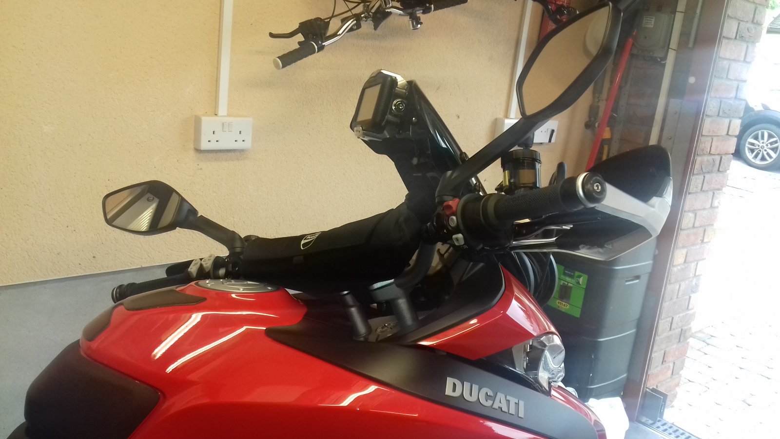

  6. I can CONFIRM the Enduro Bar Ends do fit on the Multi S 2015 to 2017.
    They basically just swap places with the standard metal pieces each side of the hand guard and reuse the brass expanding wedge of the old Bar End.
    As above these parts are heavier (Steel) than the standard (Aluminium) pieces and also interlock better to the bar end and each other than the standard bar Ends.
    Will post pictures later.

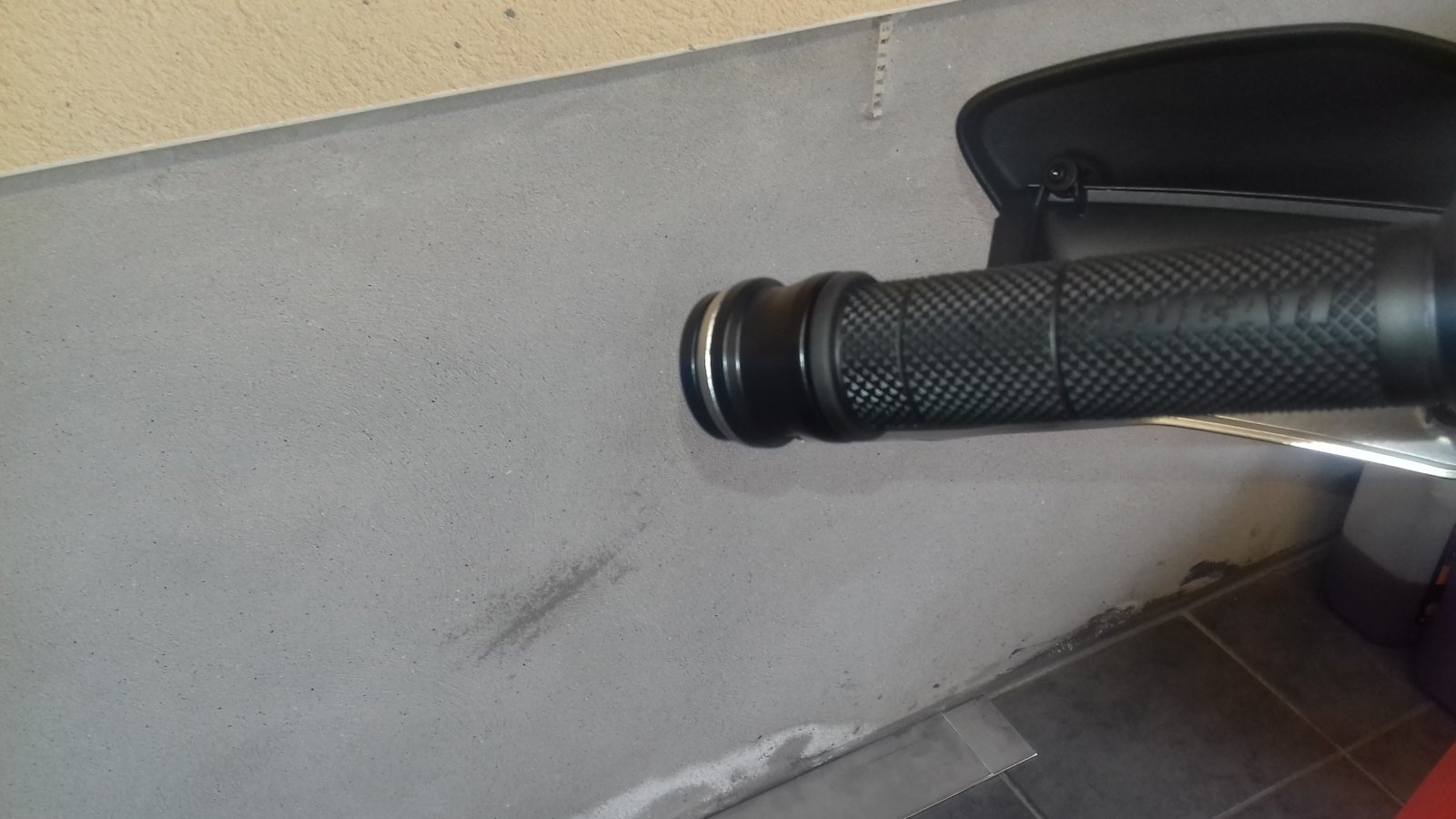

  9. Photos as Promised
    2017-06-02 09.38.45.jpg 2017-06-02 09.38.45.jpg 2017-06-02 09.38.56.jpg 2017-06-02 09.39.53.jpg 2017-06-02 09.40.08.jpg

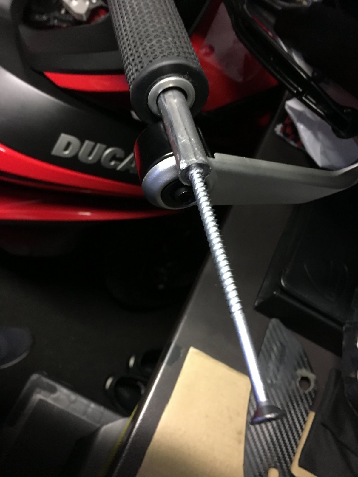

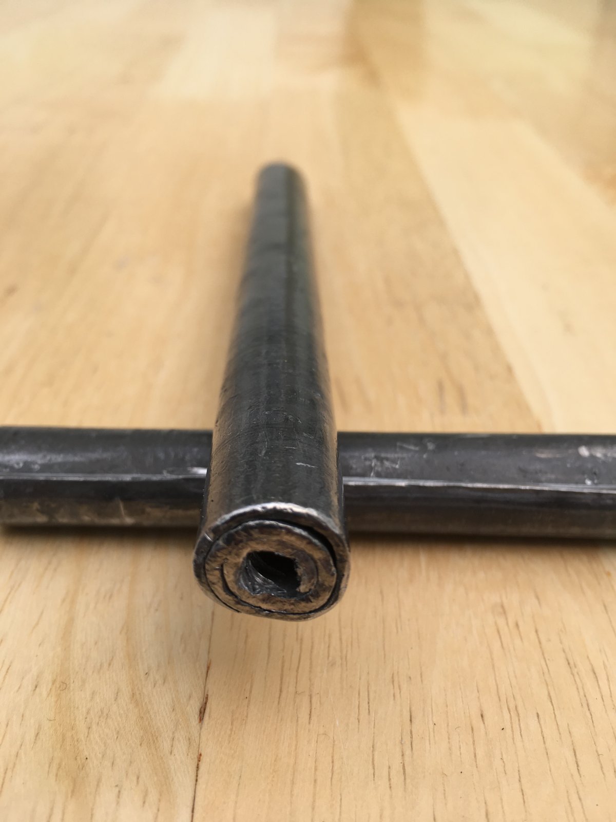

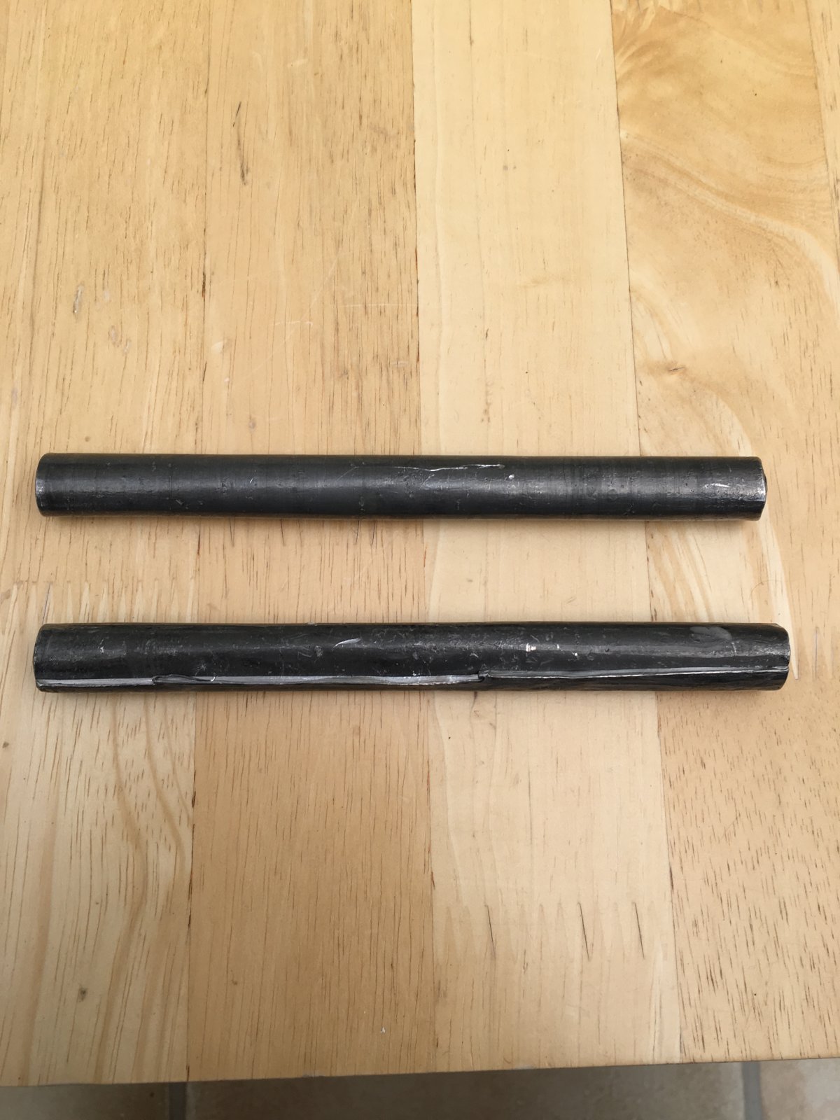

  15. I was suffering pins and needles/ numbness in both hands so got some lead off a pal and made some weights. I stuck a rod down the bar to see if anything would stop and there is. The weights they are 150mm long by about 10mm diameter and have been out 3 times now and yesterday did 300+ miles and hands were great :upyeah:If you want to take them out i just use a long screw

    On my 2015 DVT - I did similar - I made a lead plug using 2 bolts, some heatshrink and lead shot.
    I did the same on this one (2017)
    It helped but did not completely cure the issue.
    Now the heavier bar ends are there the issue is gone completely.
    Lead sheet rolled is a good way - probably heavier than shot and also does not need to be contained in heat shrink to stop it getting in swiches.
