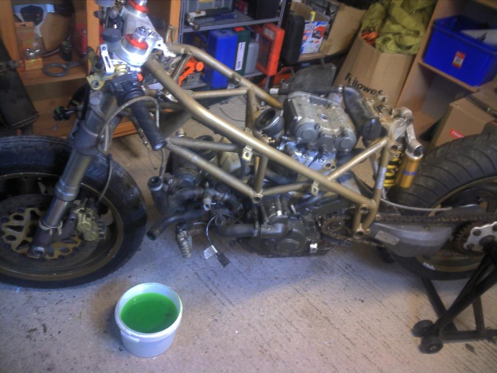

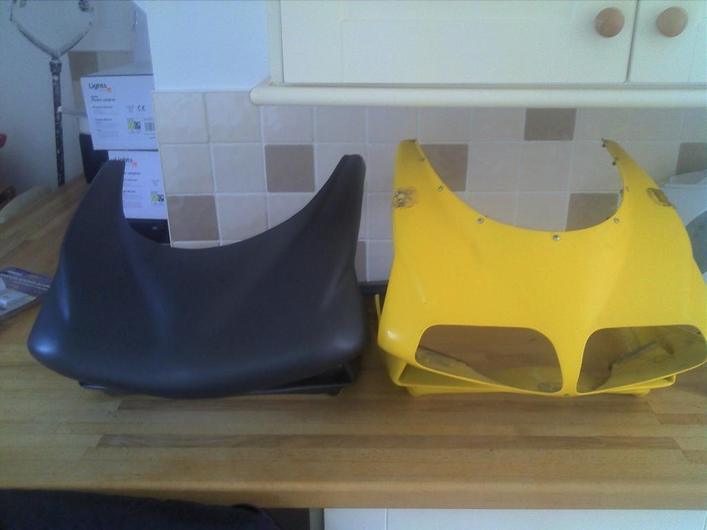

  1. Not for me - I prefer the plain look (Although I do love the look of magnesium at the moment!) So it really will be exactly as that pictured above just without headlights! Cannot wait - It will be a slow build though I believe!
  2. A bit more progress - Loom, radiator, and exhaust gone! Not far off dropping the engine...

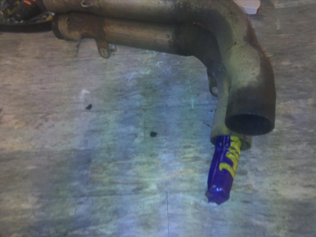

    And when removing the exhaust a bloody Twirl dropped out of the midpipe! No idea how long it has been in there, but a 5er to anyone who comes round and eats it :upyeah:
  3. is that what gave it that throaty rattle??
  4. Twirl in the exhaust - essential mod!! :biggrin:
  5. I thought it was the pistons that were made of chocolate...:frown:
  6. no Nelson, just the rockers...
