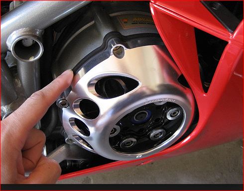

  5. basket.JPG Beautiful, heavy duty, invokes, Ferrari wheels? crash resistant Speedymoto
    http://motowheels.com/i-13164141-ev...h900e-m900-1000-s2r-s4r-mts1000-sc-st-ss.html
    similar spines slotted through to OD helps remove dust??
    protected springs vented pressure plates, help reduce dust buildup
    https://www.google.com.au/search?q=speedy+moto+clutch+pressure+plates&client=firefox-b&dcr=0&tbm=isch&imgil=22KekqILS4mtcM%3A%3BwoJpCqoHThtOlM%3Bhttps%253A%252F%252Fwww.baysideperformance.ca%252Findex.php%253Fmain_page%25253Dproduct_info%252526products_id%25253D9691&source=iu&pf=m&fir=22KekqILS4mtcM%3A%2CwoJpCqoHThtOlM%2C_&usg=__0Klpi_uYPpgMK8tpgYzvJEovNxE=&biw=1920&bih=889&ved=0ahUKEwiNm8j2673WAhULWLwKHeccCjEQyjcIQA&ei=tqfHWY3oBIuw8QXnuaiIAw#imgrc=22KekqILS4mtcM:
    https://www.oppracing.com/category/1659-stm-stm-dry-slipper-clutch/
    48 splines twice the wear area 1/2 the rate of wear
