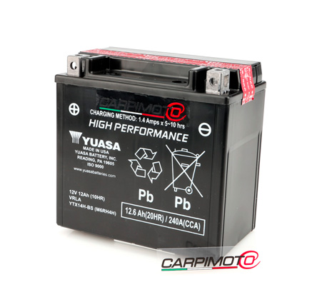

  1. Cheers paul that helps on the sherpa as they are famously a slow starter andno kickstart
  2. They do but it’s only a 6.3Ah battery in that size. Andy
  3. That’s currently what mine is so I’m looking for better than 6.3 ah?
  4. Capacity and cold crank amps are different qualities of a battery... :bucktooth::upyeah:
    For a large Twin I'd go for the biggest number on the CCA, assuming they are measuring the same; as it would give the fastest spin up. :motorcycleduc::heart::heart::motorcycleduc:
    The capacity would give you more goes at starting. :broken_heart::motorcycleduc:
    :eyes:
    Another most important quality is that it can be secured (it fits) and that also that the + and - terminals are in the right place (not swapped or on the other side).
  5. You are restricted by the size of your battery box. If you have more space, something like a YT12B-BS will give you a bigger capacity but you would need to check that your generator has enough output to keep up with the discharging whilst riding. Andy
  6. It has also just occurred to me that if you change the model of battery, your leads need to match the new terminals which are not always the same orientation. Andy
  7. IMHO the generator will be able to cope with any sized Lead Acid that would fit the space, as the draw would be proportional to the voltage of the battery.
    The amount of draw on the generator would be the same for any lead acid battery, for the same state of charge.
    I already said that in post 24... ;)
  8. Do you know what the CCA is on that one Andy?
  9. Yes, 100, according to the specification quoted on the Halfords web site battery page. Andy
  10. Cool thank you everyone

  12. I’m restricted on battery box size definitely
  13. Not got a recommendation but i'd steer clear of the motobatt stuff. Bloody terminals aren't fixed to the battery, more stuff to vibrate loose.
  14. Agreed... but I do loctite mine... through bitter experience.
  15. Finally ordered from Halfords first use of discount card and this is my second card bit slack yes
  16. I've had good results with Motobatt, admittedly I like the fact we can buy a battery with '4' terminals, so we can swap sides for use with other bikes...(my KTM is +ve on the left) the bolts have serrated teeth to grip the terminals.
    The other thing to consider is weight, as it can be quite a high percentage of the bike weight...If you up-rate the starter cables you could potentially go with a lower CCA - and hence a lower weight battery. I did this with my superlight.

  19. I swapped the standard Yuasa YB16AL-A2 - weight with acid: 5.3 Kg
    with a Motobatt MBTZ14S - weight: 3.4 Kg with no issues on my 900 superlight (With uprated cables throughout the bike)
    Plus the smaller form factor leaves a nice space for the digitech ignition.
    I figure losing 2kg with no effort at all...not even a pre-ride dump..is worth it!
    Cheers!
    Grant
  20. Halfords don't stock the' high performance' in that size, it's just a standard Yuasa - maybe they don't do one at all...
