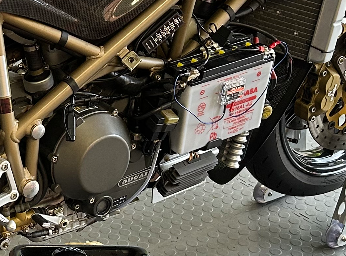

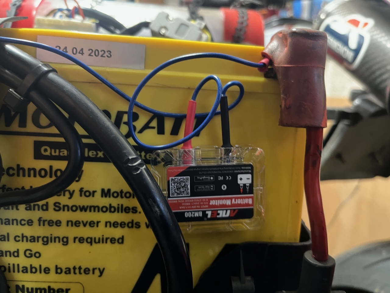

    The unit itself is very small and light and is simply connected to the battery and stuck onto it with double-sided tape (stuck on allows it to monitor the temperature), here's a picture of it stuck to my Monster's battery;

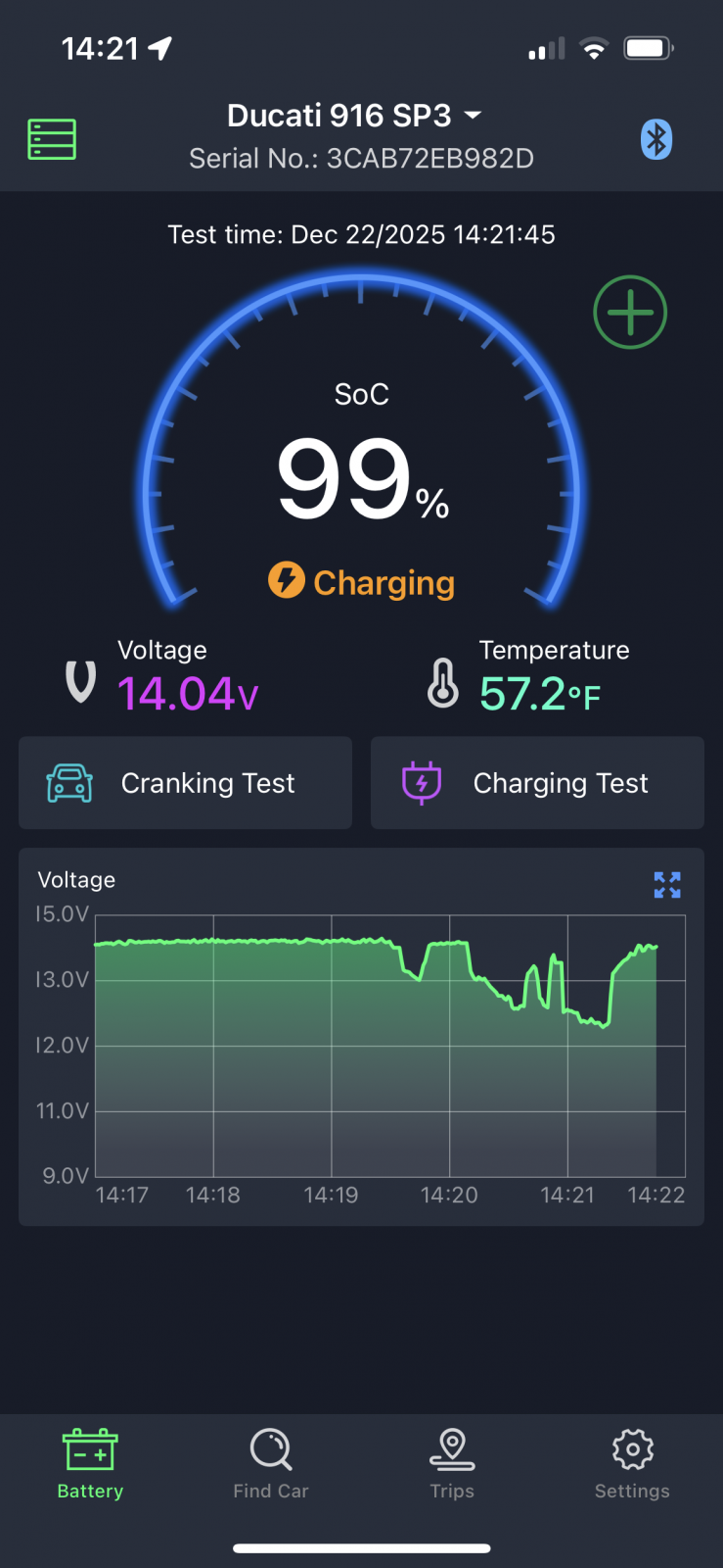

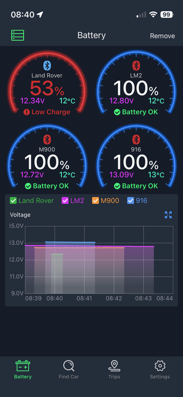

    And here's a screenshot of the 4 batteries health from my phone;

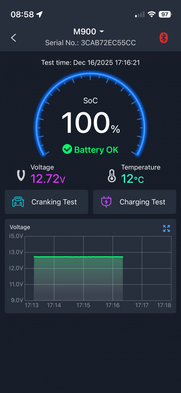

    And a single battery screen;
    As you can see, the bike batteries are currently fully charged the Land Rover not so much but it's actually currently attached to an old battery that I'm using just for testing electrics and I have a new one to go once finished.

    Actually, at the moment the one on my 916 is plugged into the charging/12v port on a lead as, where the bike is sitting I can't get the fairing off without moving loads of stuff and I can't be arsed to do it yet.
  7. Can leave it connected whilst charging, in fact it shows as 'charging' if you do.
