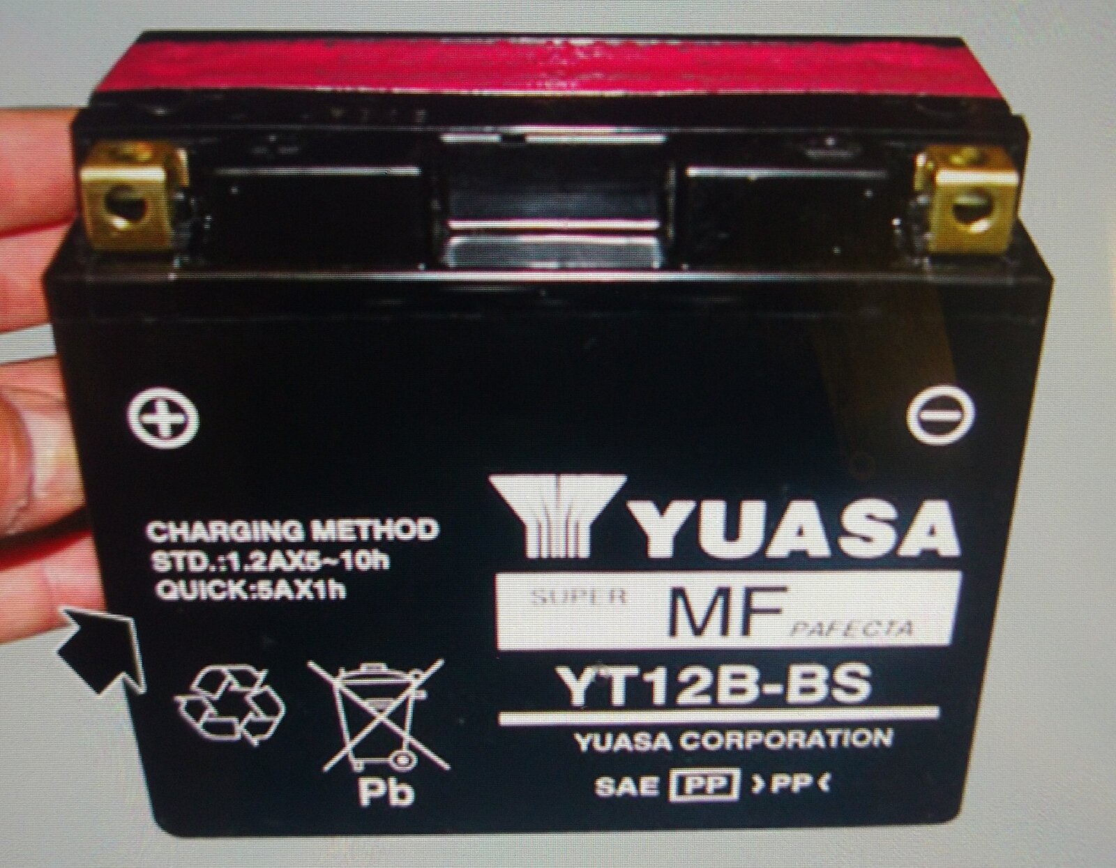

  1. Does anyone know the size, physical and electrical of the battery for a 2009 Monster 1100S please?
    I think I may need to get a new battery and I don’t want to have to strip the plastics off and lift the tank just to see it & measure it. I don’t mind doing that obviously when I replace it but it’s a chore just to see what I need to order.
    I thought I had a picture from when it was all stripped down and serviced earlier this year but sadly no:(
    I want the highest CCA I can get to fit in the tiny space under the tank.
    Mind you, I could always go lithium :astonished::joy:

  2. Think it's one of these?
    YT12B
    -BS Battery Specifications:
    Dimensions : (H) 5.12" x (L) 5.91" (W) 2.72" Weight: 8.46 lbs. CCA: 210. Volts: 12V.
  3. Yuasa YT12B-BS 12V 10Ah Motorbike Battery for Motorcycles and Quad bikes
    Brand: Yuasa
    Voltage : 12 V
    Capacity : 10 Ah
    Cold start performance: 180 EN
    Dimensions : 150mm x 69mm x 130mm
    Weight (filled) : 4.1kg
    Maximum charge rate: 1 Amp
    Terminal layout: Left: + Right: - (With the terminals on the edge nearest to you)
    Type : AGM battery
    YT12B-BS Motorbike Battery
    Yuasa LF Liquifix Gel batteries feature the latest AGM (Absorbent Glass Mat) technology.
    Benefits include increased lifespan, and electrical performance, higher vibration resistance, and 100% leak and spill proof.

  4. You need to break that up with some pictures :bucktooth::D
  5. Thank you Stu @Exige as always a source of useful information:upyeah:.
    On this occasion I will overlook the forum rule, as highlighted by Mr @Harry Bell of Scotisshland, of pictures in long posts due to the usefulness of the post :upyeah:
    cheers mate:upyeah:
  6. :thinkingface::thinkingface:
  7. Here's a picture too just in case anyone need it for a thread or summat :D IMG_20200724_090956.jpg
    • Thanks Thanks x 2
