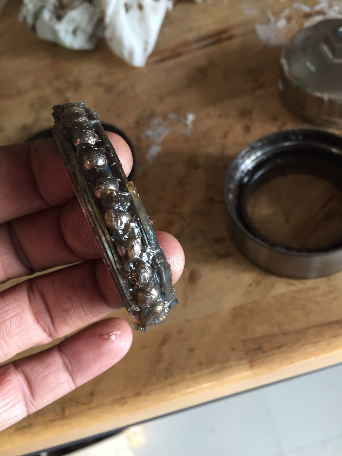

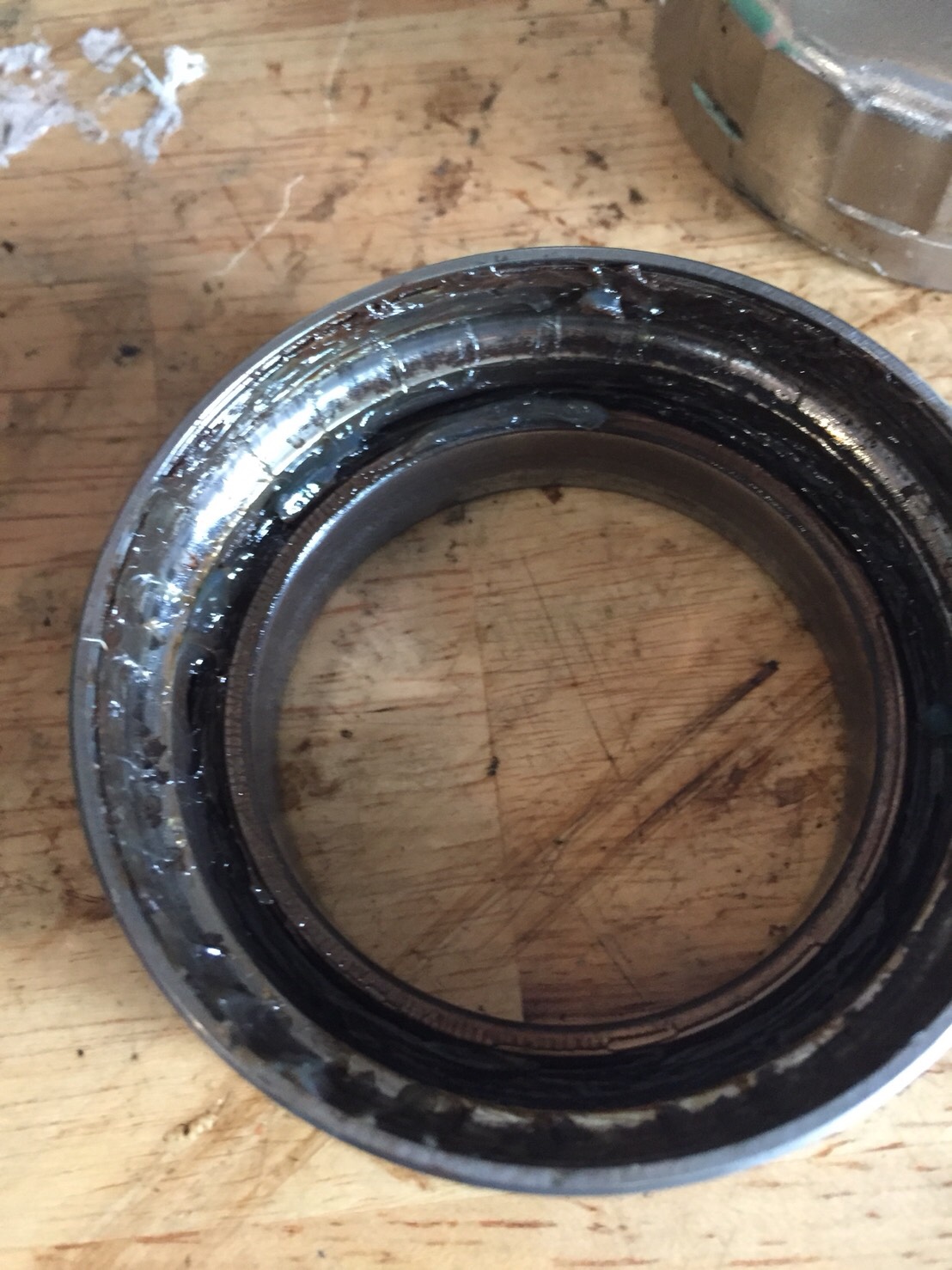

  1. Hello im CNX ! Anyone ever change the ball bearing at the rear wheel hub Ducati Diavel Black ? What is the right dimension and where I can get it ? Ducati only show the whole wheel hub at drawings and sell it only complete for a price around 600 pound which I think is a little overrated since it's only the bearing that is worn

  3. Can you remove the bearing and read the code of the bearing?

  5. Can't see a code ...but the size is maybe 72-24-51

  7. Remove the bearing and take it to a bearing specialist,they will get you what you need,there should be a code on it somewhere,mebay Ducati fit them so that you can't read the code,then they rip you off for a very expensive "Ducati" part!
  8. Yes, they say it is a "non-serviceable item" and ask you for £480 for a new hub assembly.

  12. Found this info:
    There is a roller bearing on the LHS, which could use a lube after - say - 30,000 miles. This bearing is readily available for not too much; its SKF number is RNA 4910.2RS.
    The other is a bit harder.. It is a double-row bearing, with one outer case and two inners. It appears to be a 'special', made to spec for Ducati. It cost me a lot - I forget exactly, but I seem to remember over $150.
    The tough part is that SKF will only supply them in batches of 25.. Its SKF part number is BAH-0175.
  13. Is this the one?
    https://www.123bearing.co.uk/bearing-BAH0175-SKF.php
  14. 1 Nadellager SKF RNA 4910 2RS
    1 Doppelreihiges Kugellager SKF BAH-175
    1 Innenring Ducati 88110541A

  15. I only had 25000 km at the clock when find out, think it's a combination of bad construction / seals and high pressure washing, anyway been dismounted cleaned ( as it was full of shit ) mounted, but have a very little veil in the bed ..... Done 2000 km after at curvy mountain roads, but not really happy before it changed ! Maybe if I had a spare bike the problem would be less ( smile )
    Hmmmm I just see now it's the needle roller bearing which I also can get here ! It's the other bearing which is single row
  18. Ok did try the other number you send ....seem like I got into something, but mine is single row roller ring. download the app from SKF but still a little difficult, I did send them a mail
