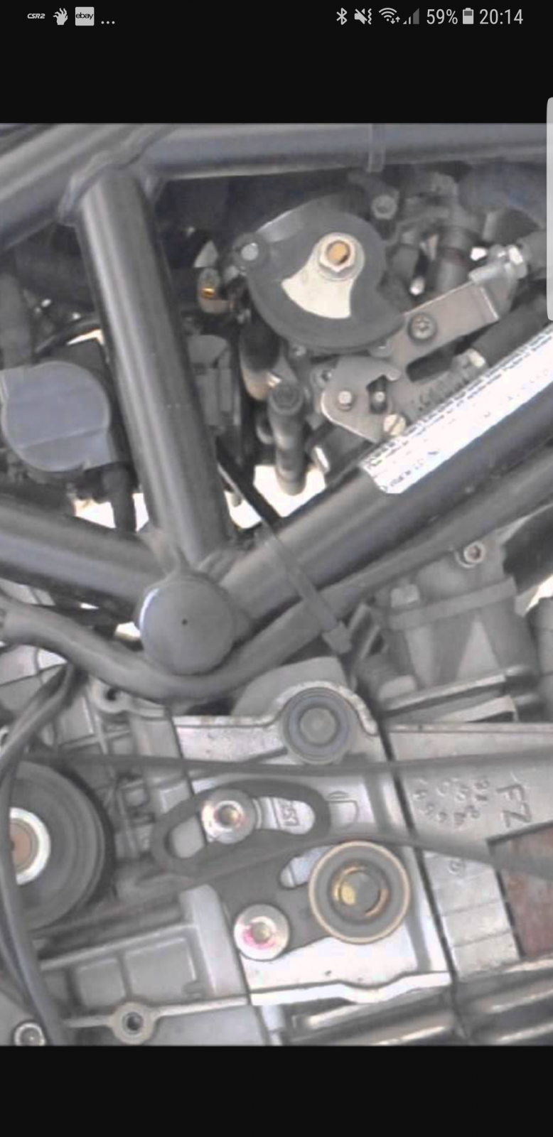

  3. Can someone post a pic of 900 tensioner arrangement? I'm not convinced I have the correct ones. Belts definitely slack on full adjustment. I do not believe this is due to lack of base gaskets alone.

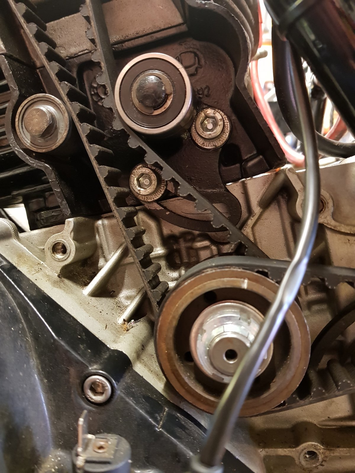

  5. Mine look like they don't have enough 'throw' 20170711_190838.jpg look how close the bearings are to the pivot point. There's never gonna be much adjustment and Google reveals different looking adjusters with a longer throw. If that makes sense.
  6. That slot looks pretty long...

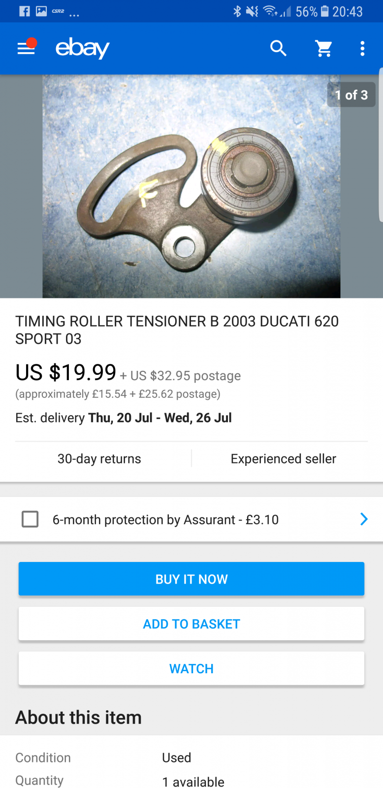

  7. I may have the answer. My cases are actually ST2 cases. They are the most part the same as the 900SS. There's subtle differences and I am wondering if this is why I now have this issue. I reckon if I can change to these longer arm tensioner it would fix my problem. Screenshot_20170711-204352.png

  12. ST2 cases are basically the same, they use the same tensioners. I had an ST2 engine along with the 900 (as a cam donor) and saw that most parts other than heads & cylinders were the same. The belt tensioners and covers were the same.
    This is what mine looks like;
    The tensioners are near the end of the slots but still some adjustment left.

    I have ordered some longer arm adjusters, will report back when they arrive.
