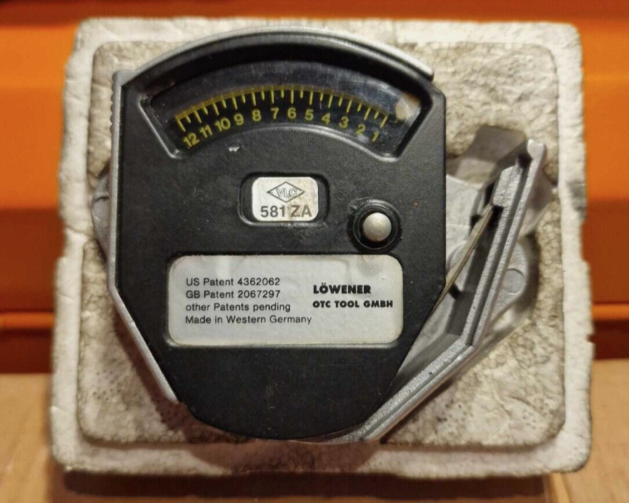

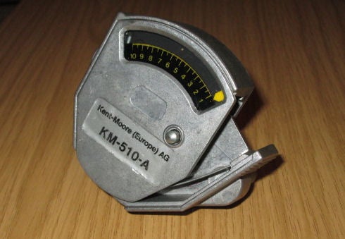

  1. Would anyone know whether these two belt tensioning tools are the same in terms of scale used and readings generated?
    I notice that the scale on the Löwener tool (being the official recommended tool) goes up to a scale of twelve, whereas on the Kent Moore tool up to a lower scale of ten. Uncertain whether the scale used on both is the same though (trust that the measuring is/should be in ft. lbs if that's the case). Both tools are/appear to be a spitting image of one another.
    Fully aware that neither of these where in fact used (or relied upon) that much for measuring belt tension on Ducati's historically, as well as of the fact that technology has long made them ever more redundant with the modern hertz measuring applications.
    For the sake of completion and should my research prove correct, the patent for this (discontinued) service tool should now be in the hands of Bosch (who took over SPX's specialty service tools segment, with SPX themselves having taken over Löwener OTC and possibly Kent-Moore earlier on).

  7. The 'stretta motors were the first to use the Hz tensioning method. There was no figures for using that tool. Iirc, I don't think it fits in between the cam pulleys where it was used on the quattro engines. There were a couple of other bikes it was spec'd, 2V's i think, where it was used on the longer run of the belts, but in reality, if the engine was in the frame it wouldn't fit.
    It's a deflection gauge. Nothing more. It was a Ford tool. Chris Kelly mod'd it with some very thin walled sleeves over the rollers to make it work in the Ducati arena, copying the factory tool.
    It's easy to check.... the setting is 2.5 on the readout. That represents a deflection of 5mm on the belt. Set the tension with the gauge and then check deflection by pushing the belt down with a steel rule behind it.
    I wouldn't use that tool though on anything other than Desmoquattro motors. It's placed between the two cam pulleys in use with the relevant cylinder at TDC.

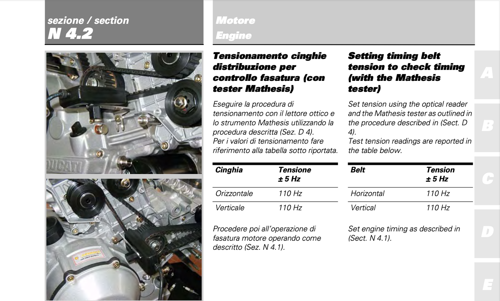

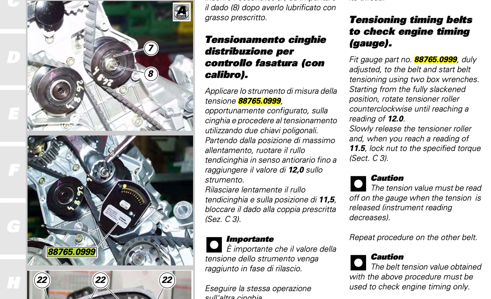

  12. @nelly these are the relevant service manual excerpts for the 998 engine illustrating the use of the belt tensioner tool on the testastretta engine.
    The 110 (+/- 5) hertz readings are provided in the same manual as a reference for the Mathesis tool in checking that the belt tensioning performed with the belt tensioner tool are/have been made within the factory tension values.
    It seems that the view taken by the factory for the testastretta engines (at least up to 2008) is that the belt tension tool and the hertz method are not mutually exclusive but complimentary of one another (notwithstanding that in practice the belt tension tool was very rarely used, if at all).

  13. The manuals were a little misleading. The figures never correlated and unless the motor was out of the frame, you couldn’t use the deflection gauge due to access issues. The figure of 11.5 related to tension required when checking timing. The actual working tension was lower.
    As mentioned above, I wouldn’t use the deflection gauge on anything other than the Desmoquattro motors.

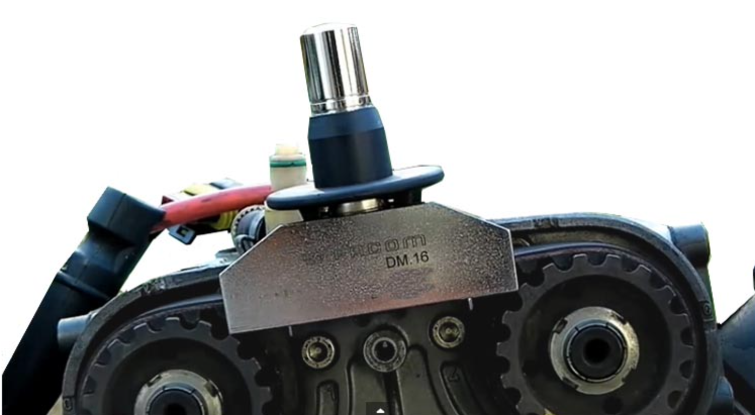

  19. Don't know anymore,was when i did the first belt change myself and the reading was really all over the place.
    With the facom tool i just increase the tension until the piston off the tool come at a line and done.
    You just can't go wrong.
    Henk!!!

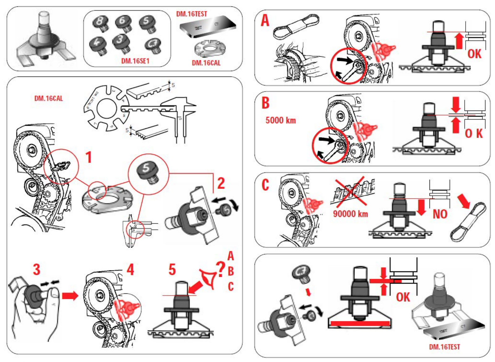

  20. @henk trust you are referring to the Facom DM 16 tool below, which also much easy to use and bang on consistent every time.
