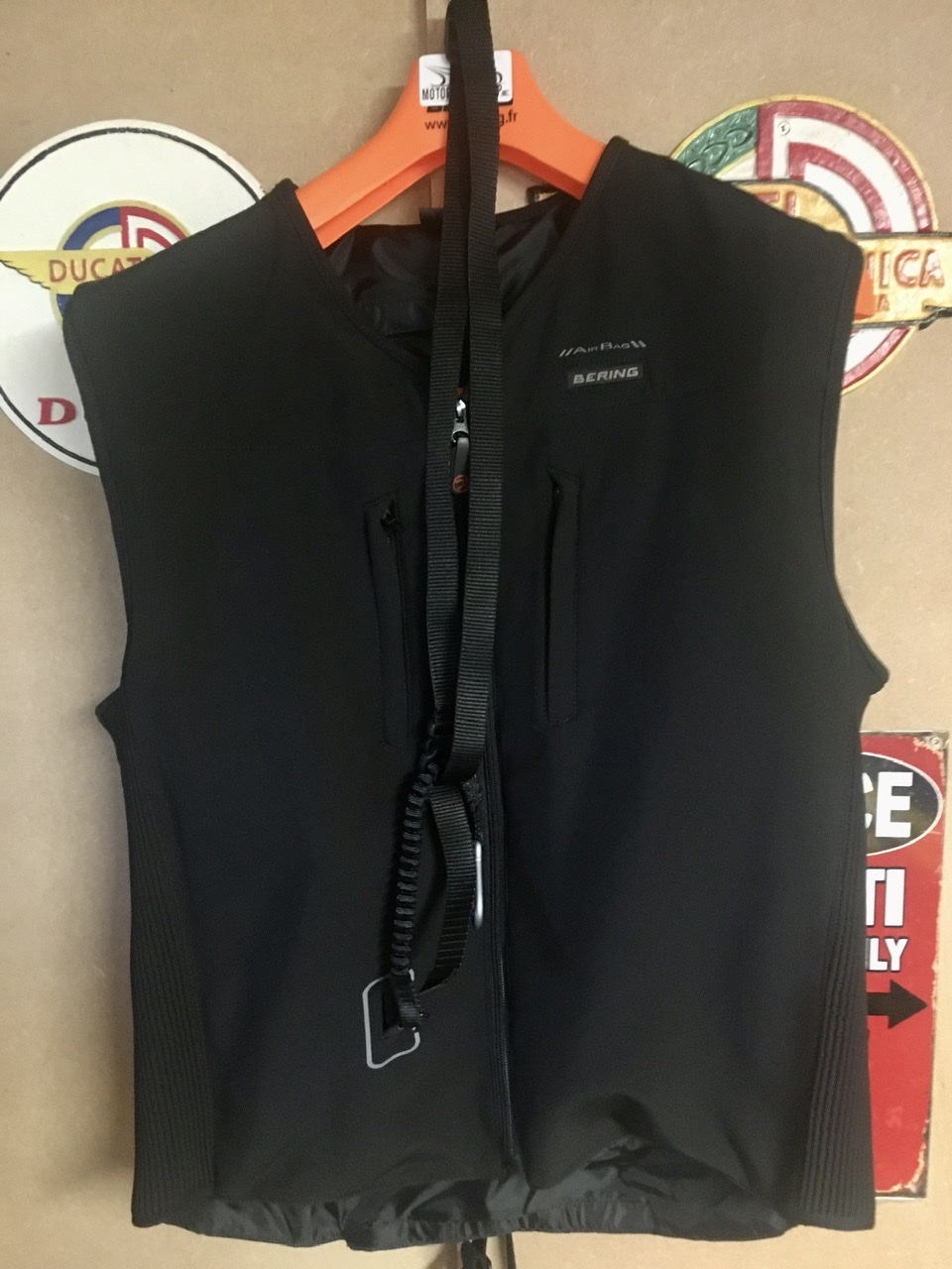

    The Bering comes in just 2 sizes, S/M/L and XL/XXL/XXXL, this is due to the expandable elasticated gusset stitched into either side. Makes sizing a whole lot easier and means it adapts to whatever you have underneath, whether it’s summer or bulkier winter gear.
    I’m 44-46” chest so got the larger version. I have to admit it felt snug when trying it on in the shop over my t-shirt & hoody, so when I went out yesterday and put it on over my 3 layers and big thick Dainese Goretex winter jacket with thermal liner and built in armour I was expecting it to be a struggle to do up the zip, but no:). It stretched, zipped up easily, and didn’t at all feel constrictive. I didn’t even remove the back protector from my Dainese jacket, coz it was a faff and I wanted to see if the vest would still fit.

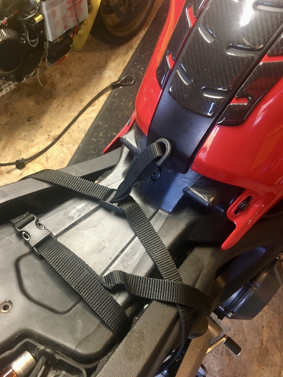

    it comes with a strap with a D-ring attached, which took about 5 mins to adjust and fit under the seat and around the frame. The D-ring protrudes between the seat and tank and you attach the rip-cord trigger to that.
    Oh, and it’s fully washable, just remove the airbag and back protector & bung the vest in the machine.

  2. A word of caution, not sure where I read it but the plastic D ring for attaching the airbag trigger to the bike is a potential weak point. Someone had an off and the air bag didn’t inflate. On close inspection, the D ring had failed. It might have been posted on here or on the TVAM FB page so I’ll try and find a link. Andy
    • Useful Useful x 2
  3. Yep, the D-ring is plastic, same plastic as is used for the buckle type fasteners on many bits of kit. Just to be on the safe side I might just add a metal one, it’ll be easy enough to do. I’ll tape it up with electrical tape as well to prevent any scratches on the tank.

  8. A bit of a thread resurrection but I pointed someone else to this thread and then re-read the thread and further to Andy’s comment I can advise that Bering actually issued an alert for all purchasers to contact them or the supplying dealer to receive a replacement strap with a metal D-ring and a new lanyard as well. A 5 minute fix:upyeah:
