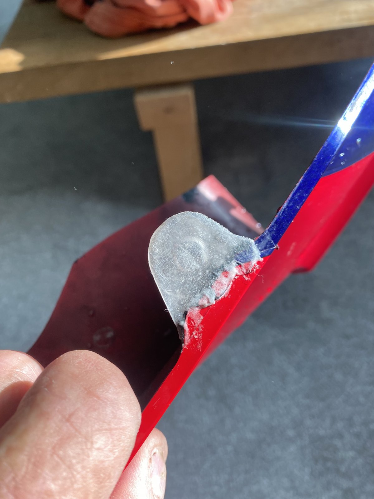

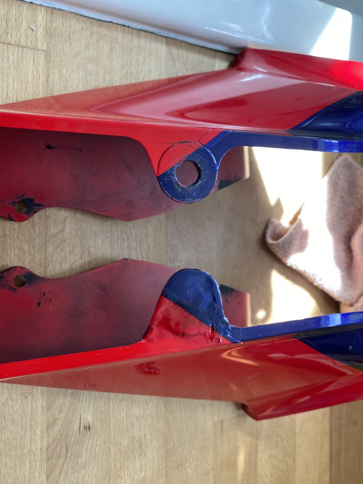

  1. Fairing lugs & tabs are always fragile at best, got one snapped-off. What really works for gluing them back on? I remember reading somewhere about a powder system with an activator that goes off in seconds, but can't find it. Any ideas?
