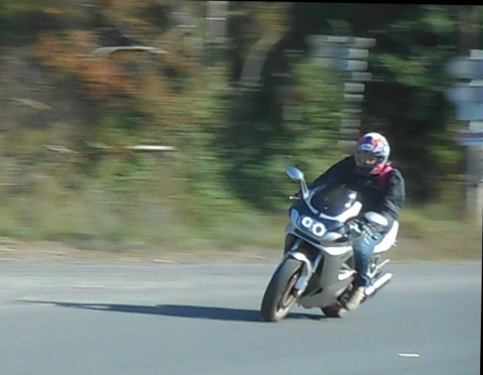

  2. I have the ultimate headlight on my wifes ST2. It has a bi-xenon projector with 35 watt HID kit in place of the standard dip projector (provides dip and main beam). It also has two angel eye running lights which are on when the engine is running and the headlights are off. It has another spot projector in the main beam place with a 20 watt LED to give a headlight flasher function.
    The bike is very visible in the day with the angel eyes, and the night vision is fantastic on both main and dip beams.

    The wifes ST2 now has 2 angel eye day running lights, a HID dip and main (35watt) in the dip side and a 20watt LED in the mainbeam side just to retain the flash function when the lights are not switched on.
    Not a fantastic picture but it shows her on the bike with the angel eyes fitted.

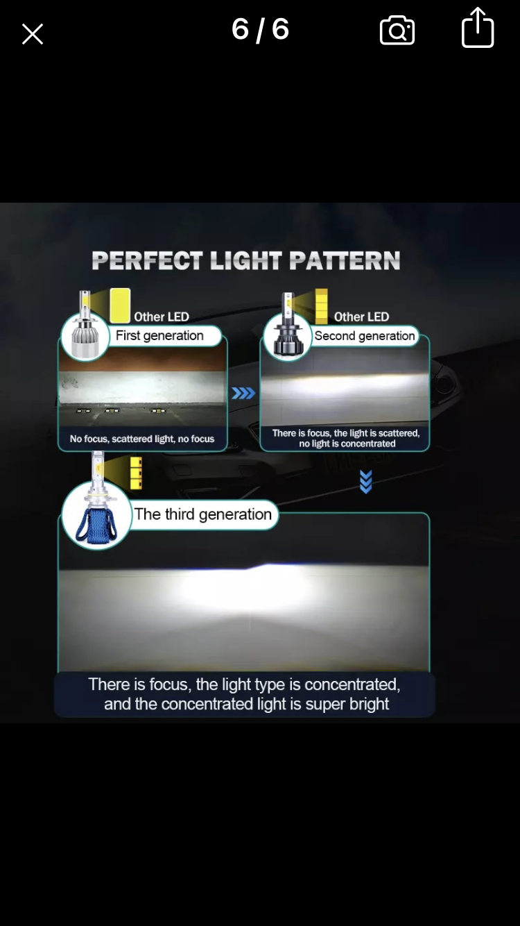

  19. LHD 7” H4 reflector headlight using a GEN3 Philips conversion made specifically to convert Halogen to LED. No cooling fans to interfere with wiring as heat efficiency heat sinks are used. Note perfect beam pattern, zero bleed and crisp cut-off to avoid blinding on-coming traffic… ‍♂️
