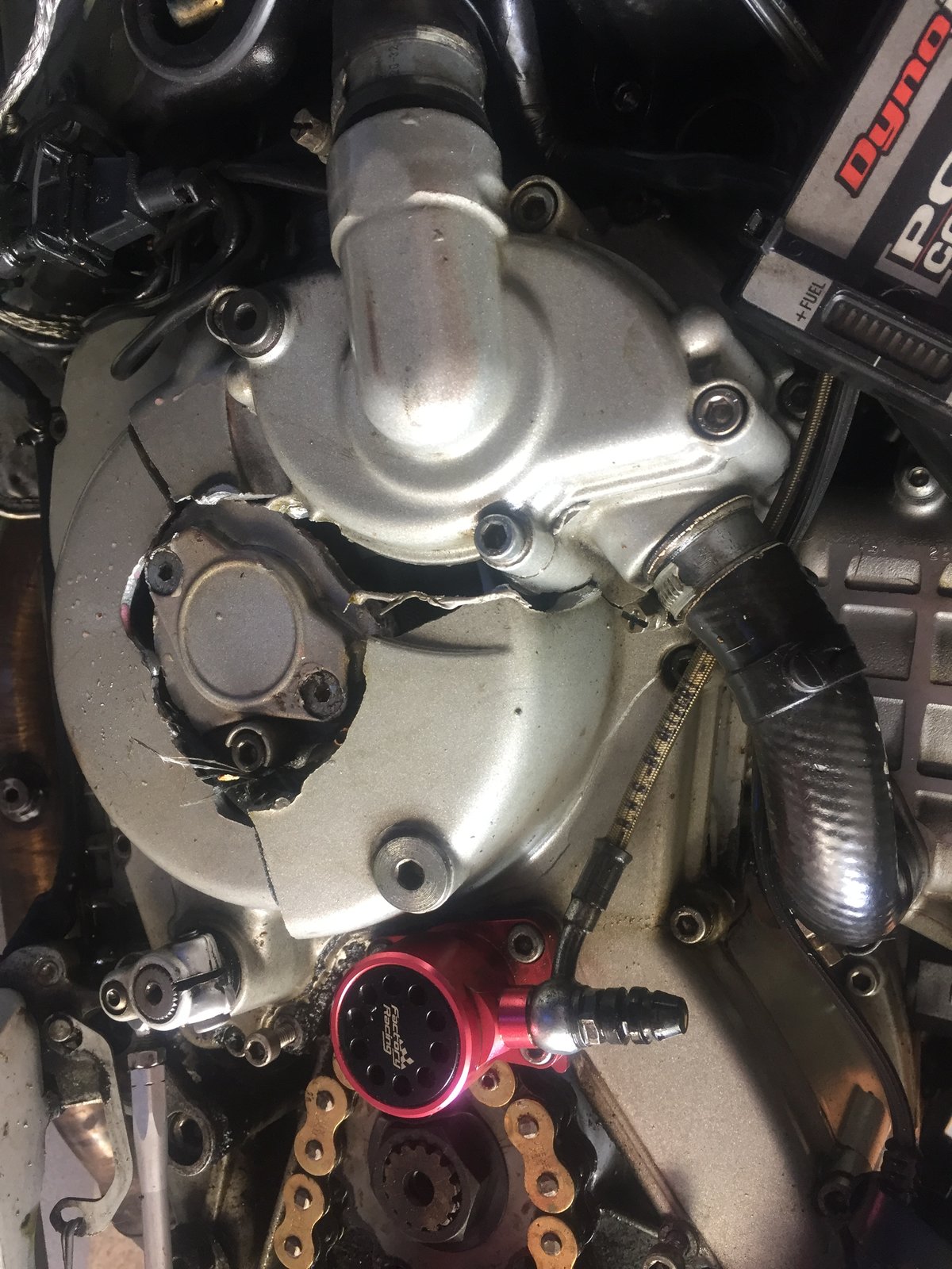

  1. I'd guess as birdie said. Mains failing causing stress to the cover support bearing.
    Mine broke the bearing up rather than cracking the casing.

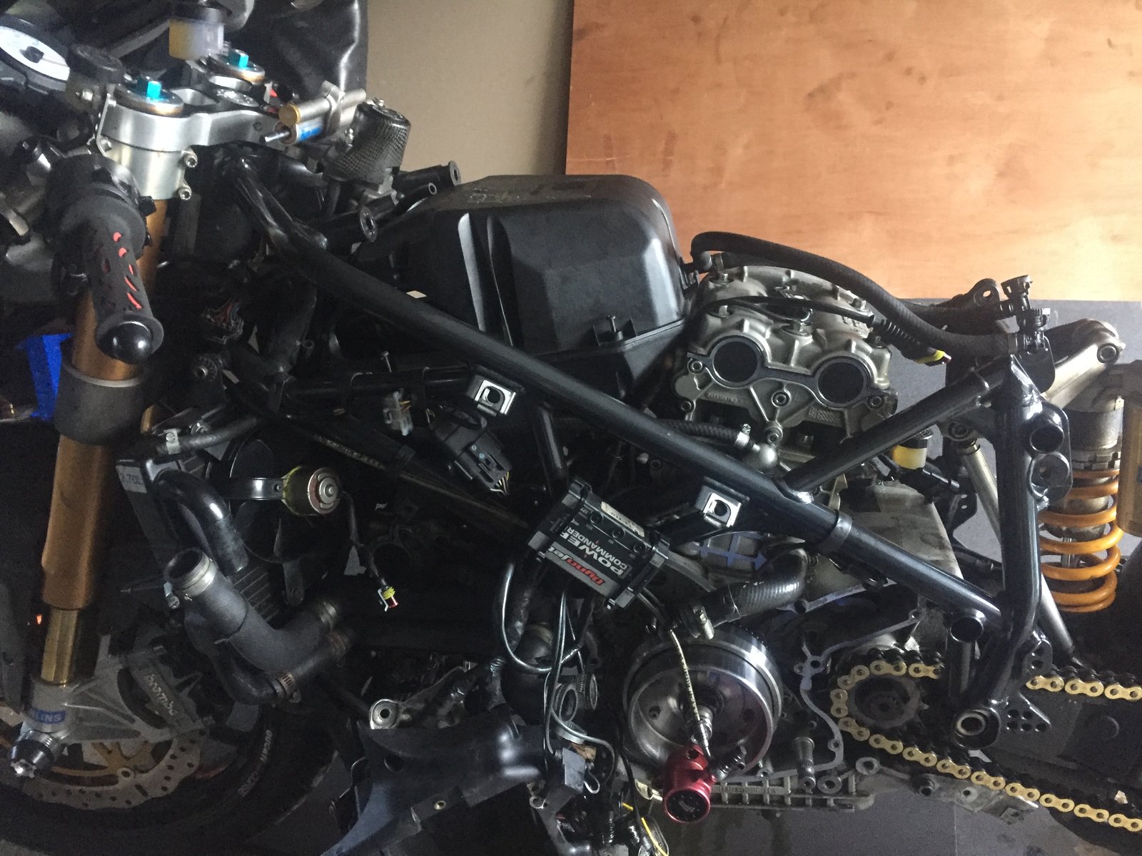

    Well this is where we are today. Spent the afternoon stripping it down. Major play in the shaft and the end bearing is trashed, just the inner race left. Stator destroyed, outer casing and the water pump housing. Water pump ok fwiw..
    As an aside. Didn't realise how grubby the bike had got and so I've starting boxing bits for refurb, painting and replacement.
    I'm going to get the engine redone as is. Everything else is going to get overhauled. All the fairings painted to original spec. I've a couple of scratches on the frame that I should be able to get touched in. Front and rear suspension overhauled as well and engine painted to original. Same with the headlamp assembly possibly.

  18. Another thing I've noticed is how easy it is to strip. Mostly Allen keys and nothing really tricky apart from the exhaust at the manifold.
