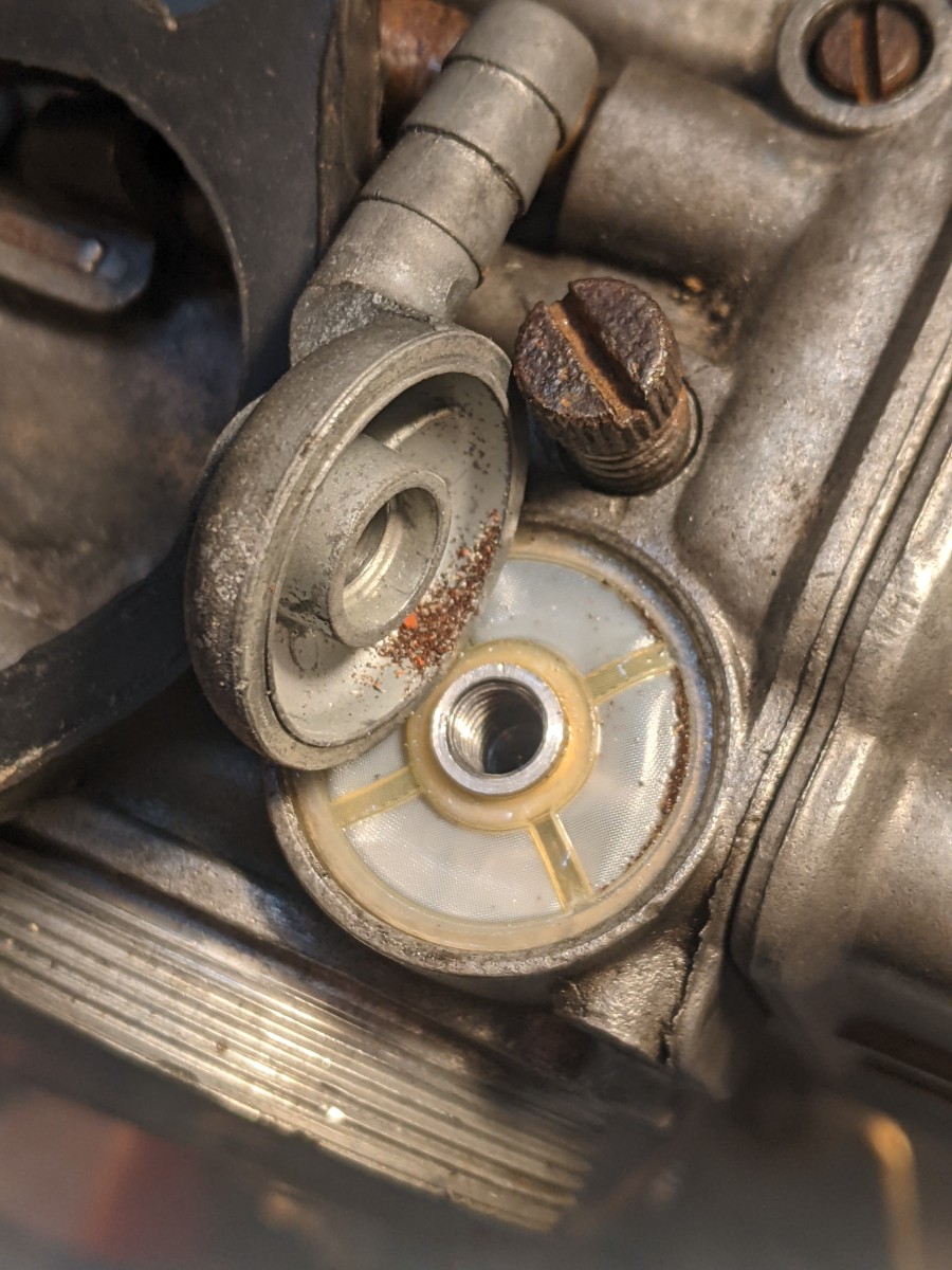

  10. Hmmm.... progress. What had bugged me is the hard starting/spitting came on sort of suddenly and I supposed it might have been the colder weather. But what about a blocked jet or some such? so I removed and cleaned out the carb and there was plenty of gravel in the inlet filter plus plenty of finer stuff in the bowl but no obvious pilot jet blockage.
    So in a non scientific experiment I tried again this morning, without adjusting the mixture, & he fired up pretty much on the first spin. There was still an occasional spit so I adjusted the mixture as per Paddy's recommendation and all was good. I reckon the idle jet is just on the limit of leanness.
    Looking at my scrabbled notes from the rebuild it looks like it originally had 65s but I changed them for 60s when adjusting the carbs because of richness. Now I never throw anything away but can I find them amongst all the other stuff I never throw away... :(
  11. With that sort of debris in the filter i would check the tank filters on the taps as well, looks like you have some rust going on in the tank.
