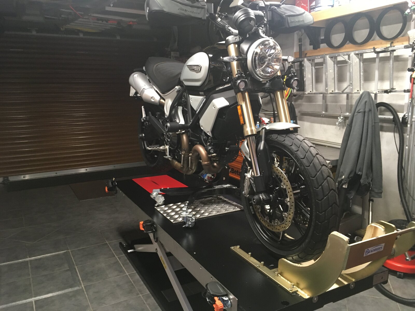

    You can see the straps and clamp - neither in use.. as I use a centre lift on Scrambler. IMG_1953.JPG
    My recommendation would be centre stand and these sprung loaded ratchet straps with soft loops around the bars.
    If you need to remove the front wheel - still use the centre stand, rear ratchet straps around the rear foot pegs - to pull bike back and rear wheel in contact - front in the air - and then the front straps to the bars to steady left to right.

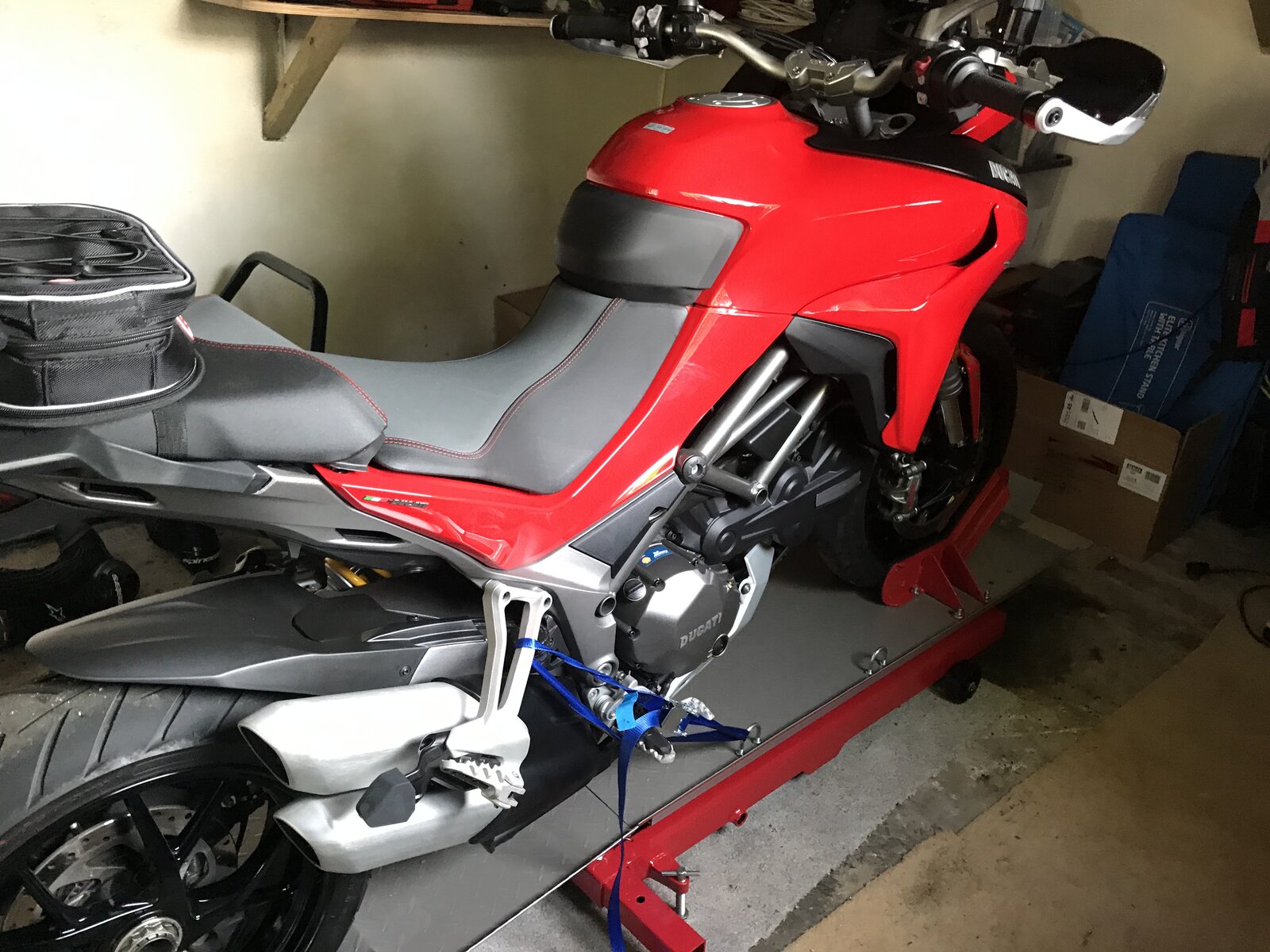

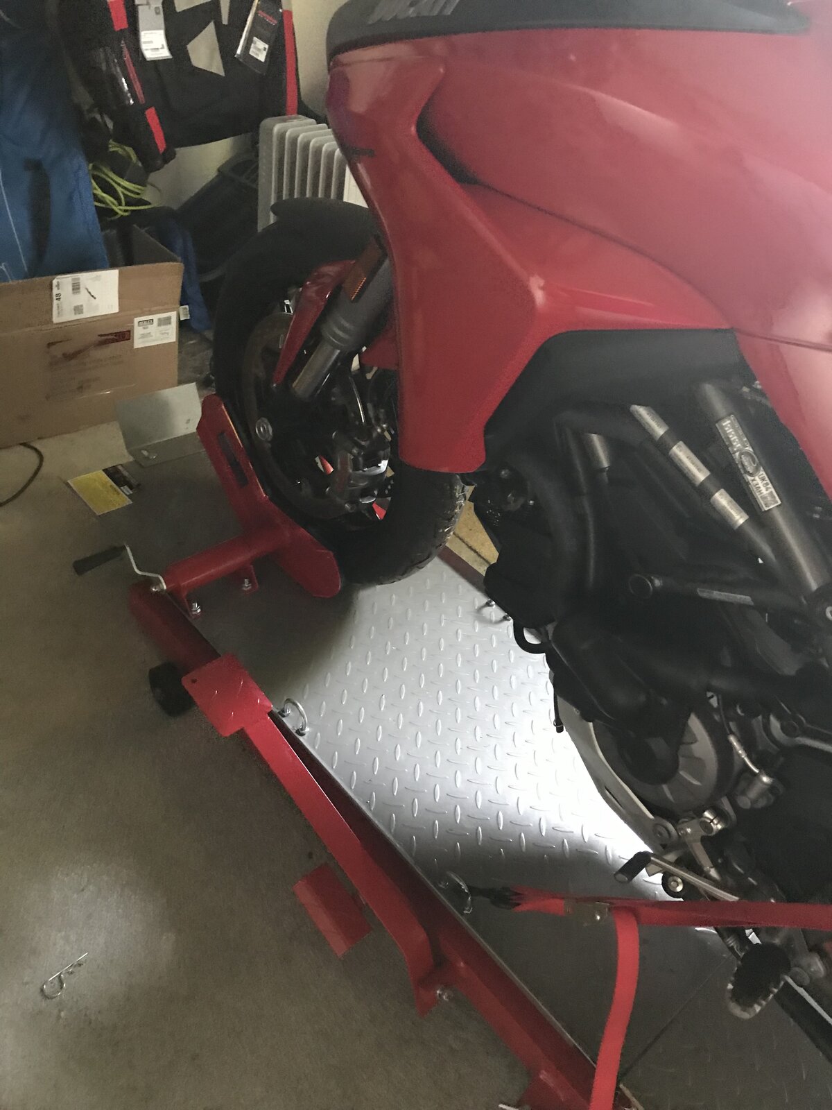

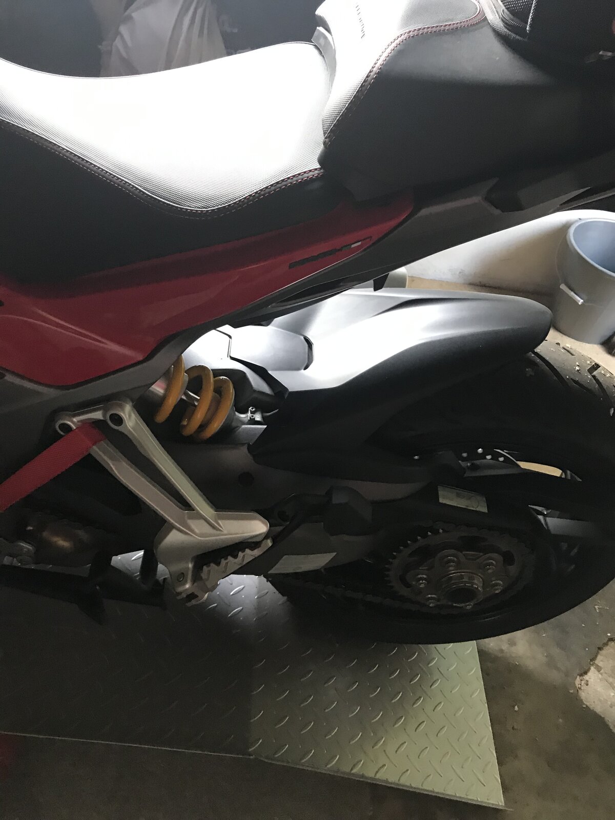

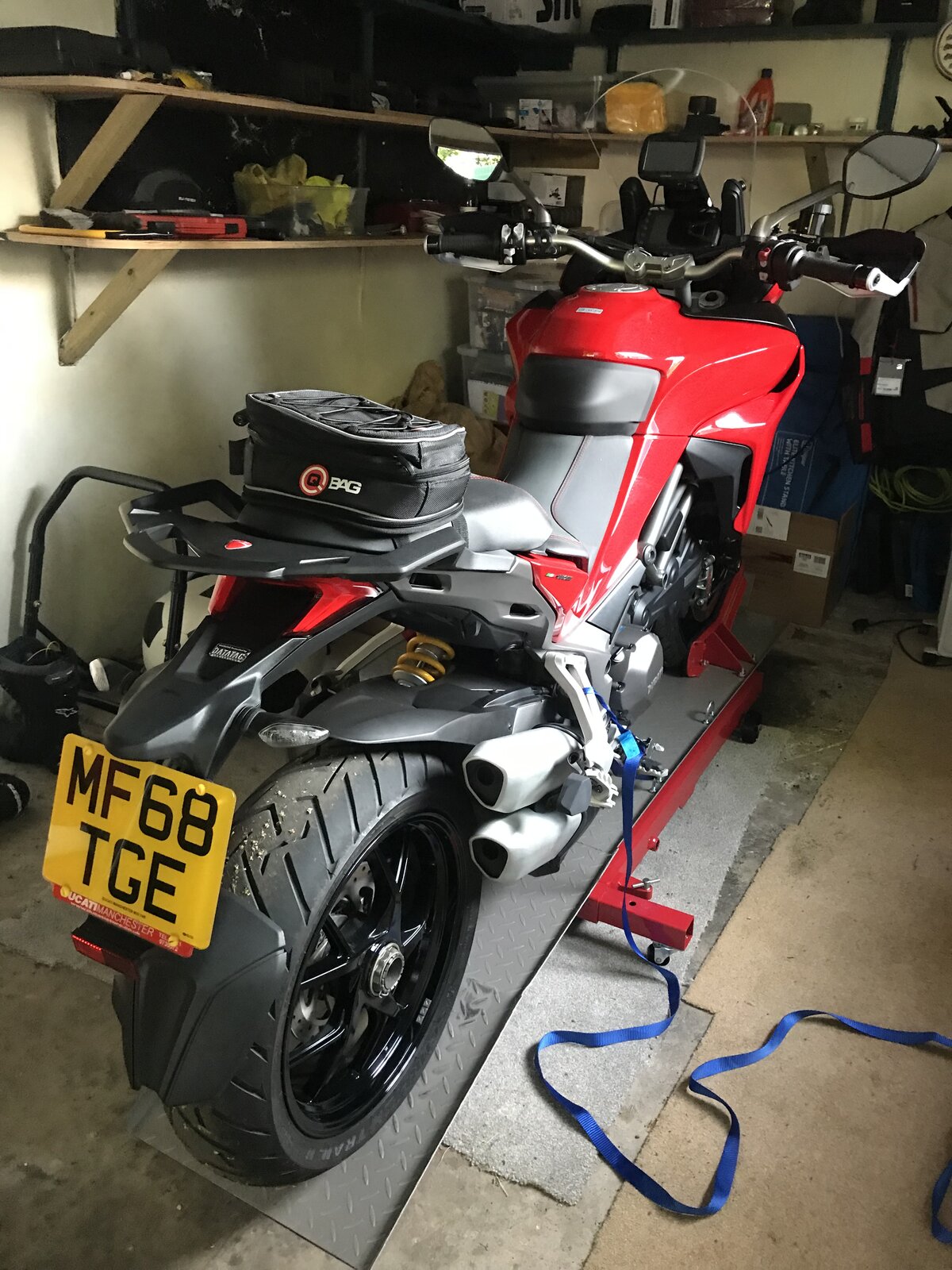

  19. 8F5DDA84-BBC1-4CC9-8A02-4E40D4051BB4.jpeg 7A1D5115-65A7-4FCD-A0C3-87E37720FC67.jpeg B95600E3-7302-4AD7-A7EB-F9CE75F0F959.jpeg Well it’s on. I have decided to not use the centre stand as it slides around when putting it on and also when trying to get it off. Plus the back wheel is a foot off the floor when it’s on it. So I’ve used the new improved front wheel clamp and two ratchet straps. The ramp seems only just long enough. Thoughts on if it’s safe?
