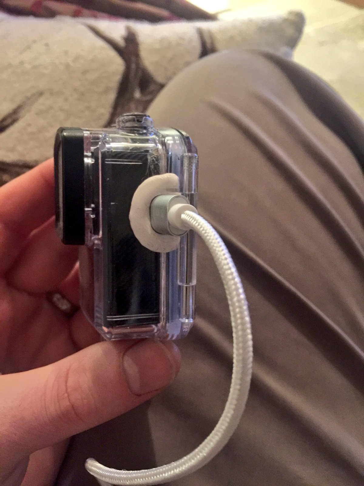

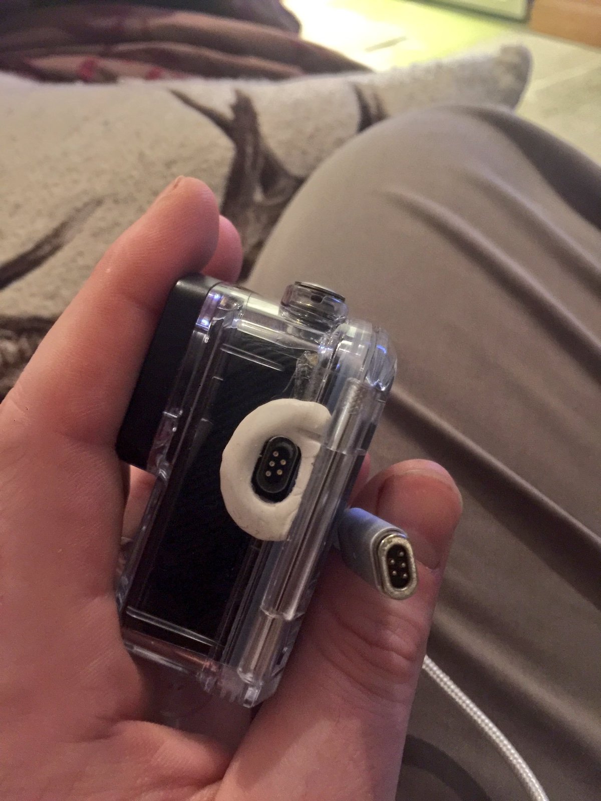

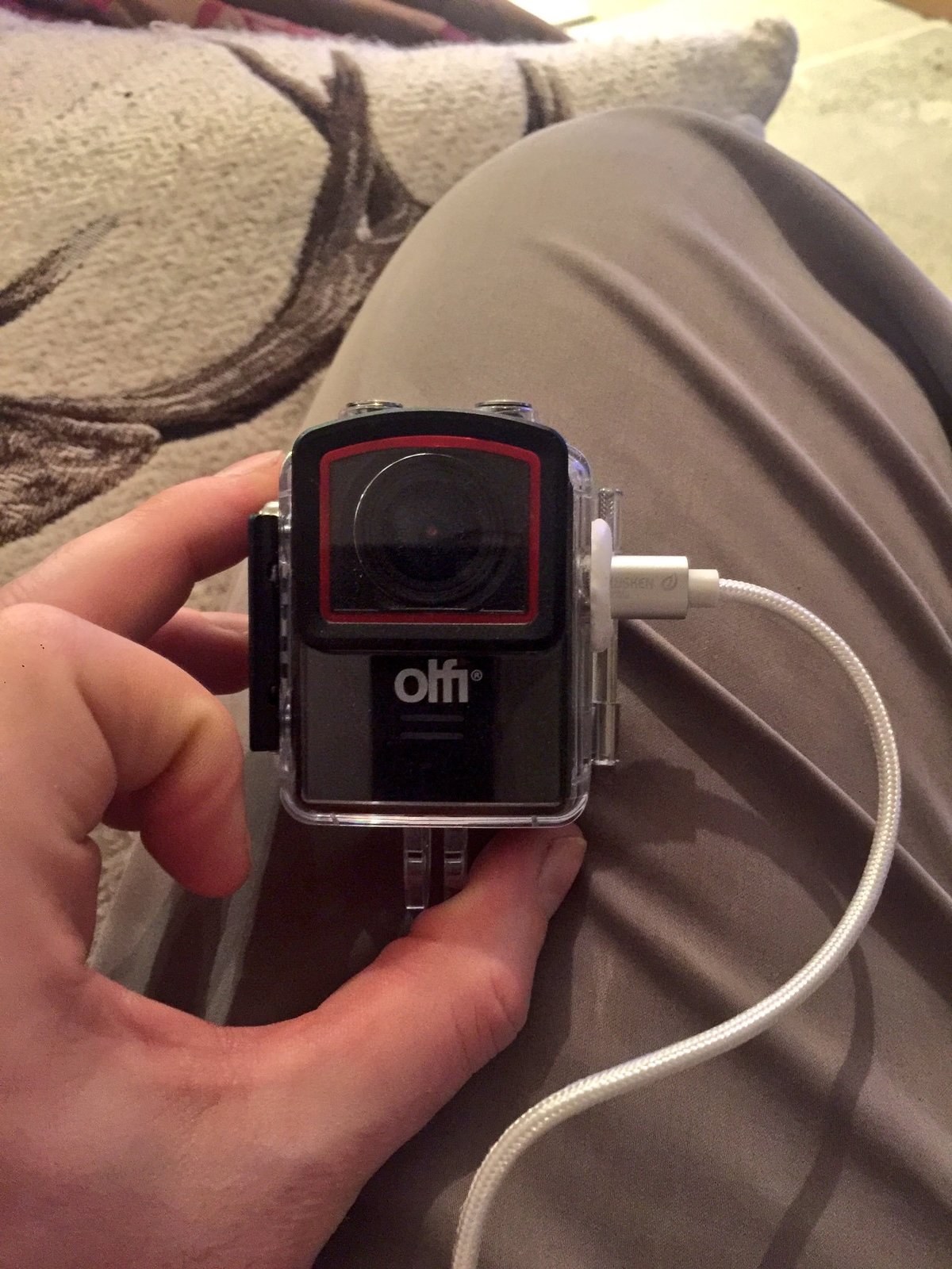

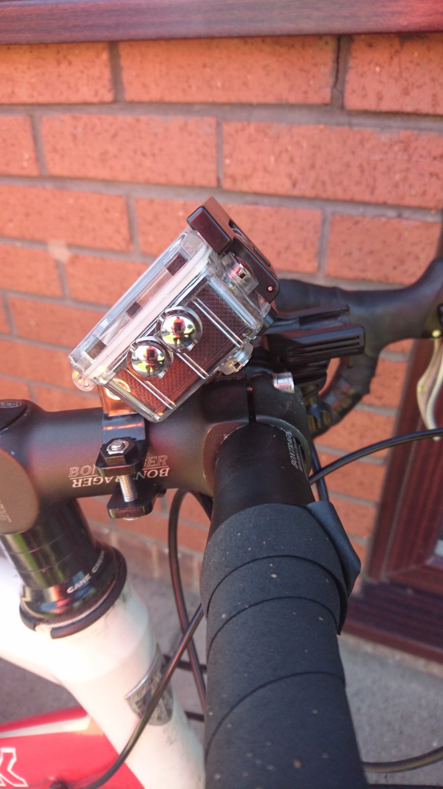

    Ive got mine hooked up to the bike's power and mount it to my bike screen. Easy to take off when parking in London. I've 'MacGyvered' my case with a magnetic charger too so I can charge it whilst retaining the rainproof part.

  19. So, tried the apeman and was a lot of stuff, all nicely packaged for such a relatively small outlay. Set it up on my pushbike and the video quality, even on 720p (to save on disk space), was very good.
    Only problem I had was that the mount couldn't keep the camera upright (per attached photo). Tried all sorts of bracket combinations but to no avail). Would be OK if it didn't rain here and I didn't have to use the waterproof case.
    Sent it back, and they tried very hard to rectify, but still no joy.
