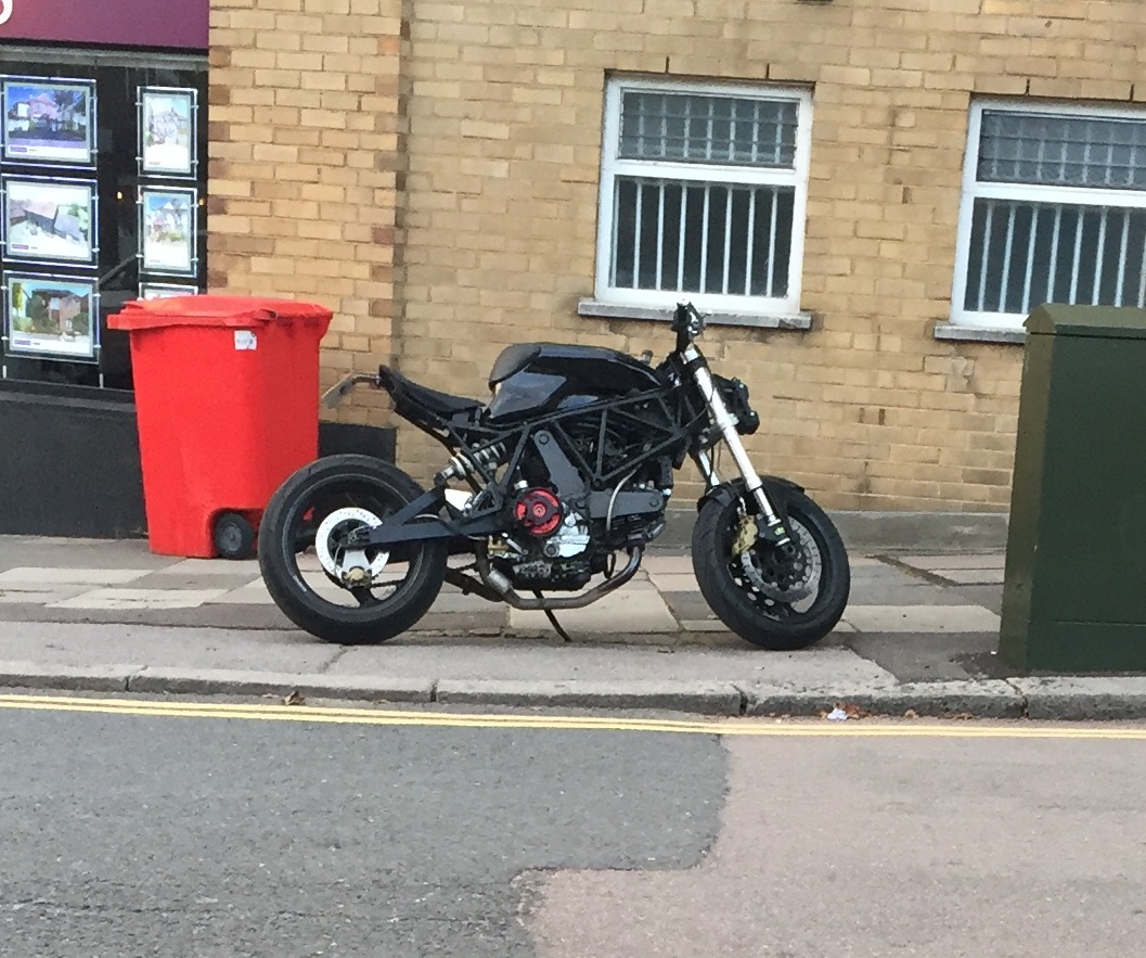

  11. Your story and views sound very much like mine about my Monster. Like you I have spent a fortune, but its been great fun getting the bike to where I want it to be. I can trade it and change but theres no bike I'd rather have, it does everything I want and more.
    Wheres a pic of your bike?

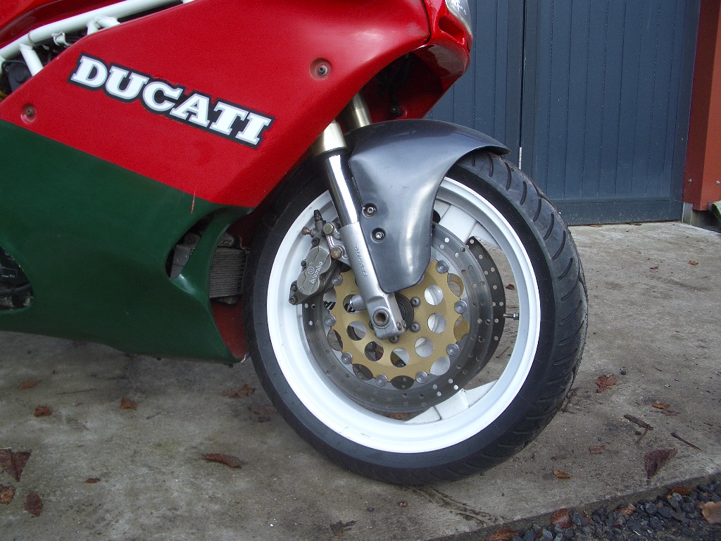

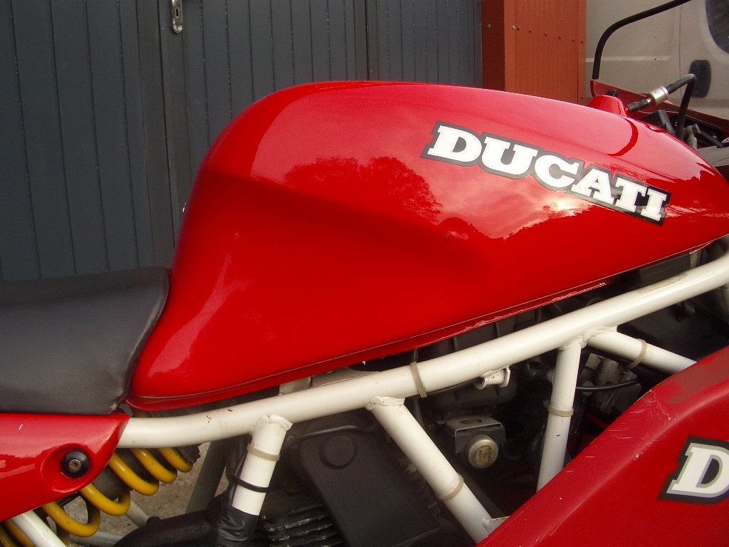

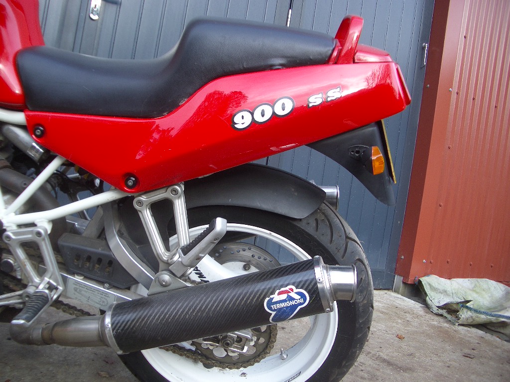

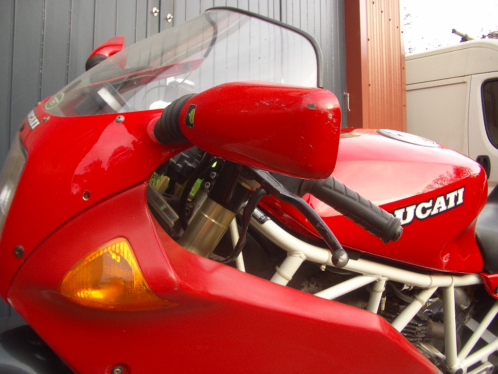

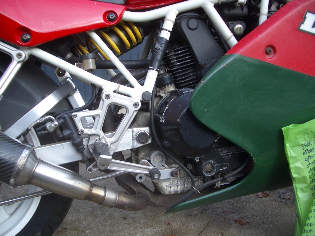

  12. Baines are excellent. What is arriving tomorrow?

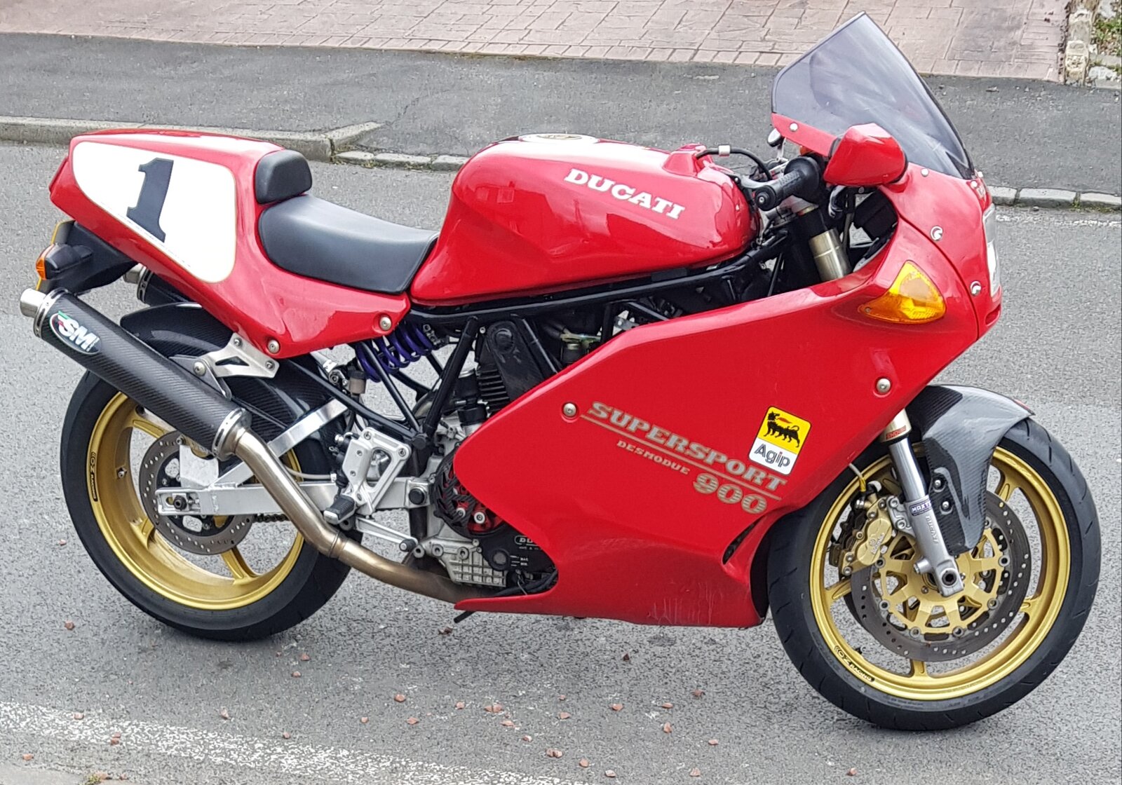

  14. Lovely. Wheels and rear hugger are unusual?
  15. I think they are Dymags, hugger looks right to me ?

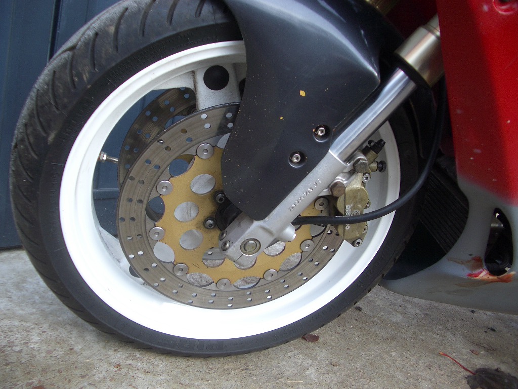

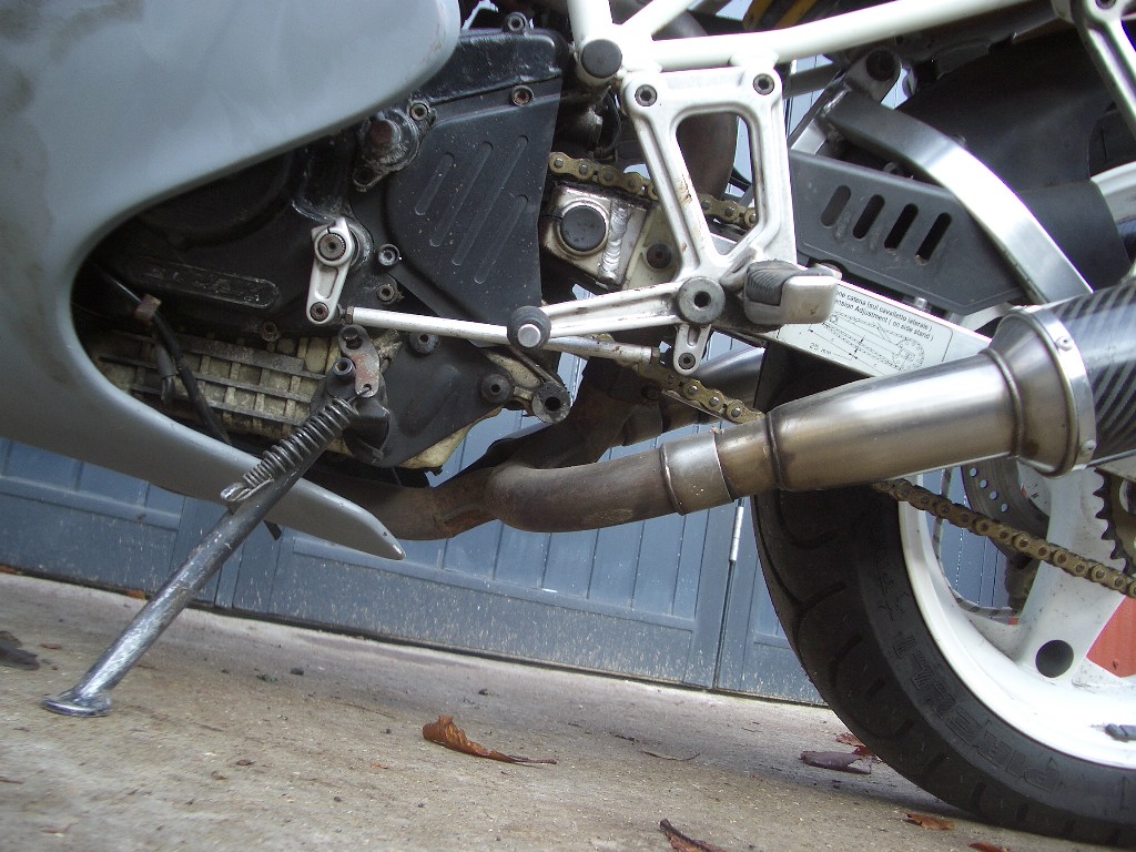

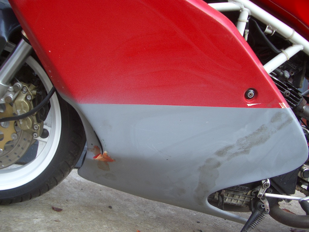

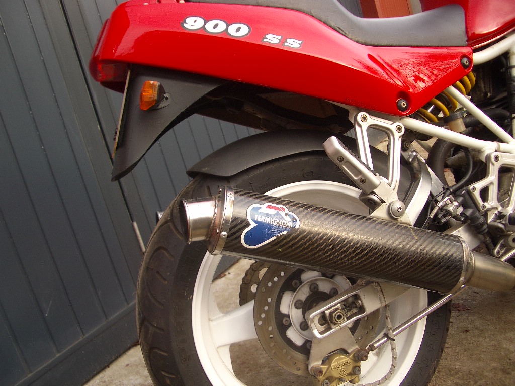

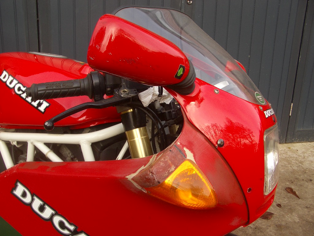

  16. Hmmm, don't know yet Carr, still in transit, sellers photos. It hasn't been used since 2012, it was fired up last week for a short while with no reported problems. I guess the tank had been drained previous to that, fingers crossed. They suffer with rot i believe ?
  17. That looks like a lengthy winter /spring plus project.GL:upyeah:
  18. It's only time ......... thanks.
