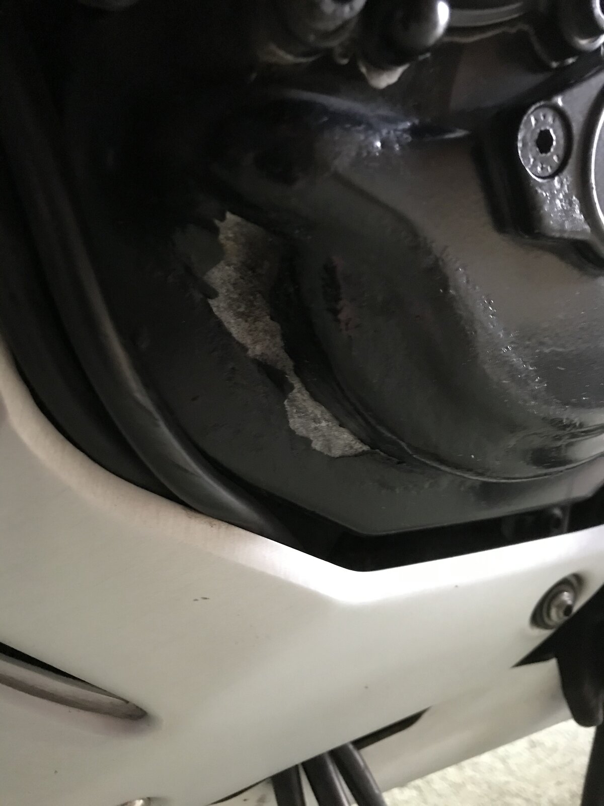

  1. Cleaned the bike and chain today as several hundred recent miles done in filthy conditions . I do use the bike all year round, am using it in winter mainly for tutoring and delivering vital medical aid. So came across this flaking paint today for the first time. I have seen it mentioned on the forum several times about Ducati’s flaking paint on engine casings but my question is..due to my current economic predicament.... what is the most economical way to fix it, is it sensible to think about looking for a 2nd hand engine casing as easier quicker solution, does it matter if I continue through the next few months , presuming the bare metal will stay ok? The economic problem is quite big but will look at all options. Thanks in advance for the forum wisdom and help. BTW I am quite useless at DIY, so my wife states.
    Bike is MTS1200s 2013

  2. I would think it would last you a year or two without issue
    BUT
    Would suggest that you drop sump guard
    Get a BRASS wire brush and brush off the paint and loose corrsion
    Then get a suitable primer (probably an etch primer)
    Paint it with a brush
    Then paint a top coat of some sort of enamel paint over it - extend into the good paint probably 10mm or so.
    May not look the best but will keep it from getting worse and not cost a packet (£20)

  4. This looks like galvanic corrosion. Do you frequently use a battery tender?
  5. Mine did same . Got mine powder coated. Was a good match.

  10. I think I would be tempted to clean the bike up thoroughly, ACF50 it (other anti-corrosion products are available!) and leave wet ACF in every area you find with broken paint, then keep applying to those areas every few weeks over winter to stop it getting much worse. That might stop the rot in its tracks until you have time / money for a bit of a restoration.
  11. it might not look nice, but its not the end of the world, as long as its not due to something like leaking coolant.
    Older engines such as 9x6 series suffer from flaking paint on the cases and never seem to get really bad.
    https://fractory.com/aluminium-corrosion
    Personally, I would paint it with an oxidising paint, or etch primer. Halfords sell rattle cans of the stuff.
    The inspection cover on the end is easy to remove, so I would take that off, clean it up and spray it separately.
  12. I'm not sure whether galvanic effects figure in this, but I'd use a stainless steel brush rather than brass. I've got one for cleaning aluminium for TIG welding, where even using a normal steel wire brush (let alone brass) visibly contaminates the weld. They're pretty inexpensive from welding suppliers. Maybe it won't matter anyway for a running repair. I'd love to tidy up the corrosion on my MTS engine, but where do you stop? I'd end up having to rebuild the whole thing to get it looking how I'd like it. I'll stick to keeping it running nicely and riding, it's a living thing.
  13. Agree defo use etch primer if you want the topcoat to stick and stay.
    Clean off with a solvent degreaser before painting, will remove all traces of grease
  14. Many thanks for all the very helpful hints and so without wanting to sound like an absolute plonker do I repair it in situ?

  15. Yes
    Drop the sump guard and move the cables and pipes
    Wire brush
    Clean
    Brush Paint Prime
    Brush Paint Top Coat
    Brush Paint Top Coat 2
    DRY thorughly
    Cover with ACF50
    Reassemble
    Have a beer...
