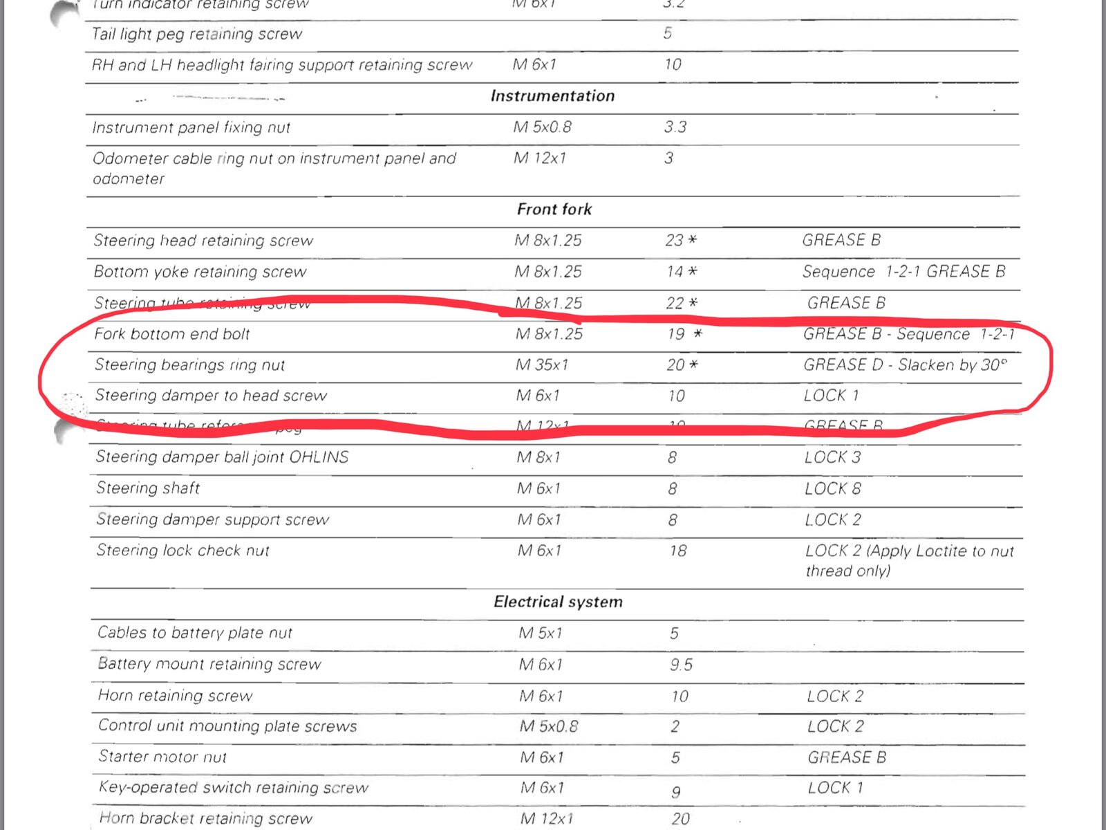

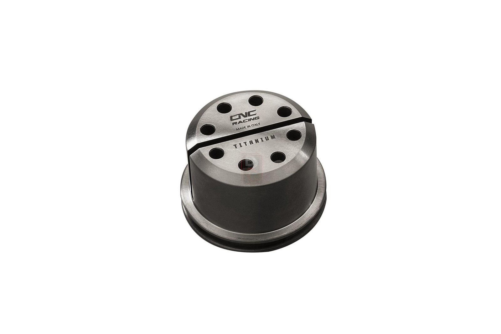

  16. YES!! thank you Final Edition,its a first for me and could've all gone tits up there,jacked up the front end and raised the yoke off,then in reverse with a bit of oil and grease,the bearings are not notchy,i have it now so that there is less clunkyness on the front end,just a little under braking,so may tighten a wee bit more,what is the torque spec on that do you know?
    i kind of like the look of those anodised yolk nuts now i have bolloxed the original up,kerching..again.
  17. Here you go... don’t forget to slacken it after tightening.
