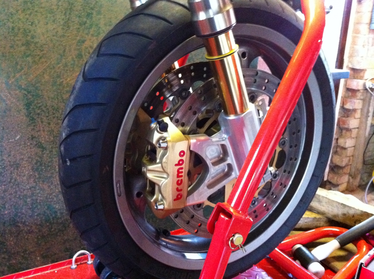

  1. They look like those used on the 999/749R to me, albeit Ducati fitted the silver coloured model other manufacturers fitted gold or grey.
    These are M4;
    Though I got them from an Aprilia dealer and they're gold coloured IIRC, Ducati fitted the grey ones to 1098 etc.
