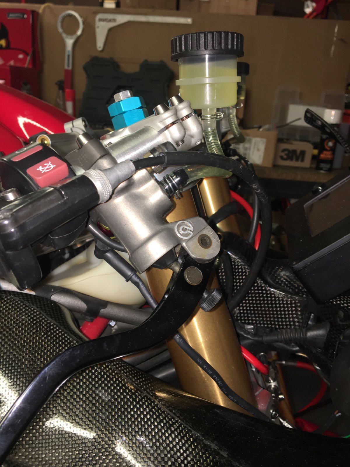

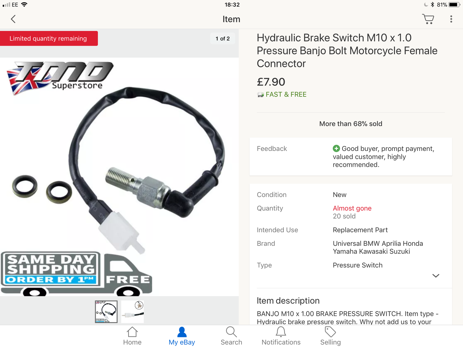

  5. Just fitted one of these today.
    7C7E3F2D-69DB-4777-A7E2-3DEC04F9B0B7.jpeg 0CD36F0B-9D77-4984-AB66-B0ACCFB8AB68.png
    Seem s to work ok. Activates the light with about half lever pressure.
  6. I'm not with the bike this week but I might order one of those and see if it sorts it for the sake of £8
    I've got a brembo master cylinder too, what part of the loom does this attach too?
  7. On my 998, the 2 thin wires coming from behind the headlight. I just cut the supplied connector off and spliced the wires in. 10 minute jobby
  8. Ideal, I'll have a bash at that when I get home! Cheers mate
