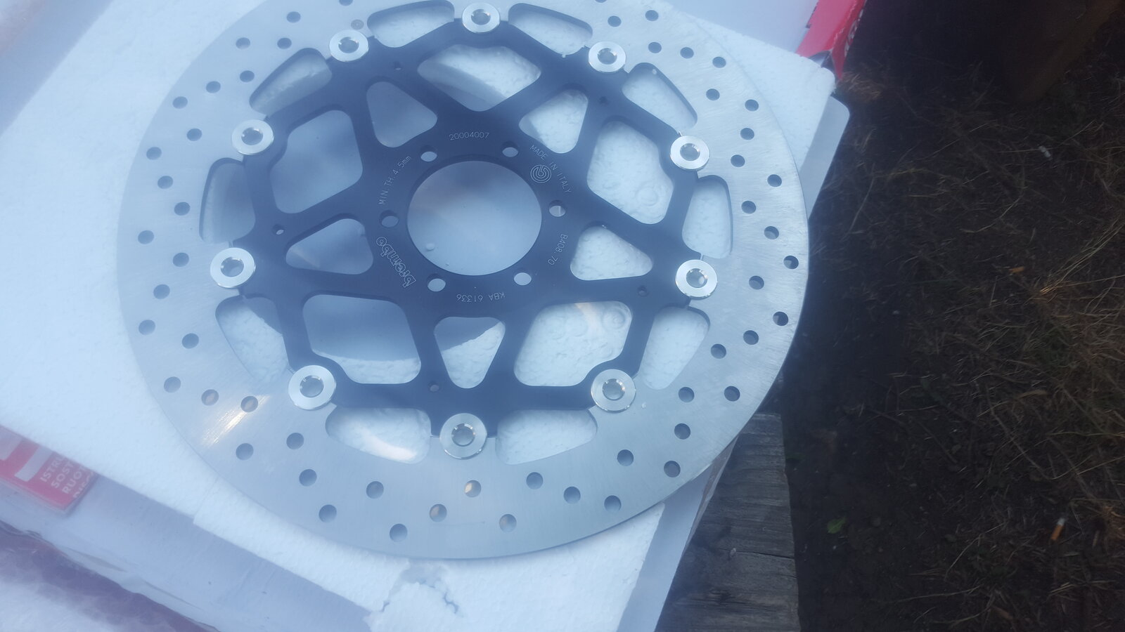

  9. @chizel
    Those new discs look like the ones Nelly supplied to me when the carriers on my original cast iron discs wore beyond safe limits.
    There is a recess in the surface of the original disc carriers that the mounting bolts sit into, but there isn't one on those new ones so you need some bolts with smaller heads than the originals otherwise they will foul on the speedo drive. Nelly sorted some for me so he will know what you need.
    I found out when I spun the wheel on the paddock stand. If you fit them and then ride it without checking, it could be nasty.
  10. Shit! Thanks mate that is very good advice! Tbh I'm on the look out for some ti or stainless bolts to replace the originals. Will have to do some homework...

  14. Stainless button heads no good?
  15. Stainless button heads are the ones that Nelly supplied for mine.
  16. That's what I have also.
