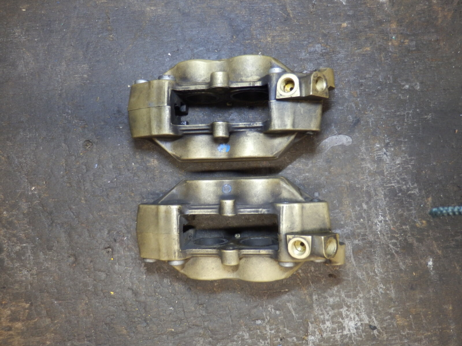

  1. A wanted thread on here last weekend for a pair of early 40mm mounting bracket Calipers reminded me I had a set in the garage that I’d been meaning to pop the pistons out of to see what condition they were in before offering them for sale as in need of refurbishment.
    I didn’t reply to the thread because I wanted to know what they were like internally first.
    I’d been putting off doing it because it’s a job I hate doing, mainly because in the past I’ve struggled with an array of bodged together tools to remove pistons, so thought I’d investigate a set of proper ones.

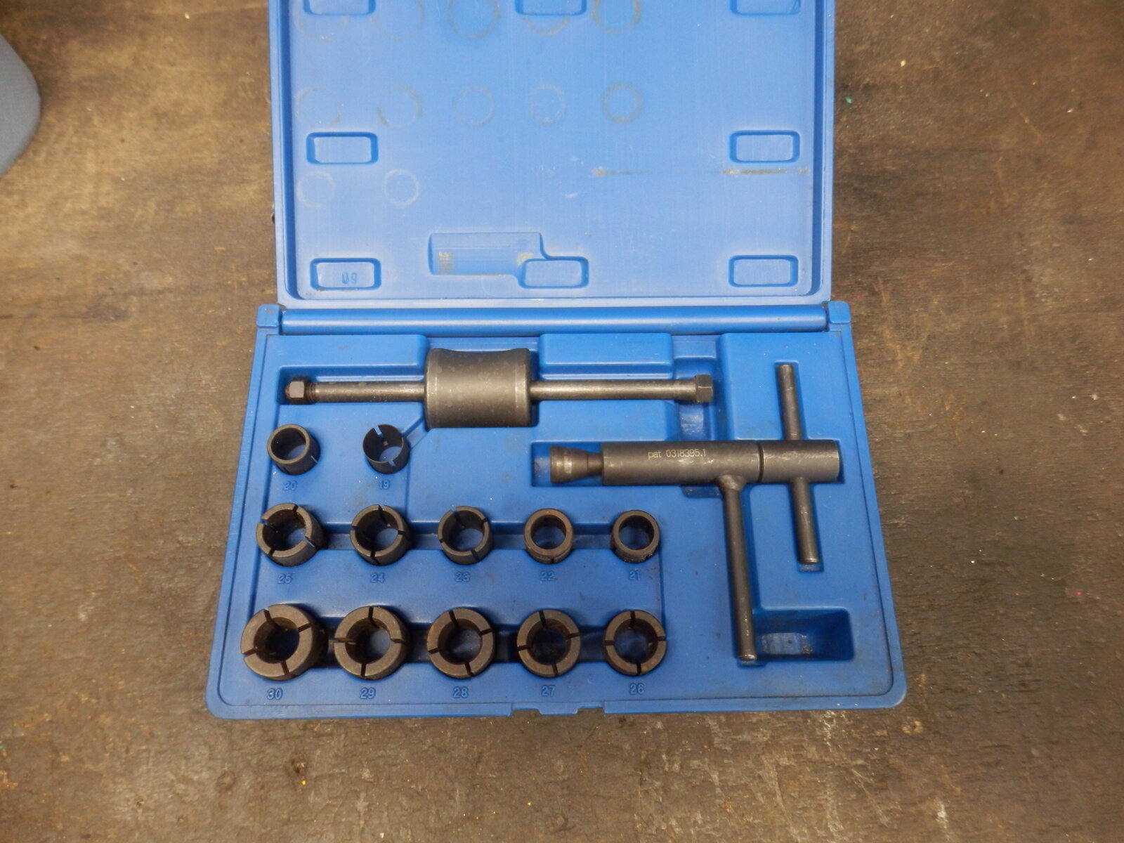

    I was lucky to find this used set on EBAY which I ‘Won’ for under £30 inc postage, and they arrived on Saturday.
    And to the point of this thread – Why the hell didn’t I get a set of these years ago?

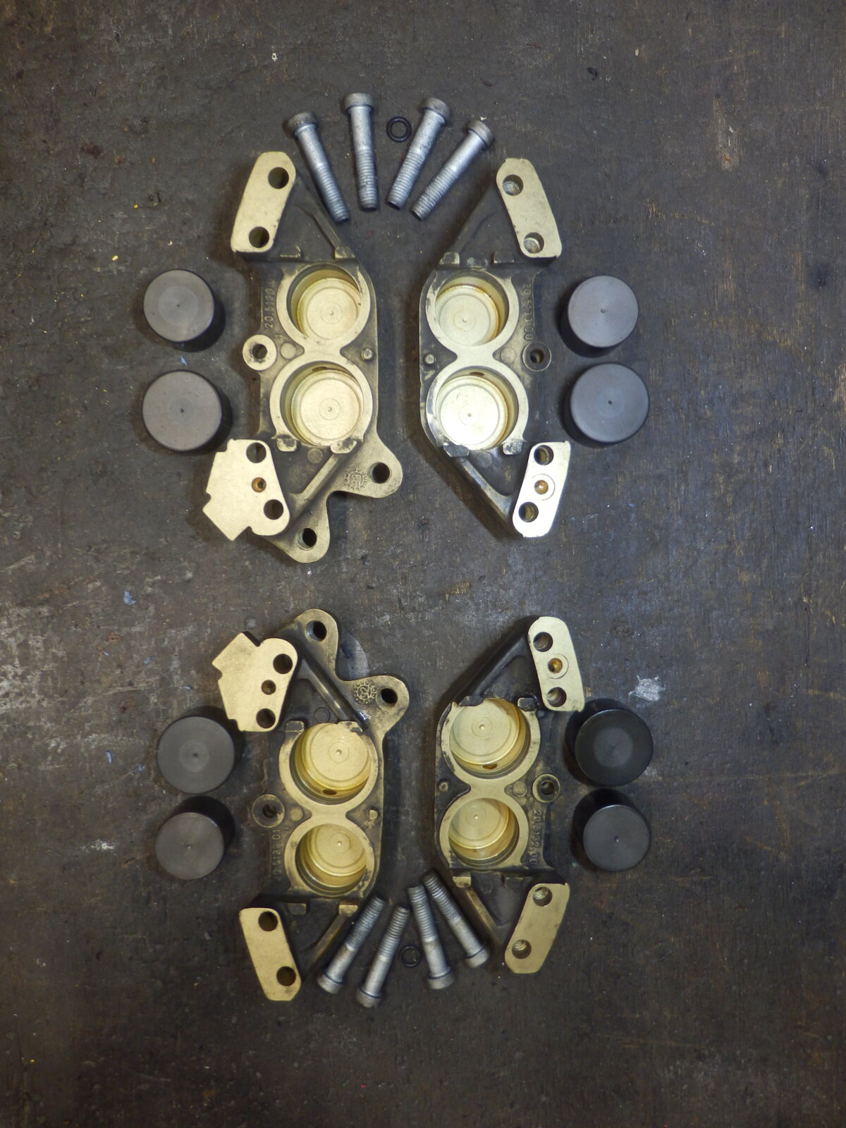

    I’ve not used the slide hammer bit yet as the Calipers turned out to be in really good internal condition, and the pistons slid out really easily when gripped with the different sized tool inserts.
    I went from this:
    To this:
    In literally around 5 minutes. – Brilliant.

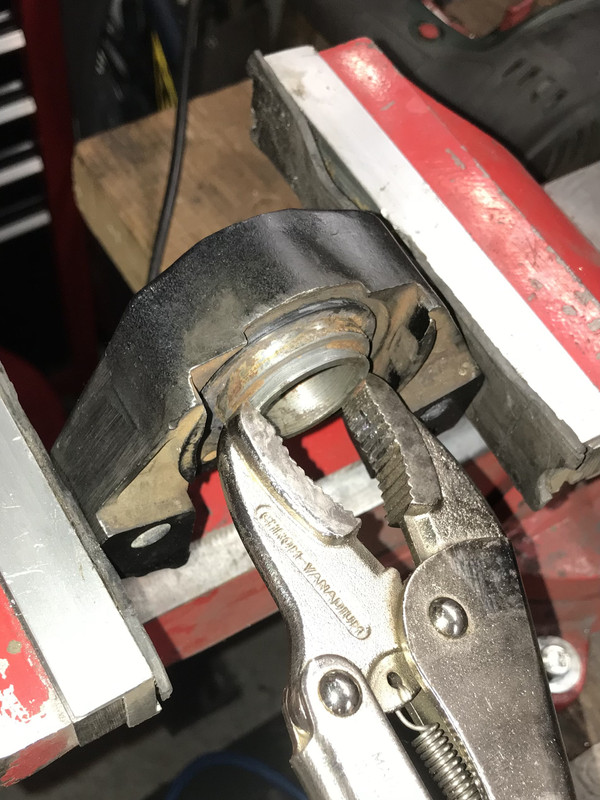

  9. My last stuck piston ordeal was on the Darmah brake calipers. And before that, the clutch piston on a 1989 900 Supersport. For both, compressed air was not strong enough.
    I use hydraulics in place (brake/clutch fluid) to get the pistons partially out before flushing and dismantling things. Then, in the vice with vice grips around the piston and they come out pretty easy. Obviously, you need new pistons after that… 28A278F7-6877-4C1B-850F-DCF155F673F2.jpeg
