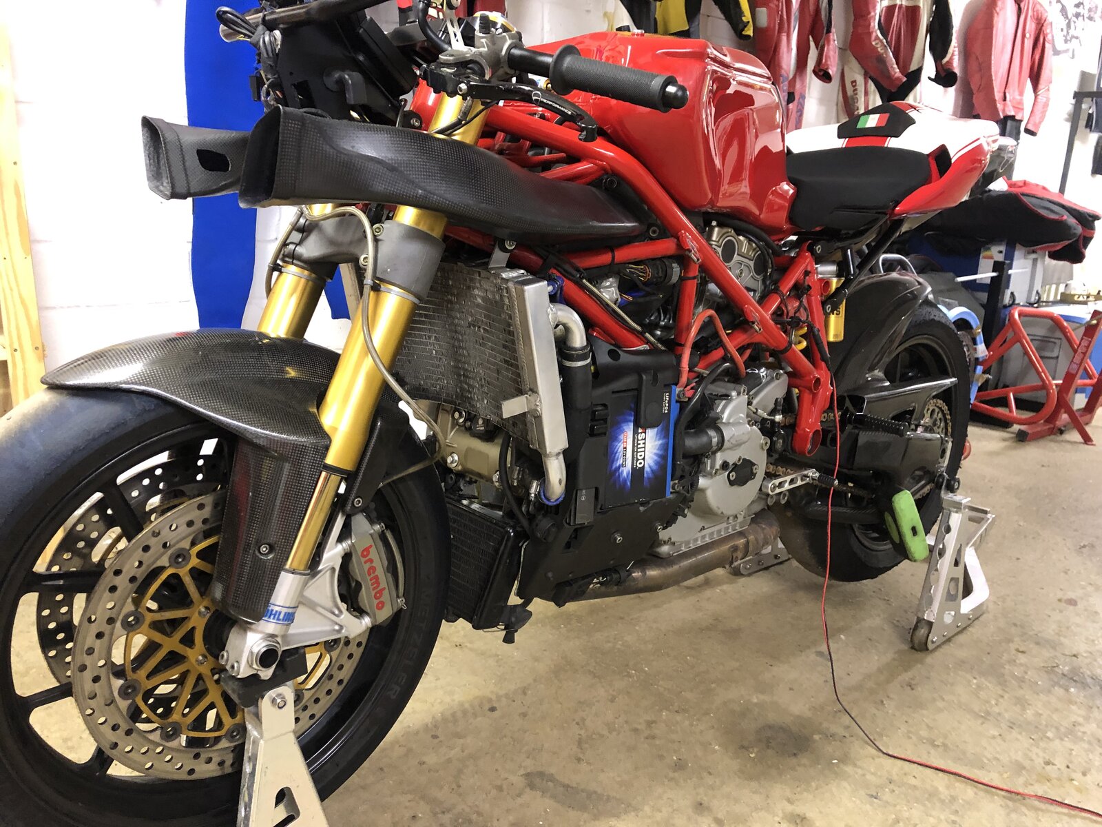

  17. Have you considered a “T” brake line set up? Very cheap compared to discs, MC, callipers option.
  18. I’ll bite. Tell me more.
  19. Not the best photo, but single line from master cylinder to right calliper and “T” off that line by the lower triple clamp to left calliper. As opposed to two lines off the MC, one to each calliper or a single line off the MC to the right calliper and a further line from the right to the left calliper.
