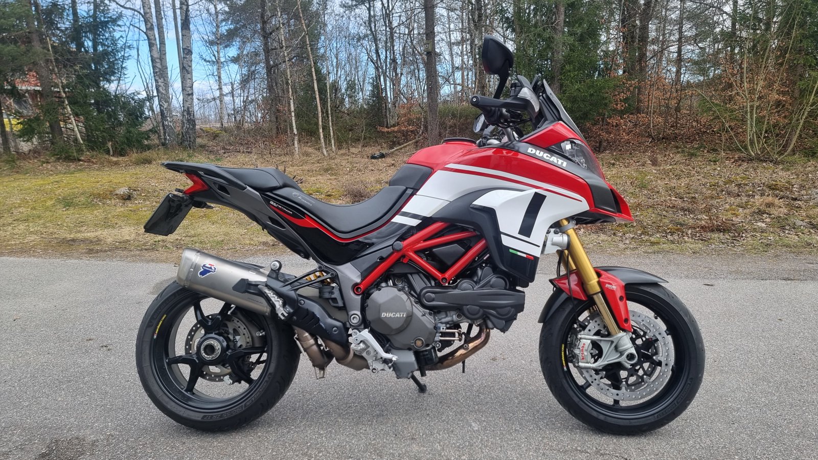

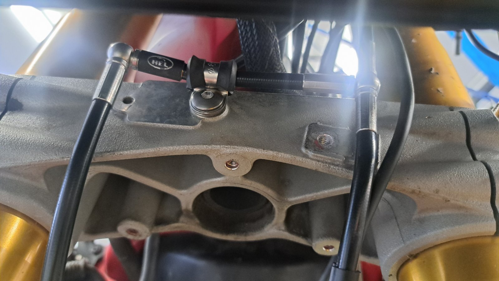

  1. My Pikes Peak has Desmo Service this winter, and then I decided to upgrade the brakes.
    Discussed this with my Ducati mechanic, and landed on the following setup.

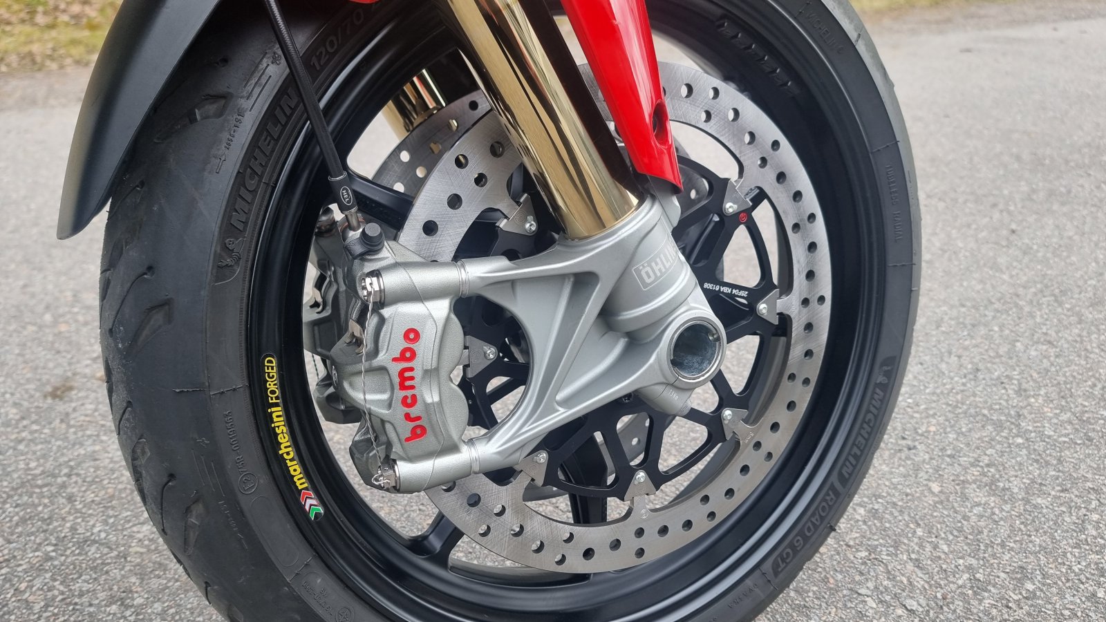

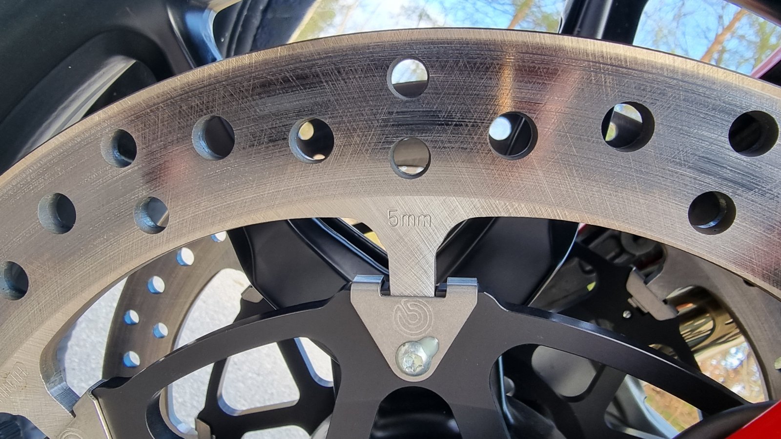

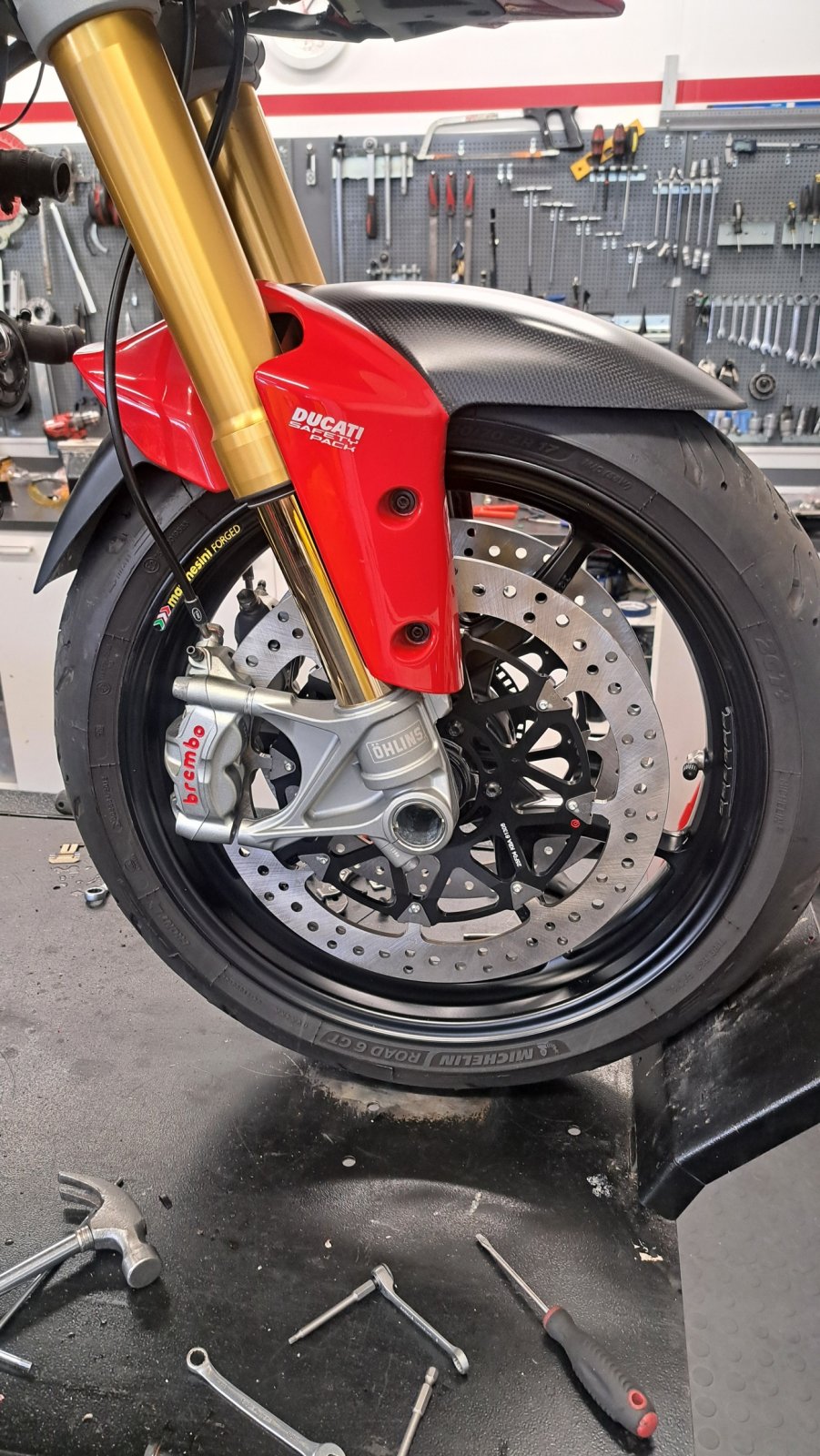

    Brembo T-Drive 330mm discs, with sbs Dual Carbon pads.

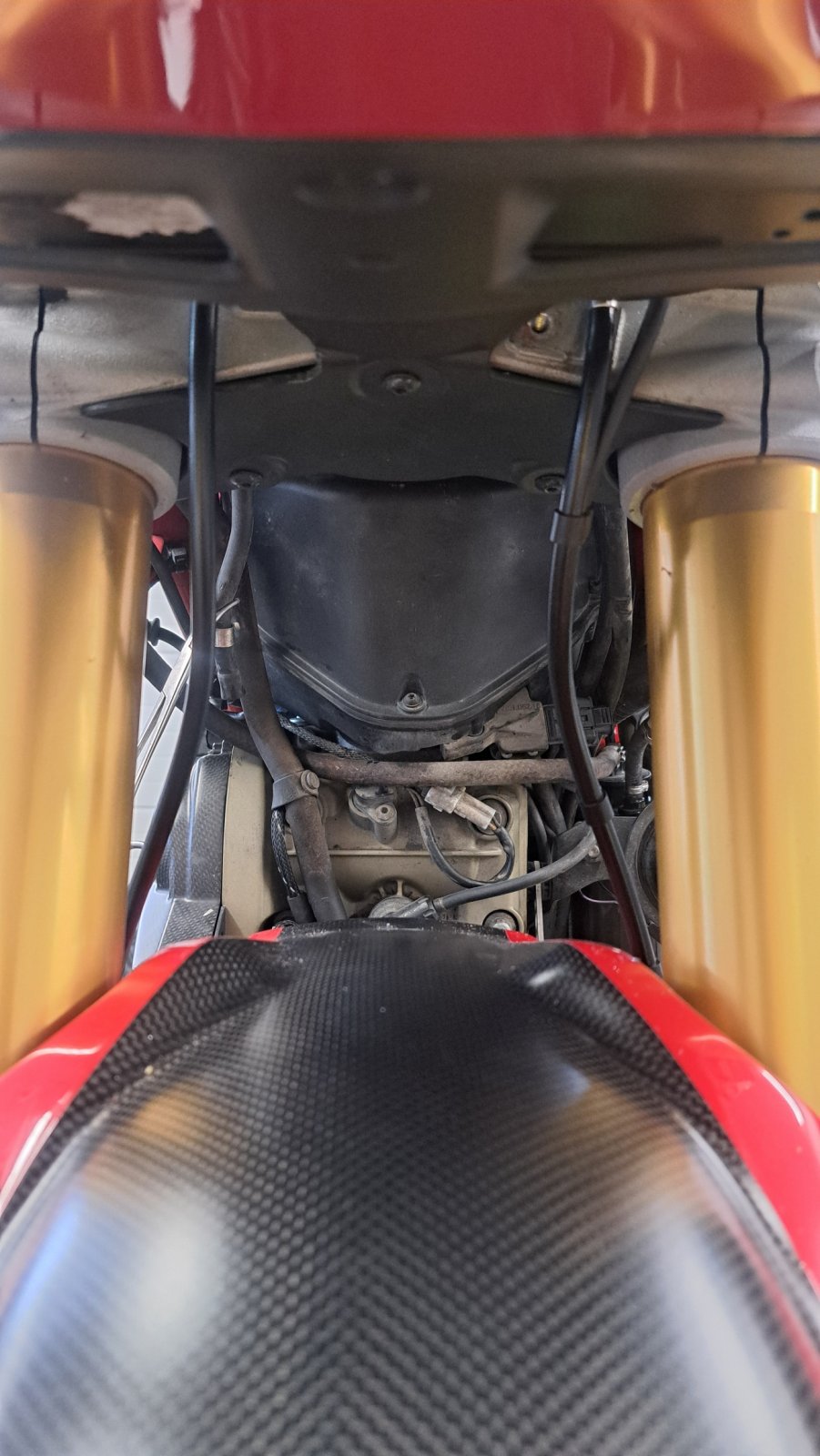

    Then brake hoses, and I wanted to get a setup with one hose for each caliper instead of two banjo couplings on the left side. It is so tight to get the left caliper off when changing wheels, so I wanted this solution. My mechanic said that he worked with HEL Performance, and ordered a custom setup for my Ducati. Once he started with Desmo Service, there was easy access to the ABS unit, where the brake hose is connected.
    The result was absolutely fantastic, and looks completely factory installed. I am really looking forward to having the break-in procedure of the carbon brake pads against the brake discs performed, and feeling the result of the upgrade?

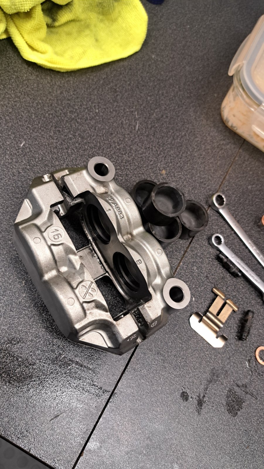

    Calipers were ultrasonically cleaned, and out with pistons and gaskets
    I initially wanted a solution with 320mm discs, due to lack of space when disassembling the calipers. When I mentioned this to my mechanic, he looked at me like I was a total idiot, he he. We'll do it like this, he said, and took down a ready-made setup with brake hose for one of his race Ducatis
