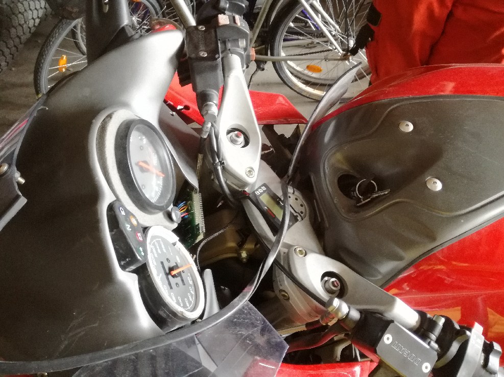

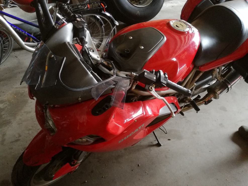

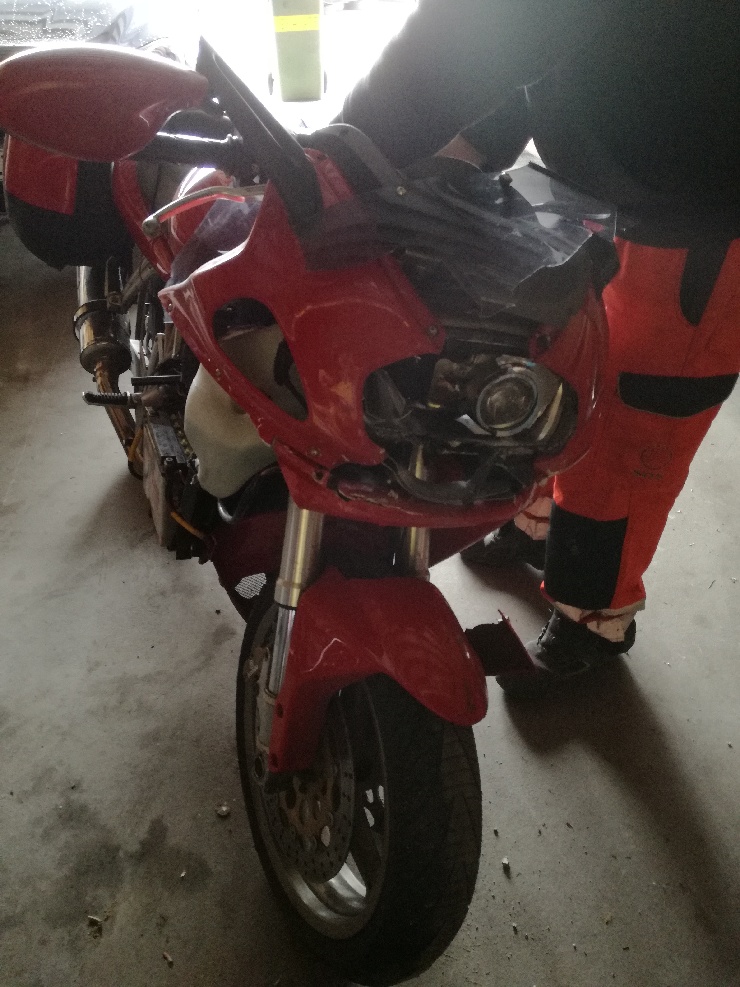

  1. So a little over a week ago, I was returning from a 2-day business trip with my ST2. The trip didn't go as planned, as I have yet to reach home, and currently writing from the hospital. It appears that I had some luck on my side, as it seems I only have fractured ribs, pelvis and some internal bleeding which was small and didn't need attention. I won't go into the details of the accident as it's still an open case, but let's say there's a green tractor, a green van and a head on collision...
    I hit the van at around maybe 30-40mph. I haven't seen the bike, but my sister managed to take some pictures. It doesn't seem that broken, but I do suppose the wheel and brake disc are gone. The question is, how about the front forks and the frame. I suppose the forks could be changed for similar ones or monster ones, but is it possible to check the forks, and the frame somehow?
    I know an old bike like this isn't worth nearly anything, but it's more than I have in my bank account. I might be getting something from insurance, so was wondering if there's any sense in getting it home and checking if it could be repaired. The problem is the market for spares in Finland is small, so I might not be able to sell a lot or anything off the bike, except maybe the hard bags...
    Any pointers welcome at this point, as I have a lot of time at my hands currently and thinking about what will be my next move as soon as I am

    the thing to do with the frame is get it on a jig to see if it's bent or not (if not, and you like the bike, you might well be better off fixing it). I can recommend one in the UK, but that won't be much use to you... (Motoliners) Steel frames can be straightened (which is why I race a steelframe CBR600), but that's the first thing to check. (then check for cracks). I'd expect the forks to be toast, but wheels are pretty robust. Do you know if you were accelerating hard at the point of impact? (don't say on here) - although it wasn't a good one for you, the bike might be relatively undamaged.

  5. Sorry to hear about your accident. I drove my Honda VFR750 into the back of my house once whilst trying to bump start it, half asleep at 4am. Certainly woke me up that day! Anyhow, the front end looked very similar to yours. Besides all the bodywork being trashed the front forks were now J shaped. I had the forks re-sleeved which didnt cost too much. Fortunately the frame, wheel & discs were fine. It was just then a question of trying to straighten out or replace all the fairing brackets and getting new headlamp/bodywork/clocks/screen for it.

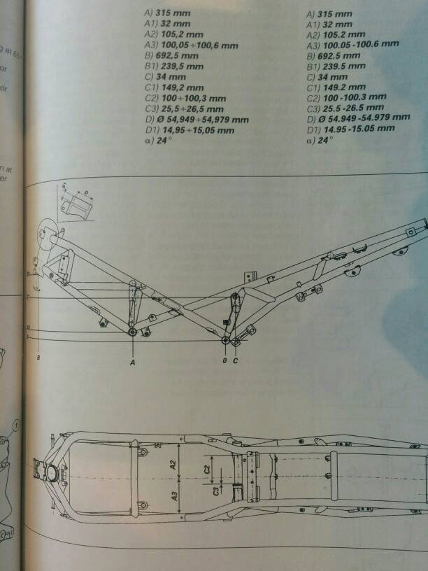

  10. Heres some frame dimensions ,as said check for cracks on the engine at mounting points. Good luck with it.
    Get well soon.[​IMG]

  12. Did have a small bruise on one of my thighs, but the main impact was the tank in the groin... As soon as I get some info from the insurance I'll check what is the best solution. Good to have the places to check and the dimensions. Thanks everyone!
