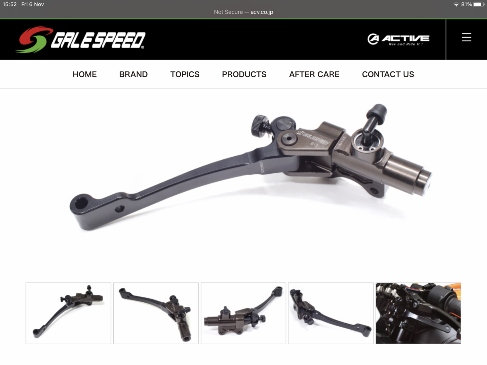

  5. Galespeed are now manufacturing some nice kit! Monobloc billet radial at a fraction of the cost of Brembo :eek:
    FF913DC0-79BC-40AC-A5E7-A050DF34FB96.png A460A45E-FAA5-40BC-BD1E-C1669522CEAB.png

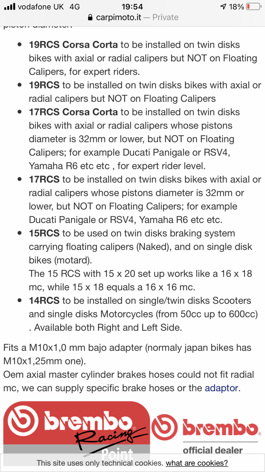

  6. so this is my point around changing something in the brake TO Caliper ratio particularly on a 2020 v4 with ABS Looking at carpimoto website a italian brembo supplier they say not to change the calliper from the stylema 30mm pistons to the GP 32mm piston ones as that effects the ABS set up.
    So im thinking changing the master cylinder will also effect the ABS set up that has been created to modulate with a known quantity of fluid either end.
    Of course in a race track day set up you could remove the ABS but i dont see many doing this...

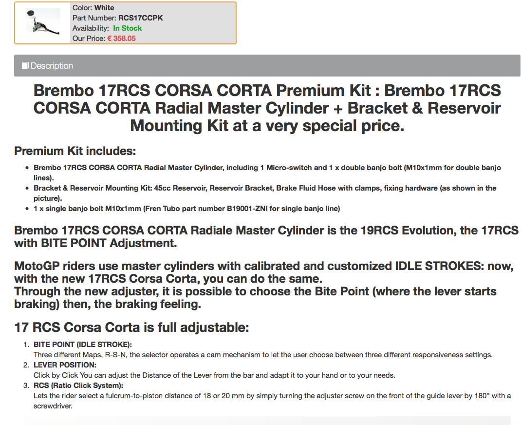

  7. Corsa corta has adjustable ratios.
    But you are right, fitting the wrong ratio with abs can be fun :joy:
  8. Correct:upyeah: you will get a different feeling at the lever but the actual braking power will be modulated by the abs system anyways:bucktooth: just changing the radial fulcrum point has this effect but can also make the movement of the pistons more progressive or more aggressive..... Hence the change in feeling.
  9. I fully understand the fooking about with it especially on a non ABS bike!! The feel change you get and whats relative to a track feel versus a road feel..........but with a ABS equipped bike a different bore mc means you are sending more fluid to the ABS unit than its set up to recognise/modulate which ultimately may interfere with its operation.
    thats why carpi moto who are advised by brembo say not to do it on an ABS bike...

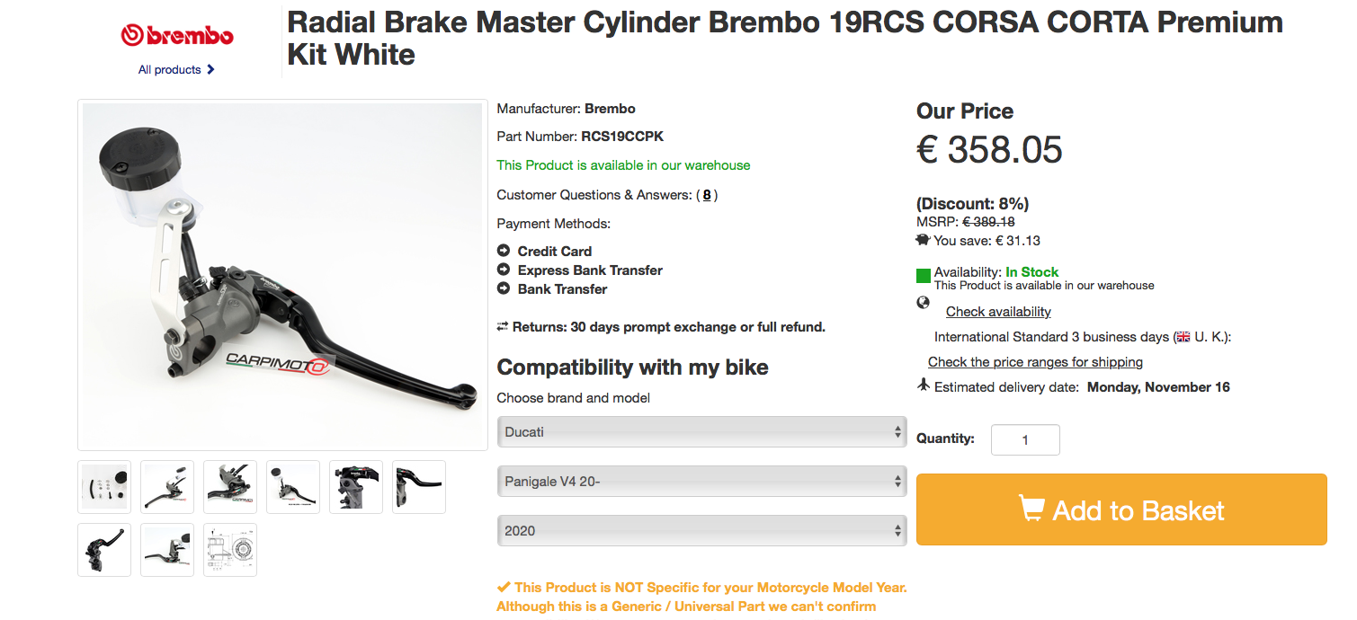

  12. found this
  13. they say the 19 is not compatible... but the 17 is!
  14. I try thought it said the 17 is not compatible but 19 is ?

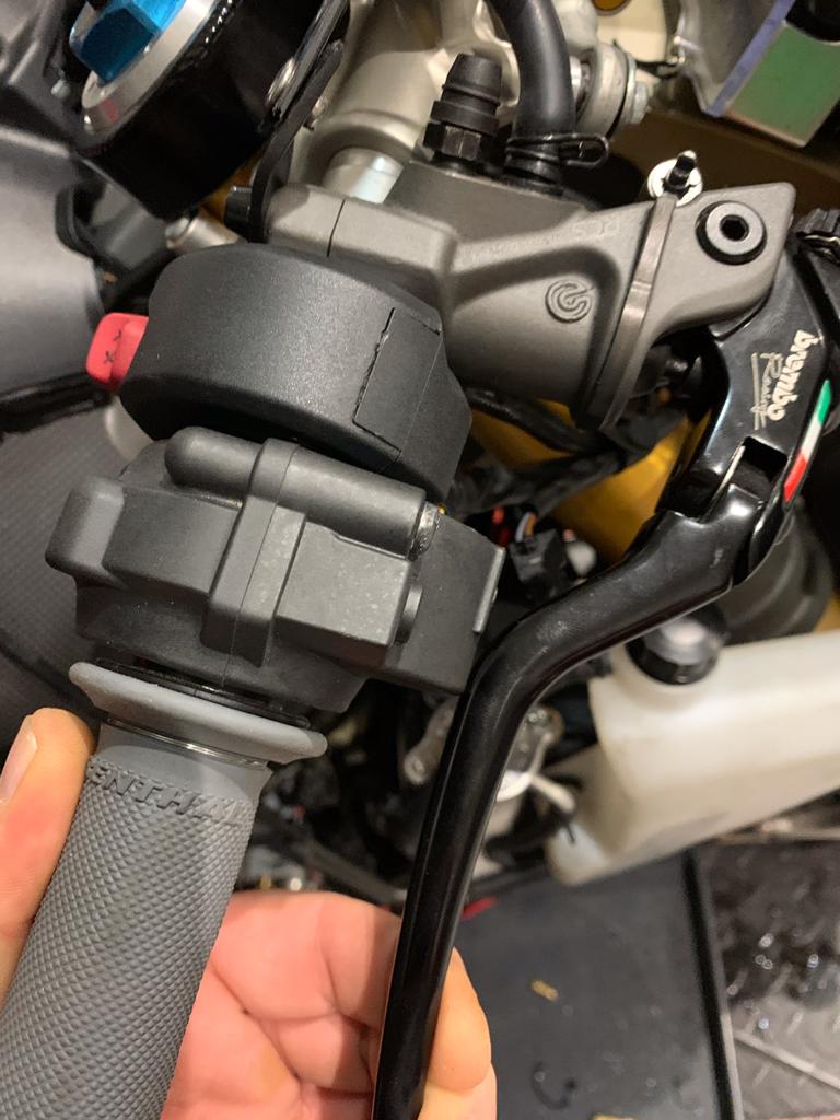

  15. Has anybody on here installed at brembo RCS master cylinder to their V4?
    I spoke to a mechanic and a guy who installed one and both said it will NOT fit unless you remove the kill switch as lever hits housing . They both also said that if you get a jetprime switch gear all problems will be resolved. upload_2020-11-9_19-18-12.png 675876DD-6B2A-4BEE-832D-D1656CC7C226.jpeg 5F9C5B50-1955-468C-B8CA-F86EC5F21A82.jpeg
  16. The ukracesupport.com web site states that the 17 RCS Corsa Corta was develiped for the Brembo M50 monoblock caliper. How similar is the M50 to the Stylema ? Andy

  18. go to the carpi moto site spec your master cyl and check its compatibility...19 corsa corti NO, 17 yes.....
    that said i agree its a mine field.......
