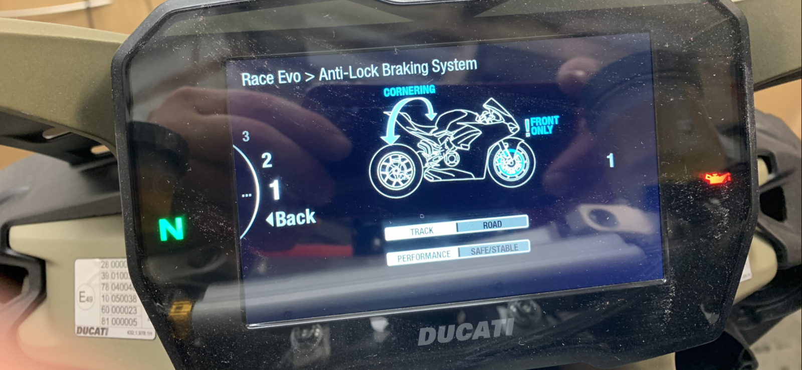

  5. This is what you see in the evo2 software around abs and tge cornering abs you’ll see you can’t turn it off
  6. kind of annoying...
    on the 1299s you could turn it off...
    Has anyone taken the ABS off or disconnected it? What’s the process?
  7. tbh is it that good particularly on level 1 and2 with the cornering ABS..... do you need to remove it? Does removing it affect other bits?

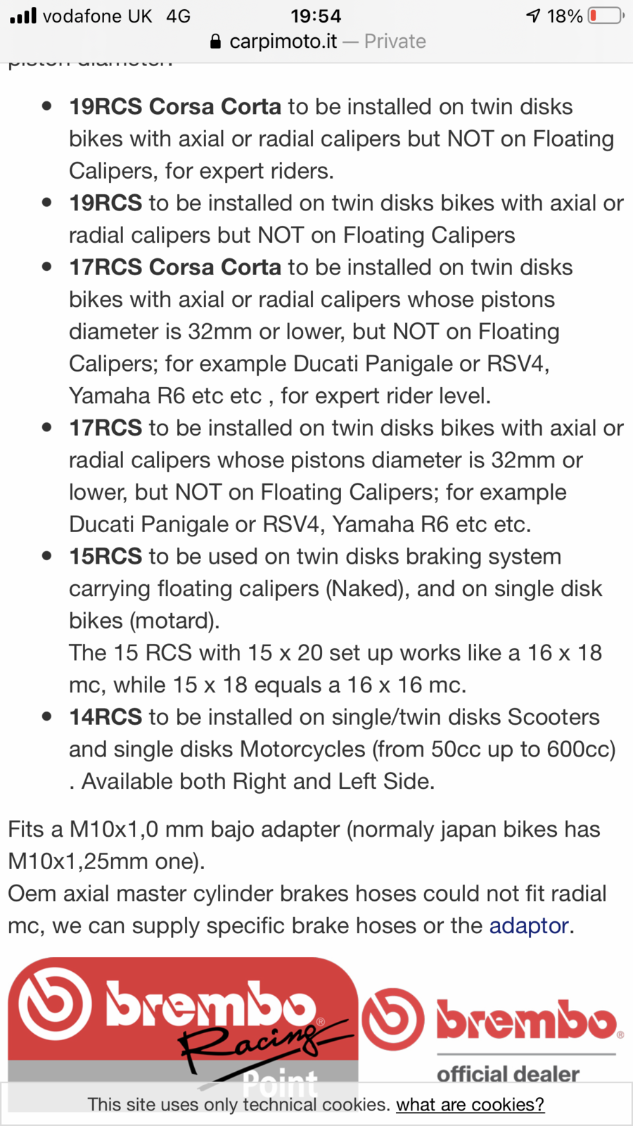

    I did read today one of the question responses on carpi moto where they say changing callipers effects the ABS, changing the master cylinder doesn't effect the ABS.. so...

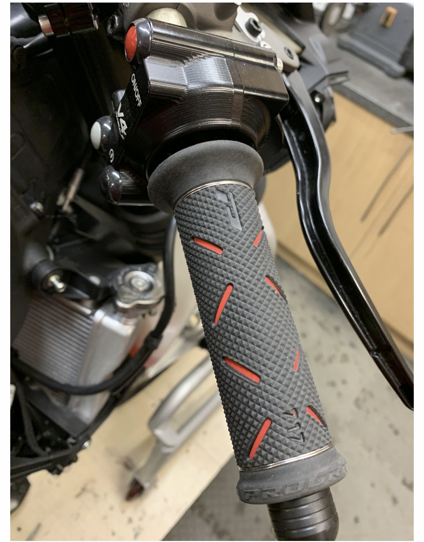

  8. Little update on the MC install.

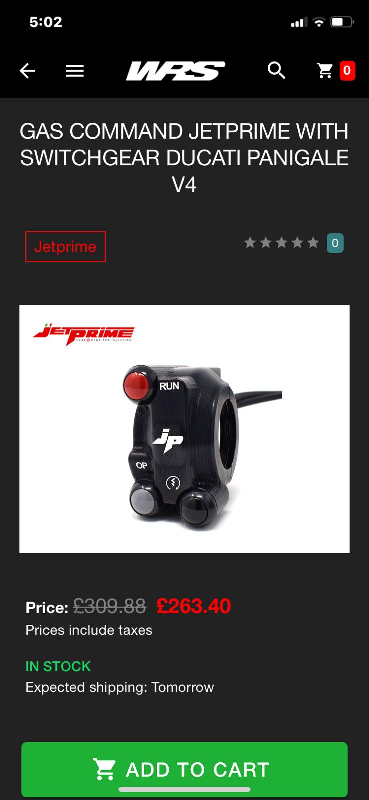

    The Conta CORSA will not fit on the bar with the throttle and the kill switch so need to remove kill switch and get a jetprime space saving kill switch. More money .
    All being installed tomorrow so wish me luck CF64C718-A593-440D-B80D-EC9156A2048D.jpeg 6038A406-775F-42A2-A581-B3715AF82939.jpeg

  10. Went for the 19 but will run it on the 18 setting. Three of my friends have V4’S and all run 19. 2 have deleted the ABS and 1 hasn’t but all advised to go for the 19.

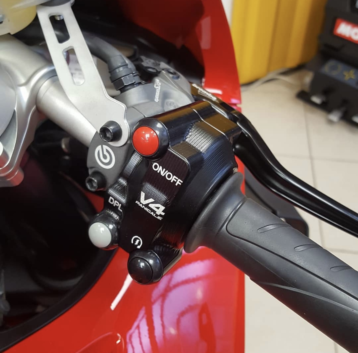

  14. Brembo conta corsa RCS19
    Jetprime Gas commander
    installed...
    Have ridden it yet so will update you when it stops raining and I ride it. 61D0A3C1-A787-4603-8364-1560B3787396.jpeg

  17. You’ll still have a bit of play for thirty quid or so get the jet prime one ... no slack!
  18. I used these...
