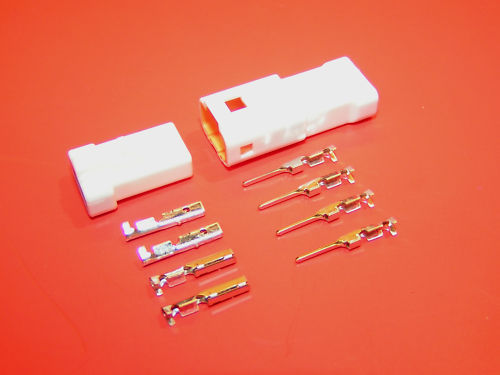

    For848/1098 just need Superseal connector.
