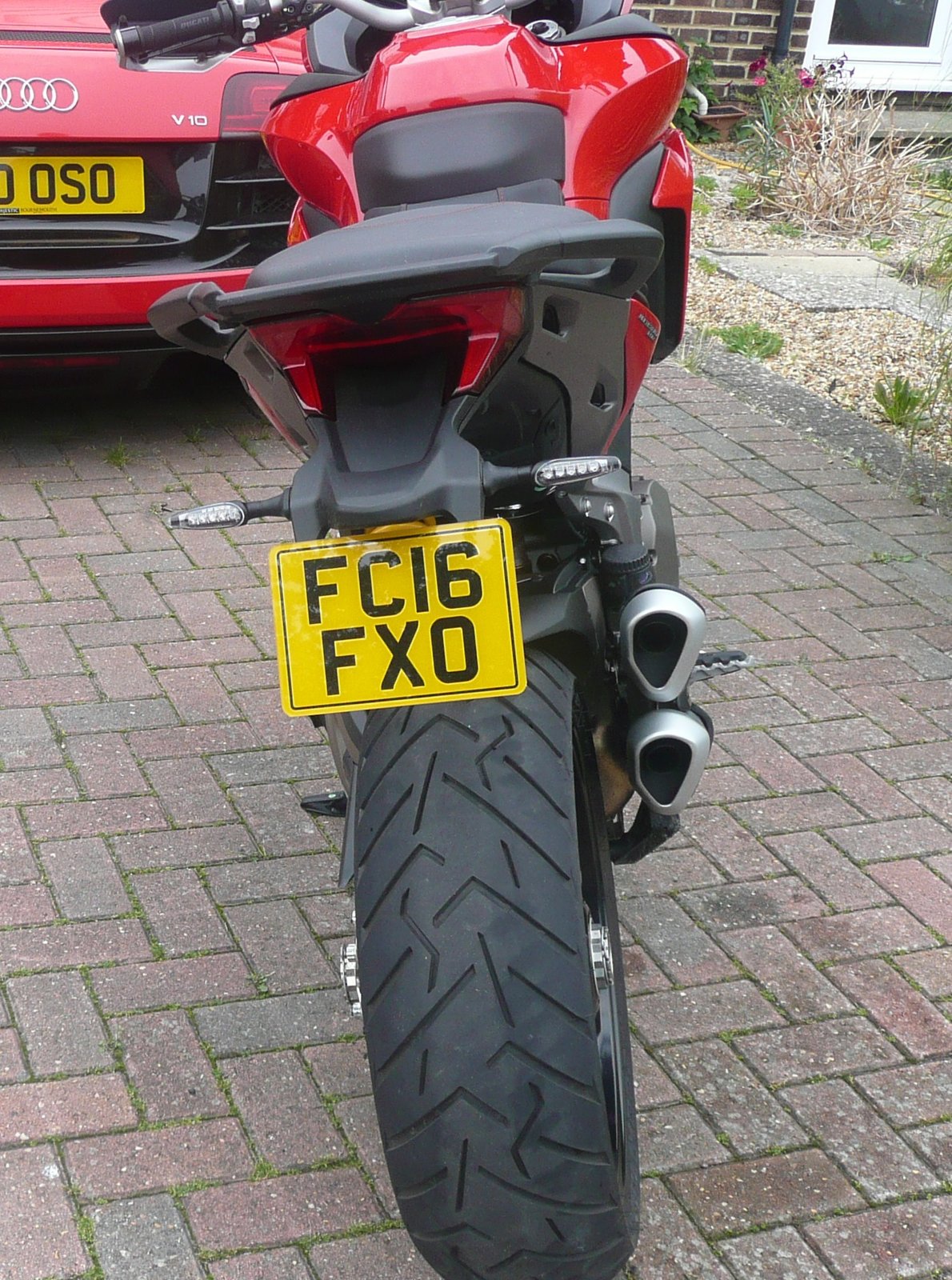

  7. How did you get your number plate to stick?
  8. Velcro so it comes off easy :bucktooth:
  9. Halfords sticky plate pads, the thicker 4mm ones, on a small aluminium back plate that I made. :upyeah:

  11. Im likeing the look of the bikes without the rear guard.
    How bad is the spray in the wet?
  12. Dreadful. I live a mile up a dirt track, in the sunny Scottish Highlands. Left the guard off after adjusting the chain. Never again...

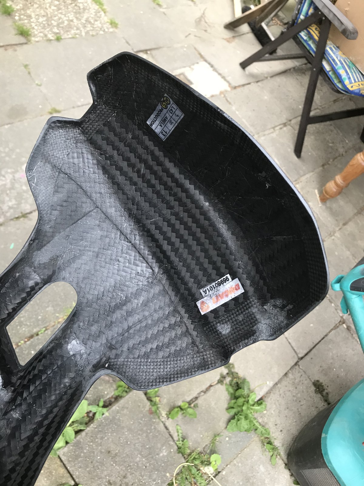

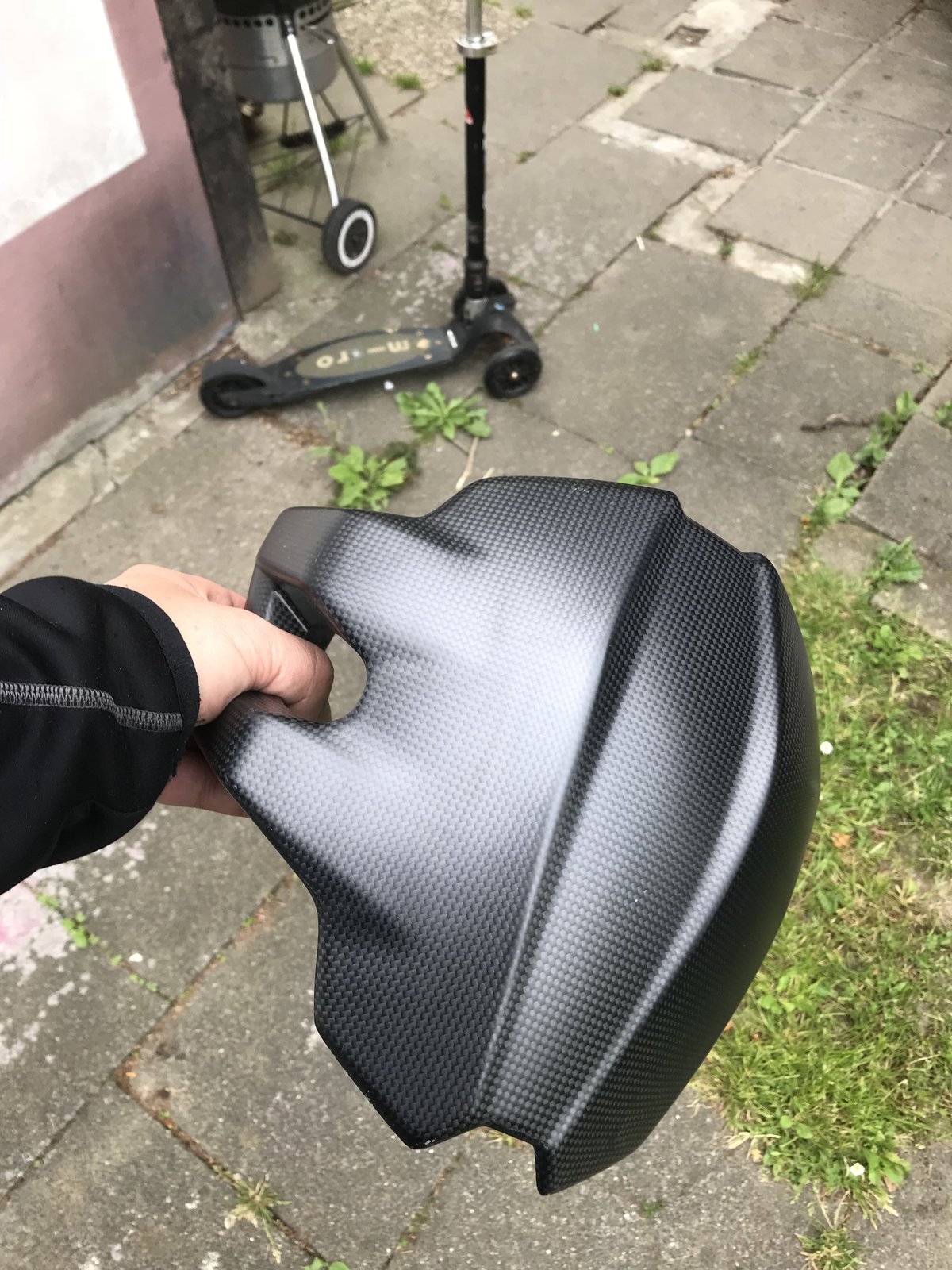

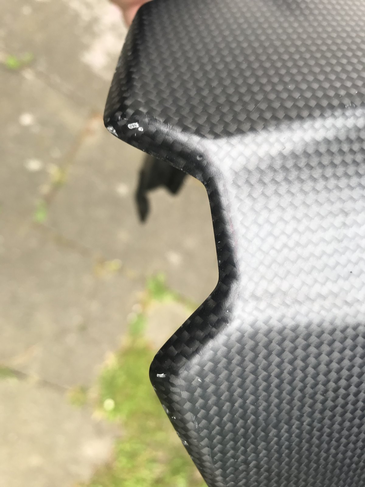

  14. Stretta, ive got a satin dp from a Pp14
    - pm me a reasonable offer and it’s yrs mate
    Pics: 03FCF5BF-483D-4220-9831-4CC2A3A602C8.jpeg 74AD2007-894F-4B9D-8498-1ABA30CAA823.jpeg 56AB2FB1-4843-486A-A550-A778239DF451.jpeg
  15. Iirc aircon and a few others have had the same. The fact you have a large scuff and this would suggest maybe a thick branch has been rub over, caught in the carbon shield and damaged both.

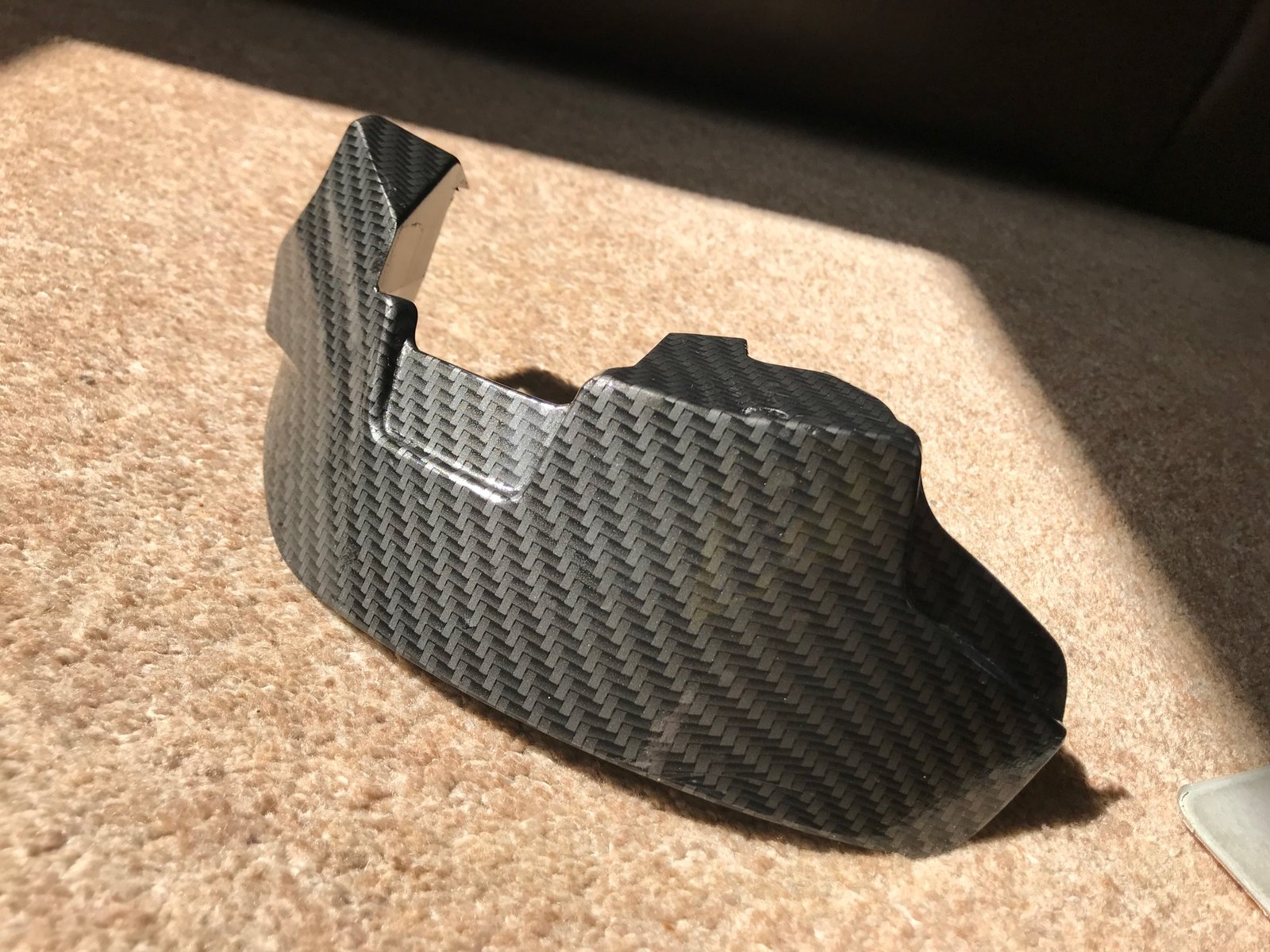

  17. 56F70827-9C26-4312-B5C6-9CD8D36DA89E.jpeg My crud catcher is no more.
    I removed it and cut the two parts leading to the rear, this left me to grind down the original chain guard which left two holes where the catcher mounted. I plastic welded this up and smoothed it down and used some modelling filler as well until it was really smooth. I then hydrodipped it with carbon fibre film and gloss lacquer on top. See attached pic and it tidies the back end up nicely.
