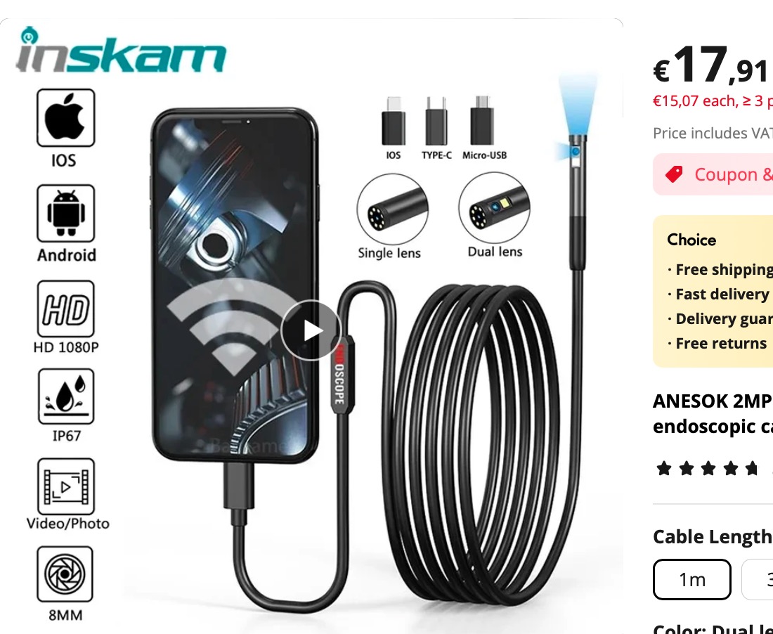

  14. Scherm­afbeelding 2024-07-21 om 14.17.15.jpg Buy a 10 bucks endoscope camera from Ali or Ama that connects to your phone, inspect the pistons via the spark plug hole.
    No damage? No need to take the head of.
    With a dual lens version you might even be able to see the valves.

  15. Really good idea, make sure you do your research though, as the poor models have a terrible picture quality. (So bad that you can't really see if there is damage or not)
