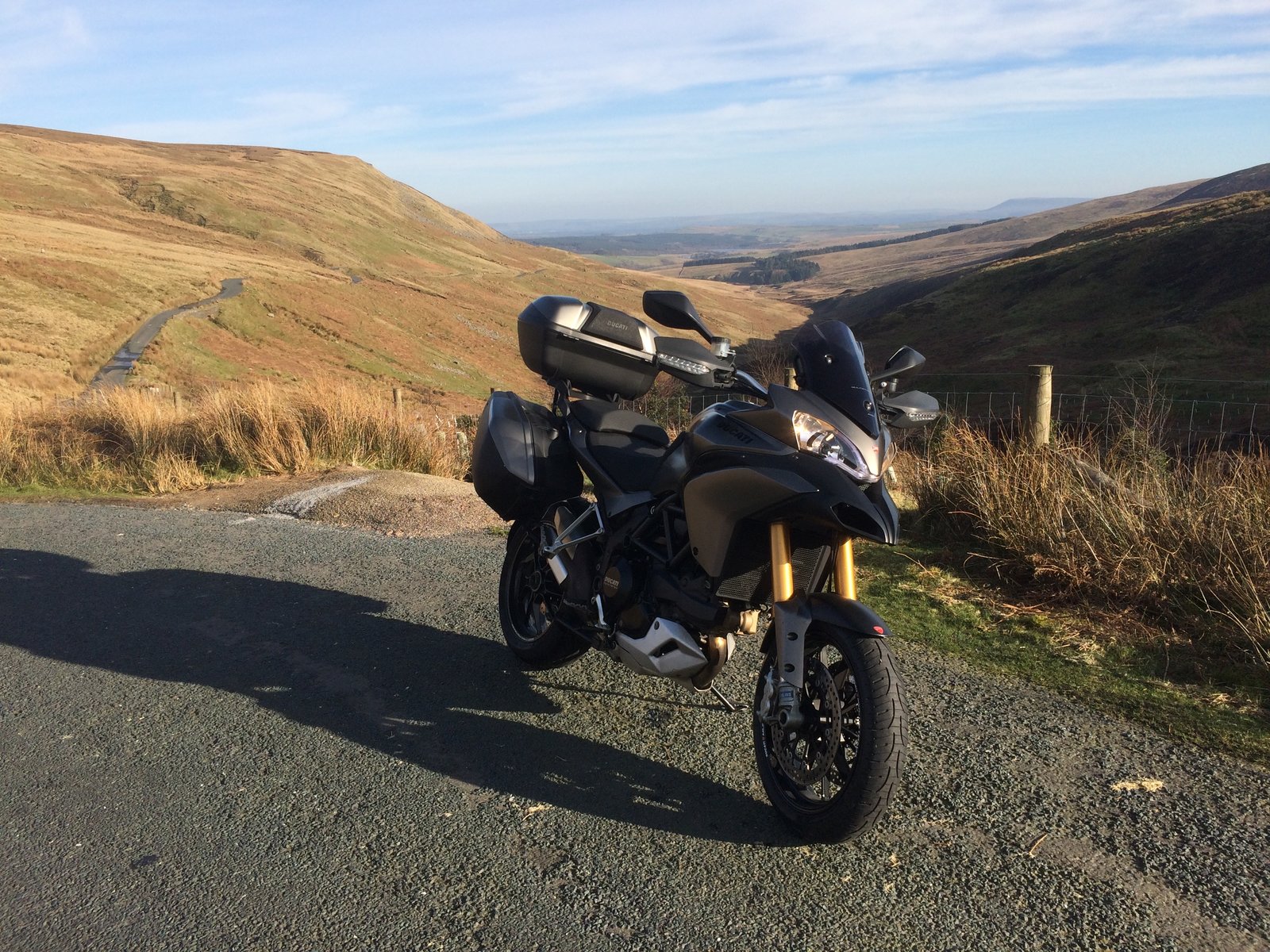

  3. Had the same noise & buffeting problems with my 2011 MTS 1200, fitted the Puig racing screen last year which did make a big improvement over the standard screen but still more noisy than the 749.
    I have just fitted the Eagle Screen wind deflectors which I will try over the next few weeks with the Puig and standard screen and let you know if they make a big difference, not tried spacers yet but may give them a go if wind noise is still excessive.
    Photo before deflectors fitted.

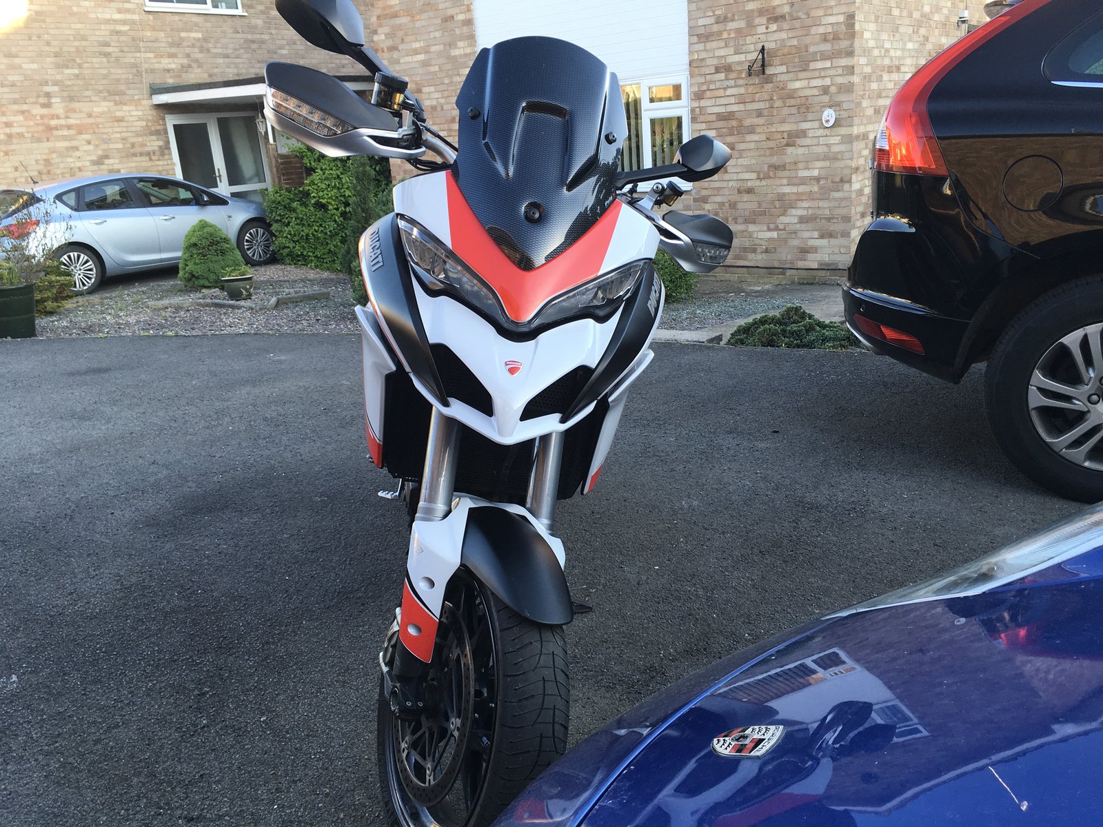

  5. 571EC946-6E64-4132-B553-9ED42DB04F51.jpeg As much as I love the look, I am going to put my std one back on. It was fine yesterday in the smaller mountain roads but once we got on the big sweeping ones it’s constant. Can’t remember the big bin lid being that bad, just a bit more buffering which could be cured by going al MGP and tucking in a bit.
    Shame tho, the black screen looks fab
