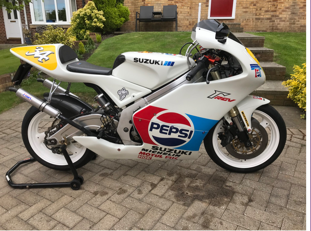

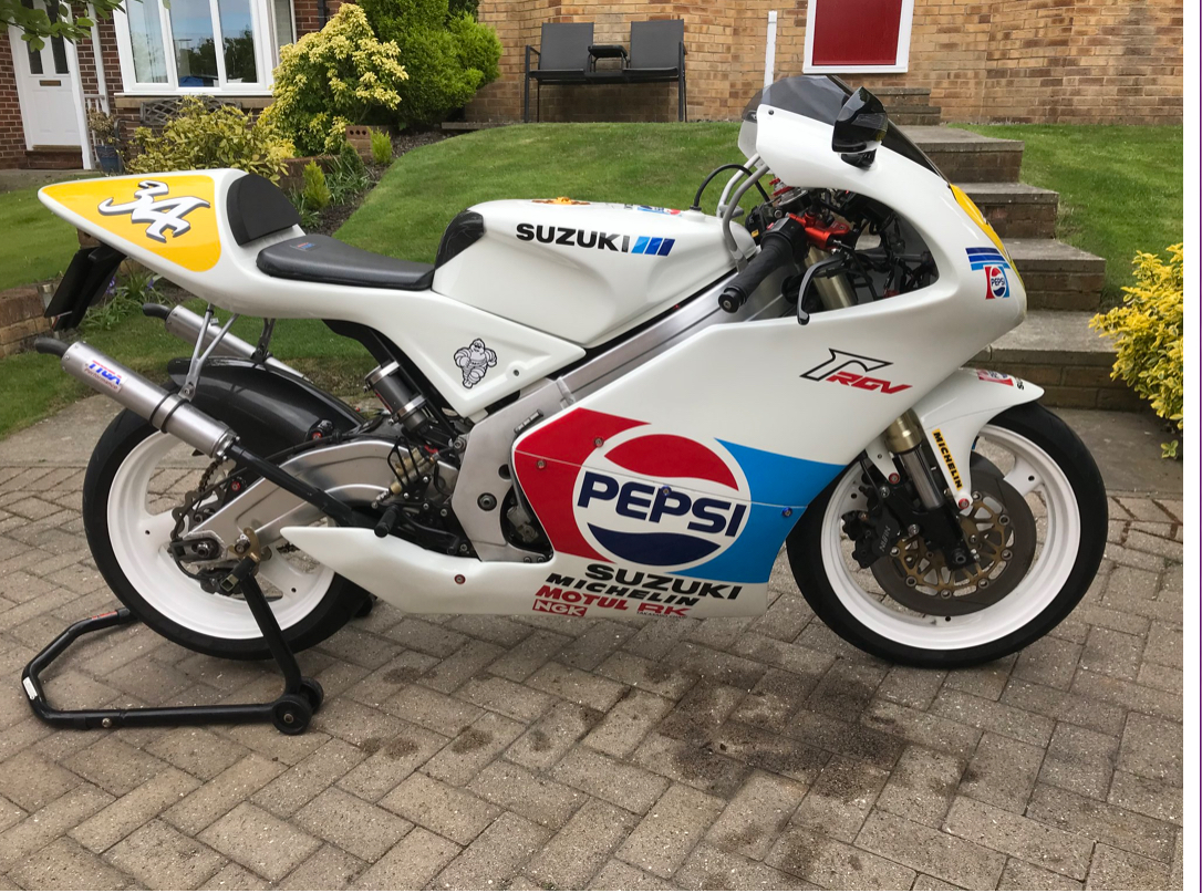

  1. that’s exactly the look I’ll be going for, only that I don’t have the banana swing arm on my one, and I hate the Pepsi paint, in might go something more traditional
  2. Personally I like white or red

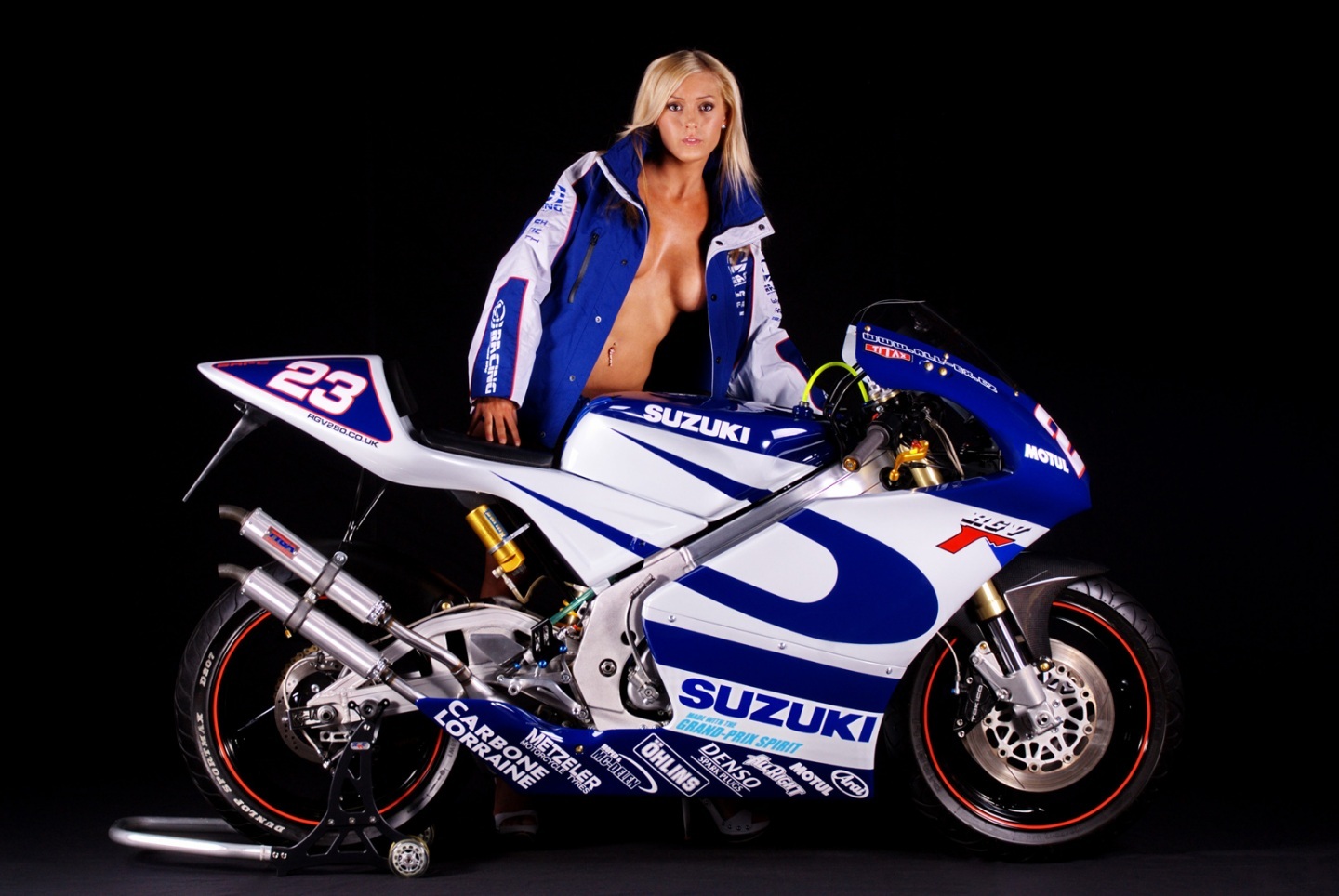

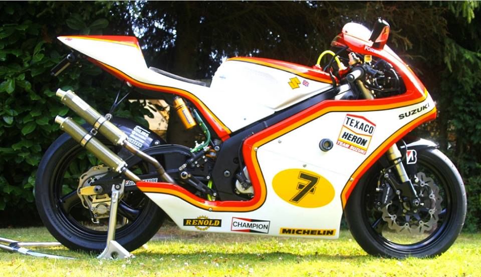

  3. Some ideas, first one but I wouldn’t put all the sponsor logos on, just a clean Suzuki paint code. Or the second one, as it has a black tank and leave the front fairings standard and match to the tyga rear

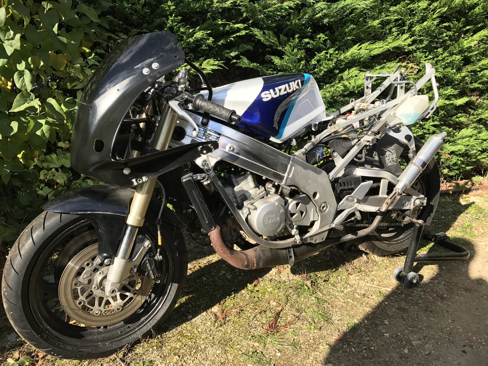

    this is the bike right now....

  6. Thanks mate, yeah I'm going to order an engine stand, get the engine out as a priority and take the heads off and see what's under there, and then get it to a professional to split the bottom end and inspect and rebuild the crank. The last time it ran was 2015, the time before that was in the 90's.
    I theory it's got super ported barrels and flat pistons etc as there are no base gaskets or top gaskets, so the crank may have been balanced, but I want to the engine to a point where its sorted and tuned as a reliable road engine and then worry about everything else, I need all sorts of road parts like oil pump stuff, and need to find some 34mm carbs as it has 32mm ones with it.
