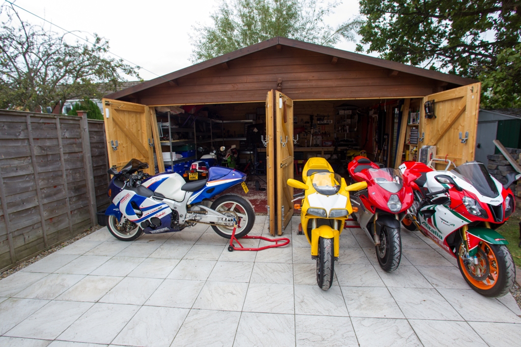

    I use halogen heaters for instant heat when working in the garage and I use my front garage for up to two bikes on the road at any one time - so my usage profile is somewhat different I guess.

  5. I would also consider maximising the size Vs current regulations as you will always need more space and the additional cost is small in relation to size gained in percentage terms. When I did mine the max permissible without planning and regs was 30sq meters: mine is 5.4m x 5.4m to suit this regulation.
    The height if within 1m of the neighbour was 3.3m max at the time, I think this regulation has reduced to circa 2.9m now although it may vary around the country.
    Have you checked the legal side of things?
  6. I can't really say I much prefer my rear garage to my front one now, but I do :Wideyed:
  7. At least.
    I paid £2050 for a 18' in Sept 2011, delivered.
