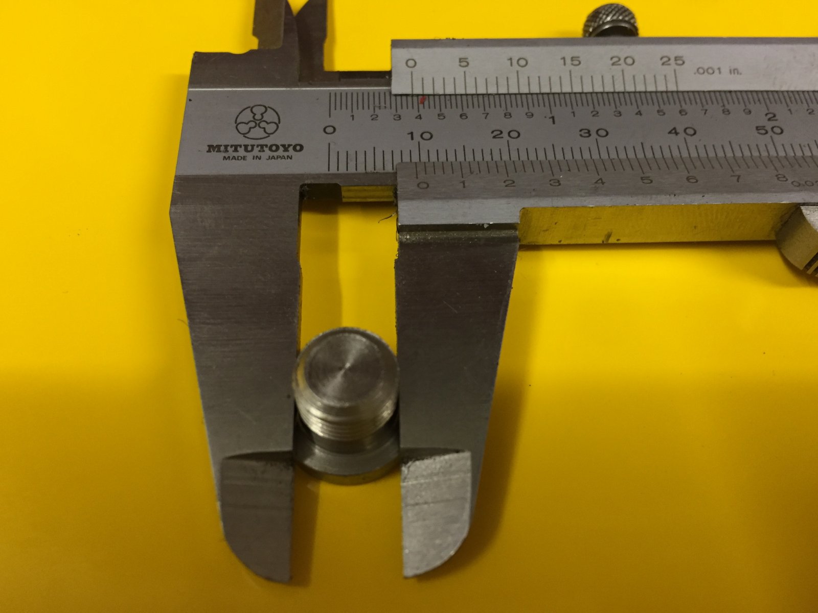

  1. Take off point for the screw in tool to measure CO gasses part number 78020011a
  2. Surely the garage can tell the part number and therefore measurement. I'm at home so will nip out to the garage and see what I can see.
  3. This is the image from the seller of the pipe. You can see a hole above the rubber part that presses against the fairing.
    img host
    The pipe came with a Lambda which i plugged in, but i seem to think that is on the rhs of the pipe, which is out of shot on the above (still plugged in in the picture, which is what the black wire is). If that is the case, what goes in the hole that can be seen?
    Or am i wrong and the Lambda goes in that hole? The 18mm plug apparently is too large for that hole.
  4. Thanks mate, that was a handy link.
    That little bolt has cost me close to £300 so far. Crying into my cornflakes as we speak. :(
  5. Not good mate, really feel for you.
    PS, does not look like there is a separate part for it. If you download the parts diagram there is nothing there. You may just need to grab that bolt off another pipe or just find a bolt that fits and locktight it in.
  6. It's possibly a gas take off for the DUCATI diagnostic kit. From memory these are a 1/4" BSP thread.
