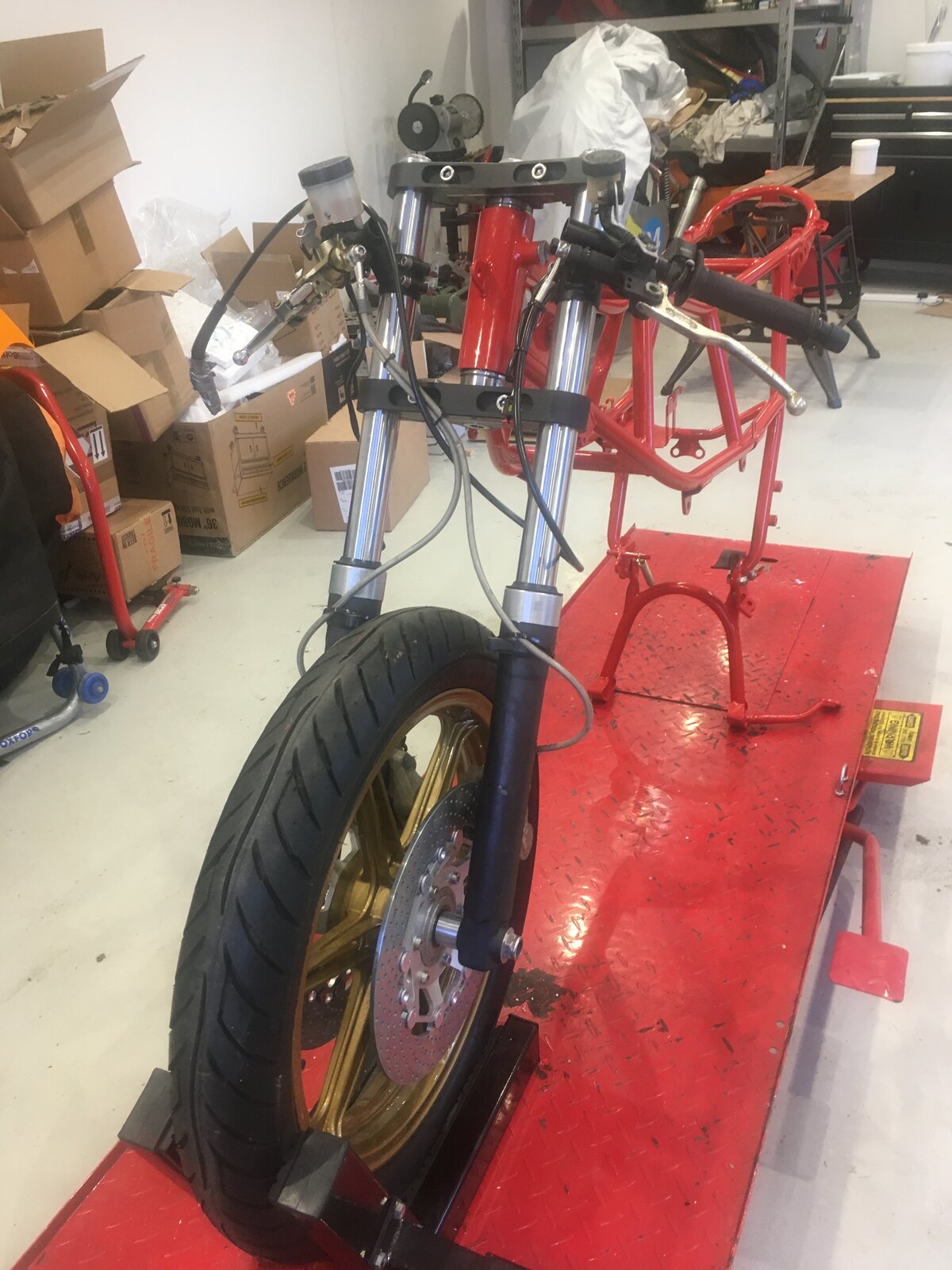

  6. Meanwhile, back at the main project. Front end built up an I now have half a rolling chassis.
    re-plating some of the special fasteners that are no longer available.

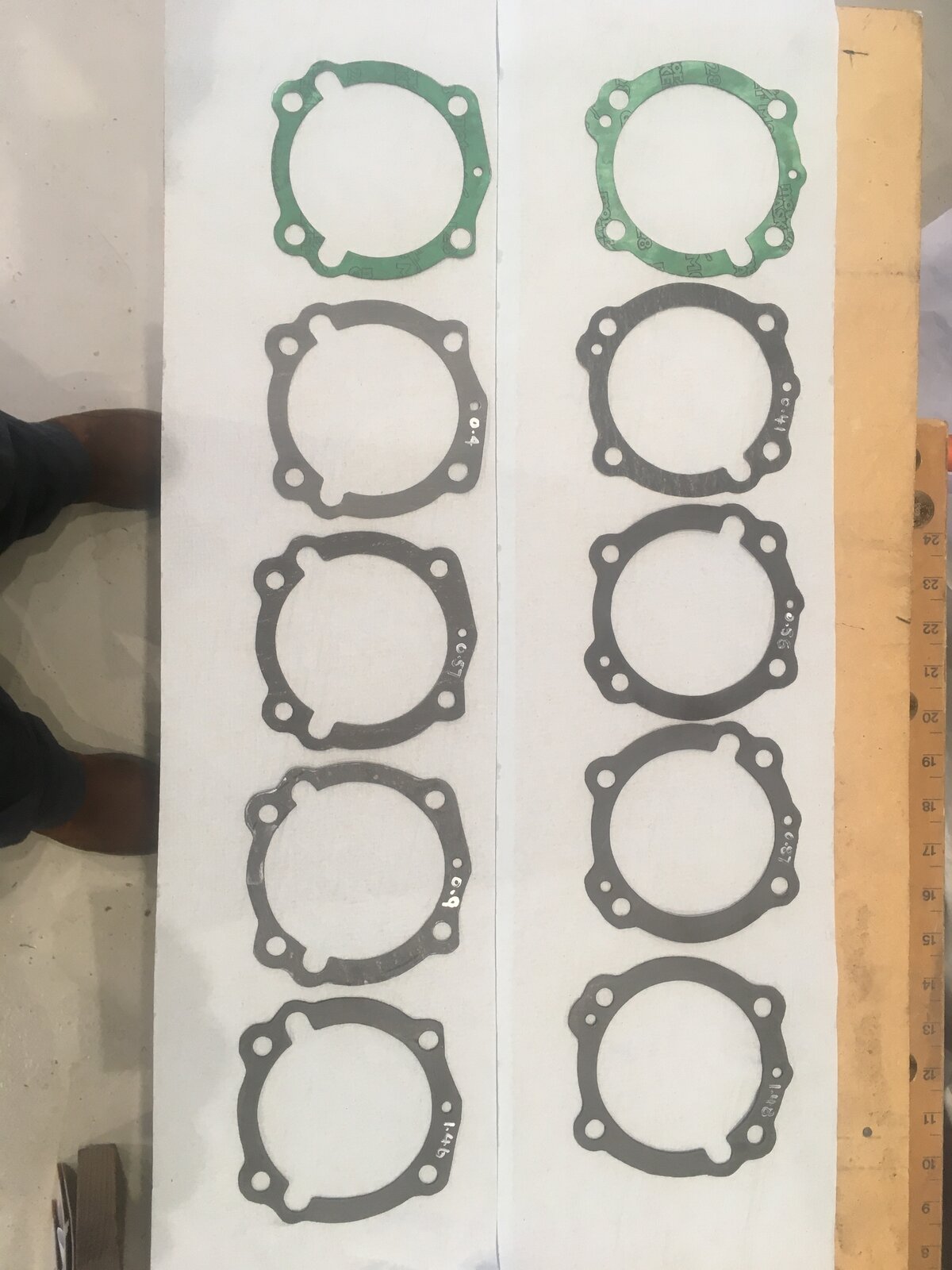

  15. New Carillo’s and Omega Pistons are slightly different to standard so I need to adjust piston-head geometry to achieve a 25thou squish band. I’m going down the base gasket thickness route rather than machining the piston. Two reasons, first I’ve had the crank balanced (Andrew’s Precision) so I don’t want to change the piston rate. And second, gasket is reversible.adjustable for the future. I’ve knocked up a range of gasket thicknesses so I can get the squish right using plastigauge. Any recommendations from anyone who’s been down this route before is very welcome.
    interesting that the two ‘Athena’ gaskets are different thicknesses, one @03mm and the other @0.5mm.

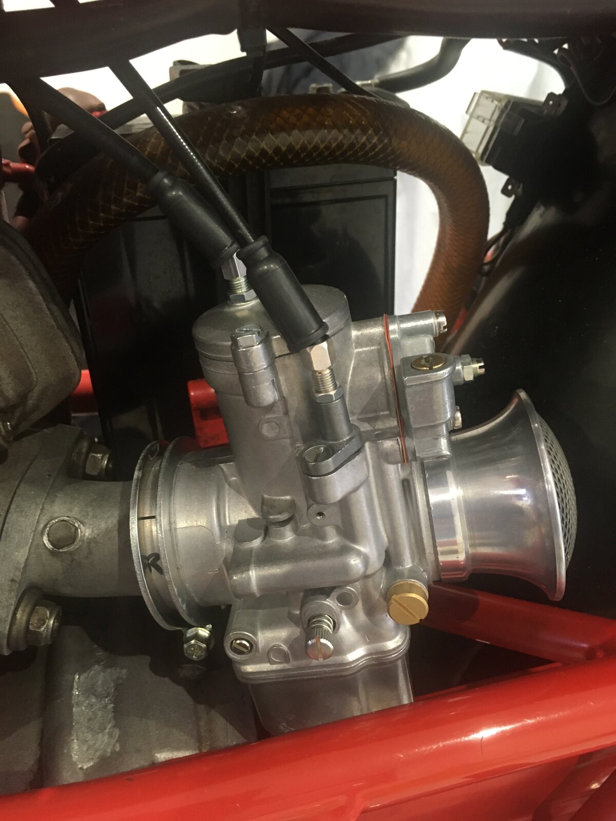

    carbs back from ‘Ducati Paddy’
    Great service as always. Look like new with Flip Top chokes.

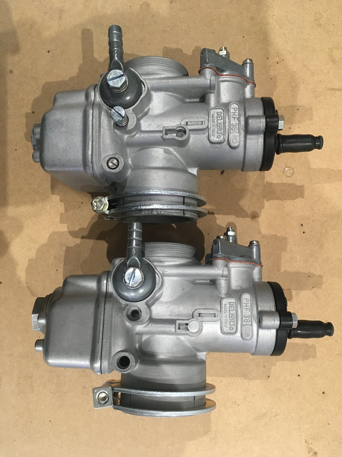

  18. I see you're carbs are 36mm, we used to run 40mm on 750 pantaha.
  19. Good tip, thanks. I’m new to old school Ducati’s. I’ve a long list of laverda’s but have dipped my toe into this project so I’m doing a lot of experienced guessing.
    I have build up the engine with new bearings, seals, rods, balanced crank, pistons etc so am hoping that I’ve sorted a bottom end that will not need any immediate work.
    I suspect that a lot of performance (other than the extra cubes) will come from Head work. At this stage I’m using standard heads so think the 36 PHF’s will work best. I’m starting with 140 mains and 50 pilots so probably soft and under fuelled for the extra capacity? I’m guessing here so any advice gratefully accepted.

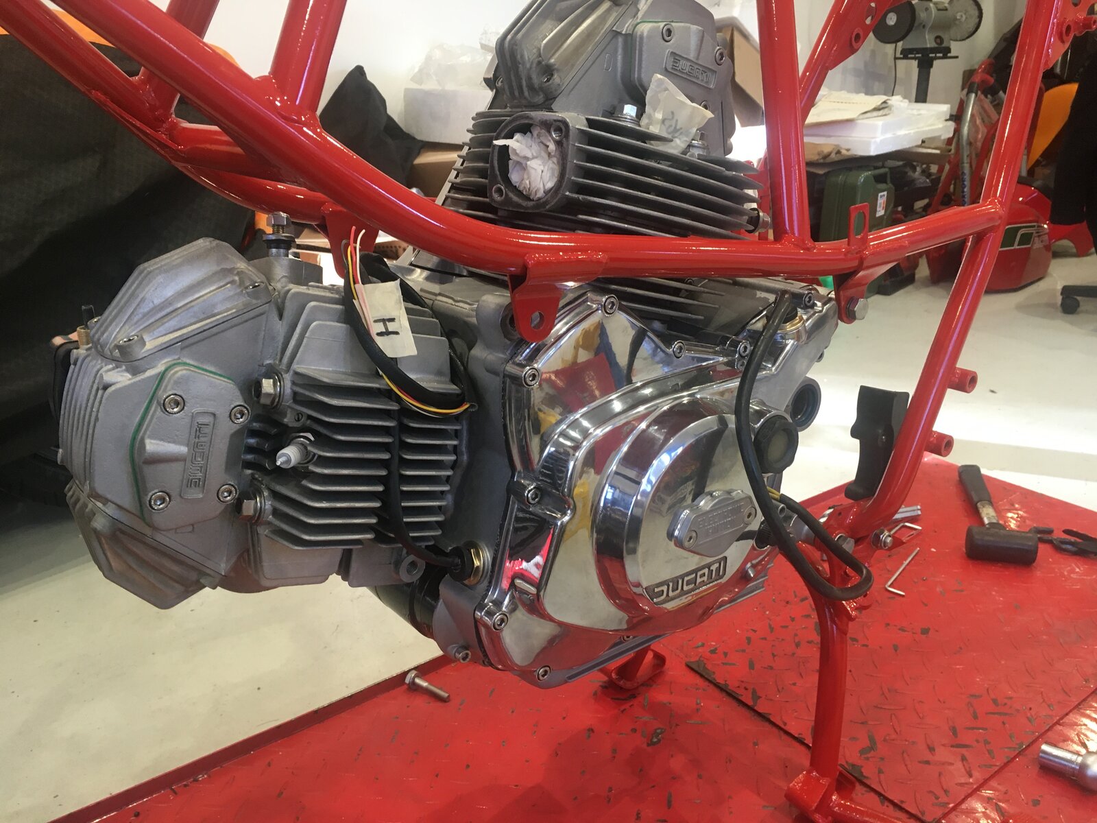

  20. Engine nearly in.
