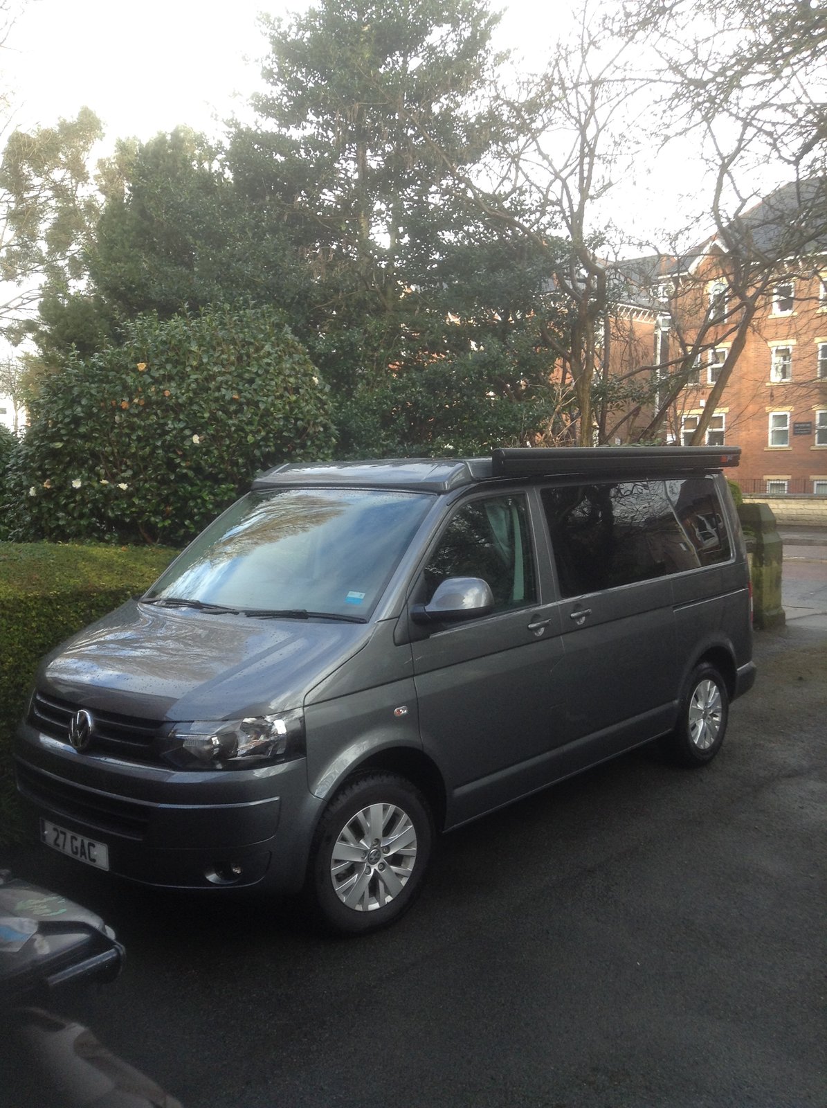

    I 'invested' in one a couple of years ago, bought a VW t5 donor van and had the conversion carried out by Leisure Drive in north Mcr
    Whilst the term investment is in inverted commas, it's true return is found in ownership and use. Bit like having a bike, only different and slower, a lot slower!

  14. Are they a simple like for like replacement?
    I'd like to replace my standard ones without lowering or having to use spacers. image.jpeg
