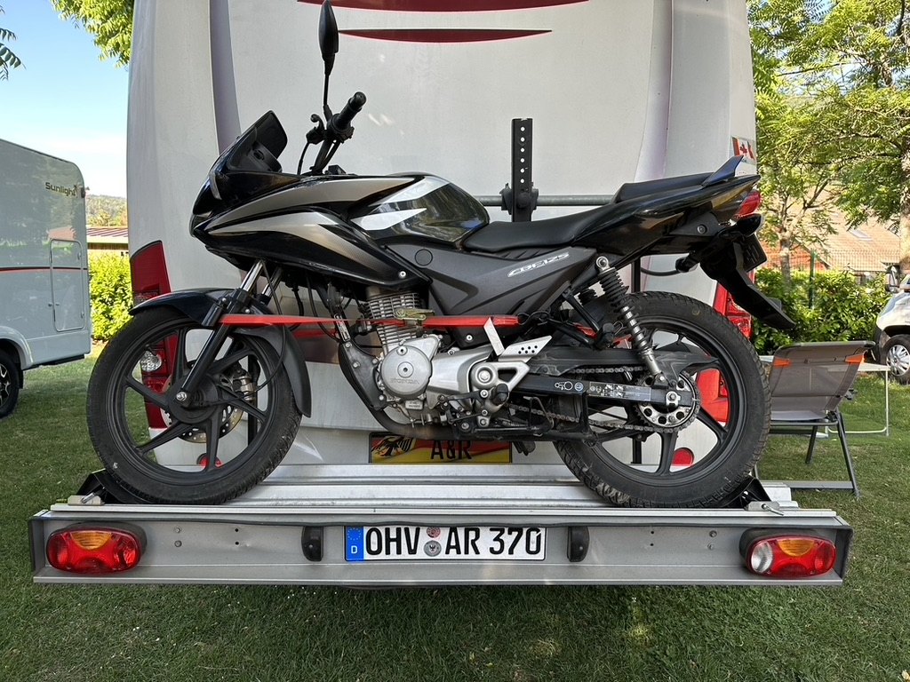

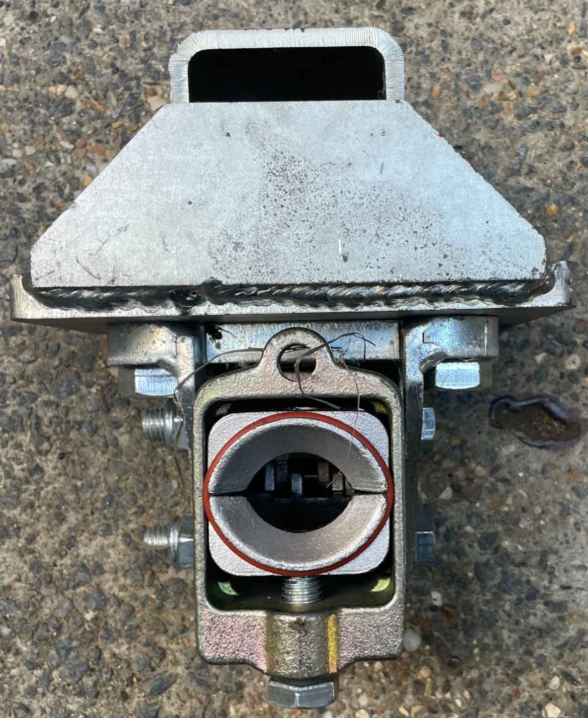

  1. I wonder what the rating of that towbar was, it looks very thin walled RHS. Both mine are very different to that, the receiver/Ball hitch are bolted with two M16 bolts to a piece of 10mm thick bar.

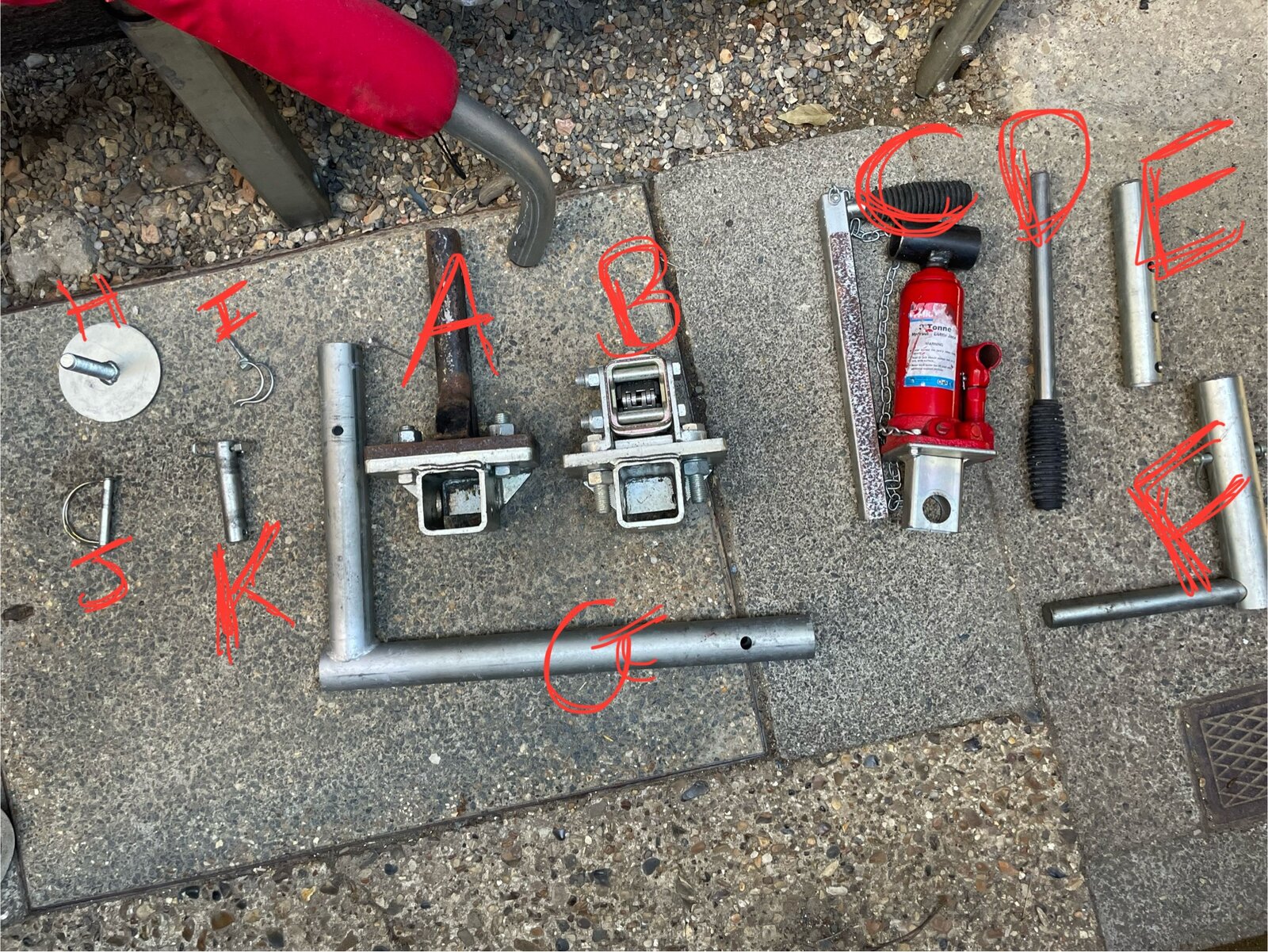

  2. I'm considering getting one of these now, but I can’t find any info about whether the trailer can be towed safely when empty, ie: without a bike loaded.
    The reason I need to know this is because my motorhome is parked on the road and although I have use of a garage it’s not very close to where I park it. Hence, I would want to leave the trailer permanently attached to the back of the motorhome rather than breaking it down and storing it away between uses.
    Any info about that would be gratefully received. Thanks
  3. that’s a good question, I suggest you phone the guy who is very helpful.
  4. You should not tow when empty.
  5. Can you lock that cantilever mechanism to eliminate the up/down movement and then leave everything in situ, minus the wheels?
    Thanks
  6. No pretty sure you can’t, it’s been about 6 years since I sold mine, so my memory a little hazy.
    I certainly would not use or buy another one, unless it was a small bike / scooter and the van / motorhome did not have chassis extensions

  8. My mate has a very similar rig to this. But he says it drives like a right shitter with the rear compartment loaded. You can see how it will impact steering and make it all ‘floaty’

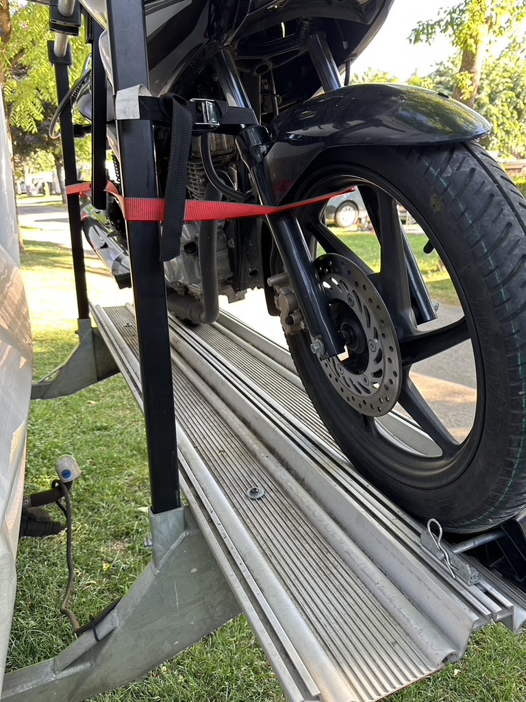

  10. I saw this set up at a campsite in France a while back.
    It seemed to work well, but I don’t think the setup would cope with a much heavier bike.
    Carrying weight at the back end can really unstabilise the vehicle.

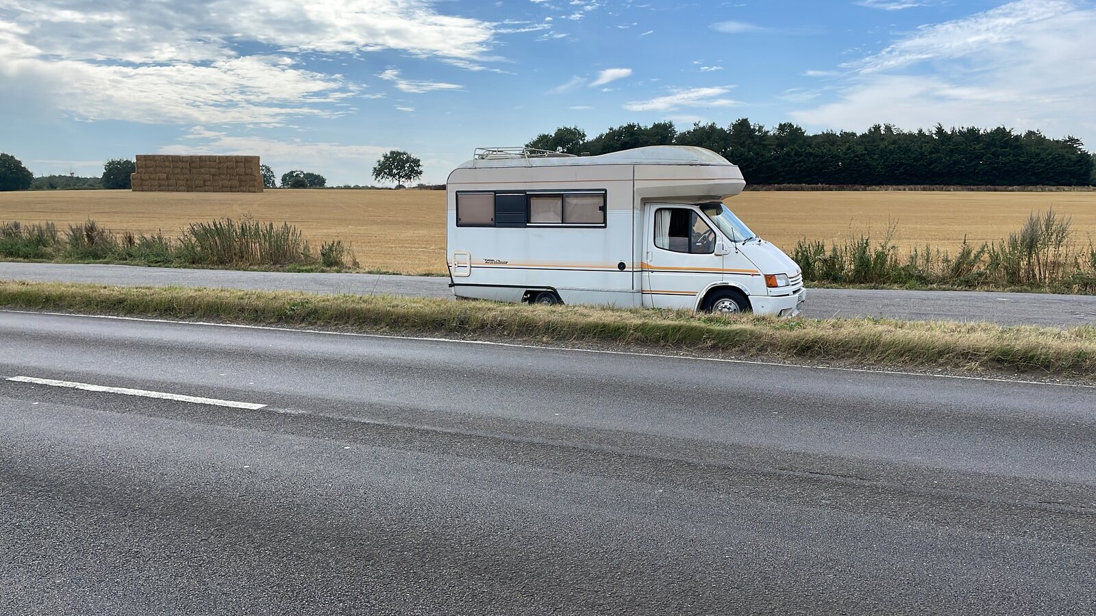

  14. What motorhome do you have ?
    Mine was 7.3m with a big rear overhang, I think the chassis extensions were over 1m.
    I ended up using a normal trailer and never had any issues, just need to think ahead and avoid reversing. But with a normal trailer and even a 250 kilo bike you just unhitch it and push it.
    I had a reversing camera on the MH and found I could do straightforward reverses anyway, after a little practice

    It’s a 1990 Transit diesel Travelhome, aka “The SuperSonic Shed”
    I found an Easylift Hydra Trail on the Bay of E for £900, ie: less than half price, so I decided to risk it for a biscuit and if I don’t get on with it I’ll just resell it.
    Thanks for the advice everyone and apologies to the OP for hijacking your thread o_O
  19. That’s probably got a proper strong old towbar so with a light bike it’ll probably work fine.
    Just make sure the castor bearings are greased well and properly tensioned
