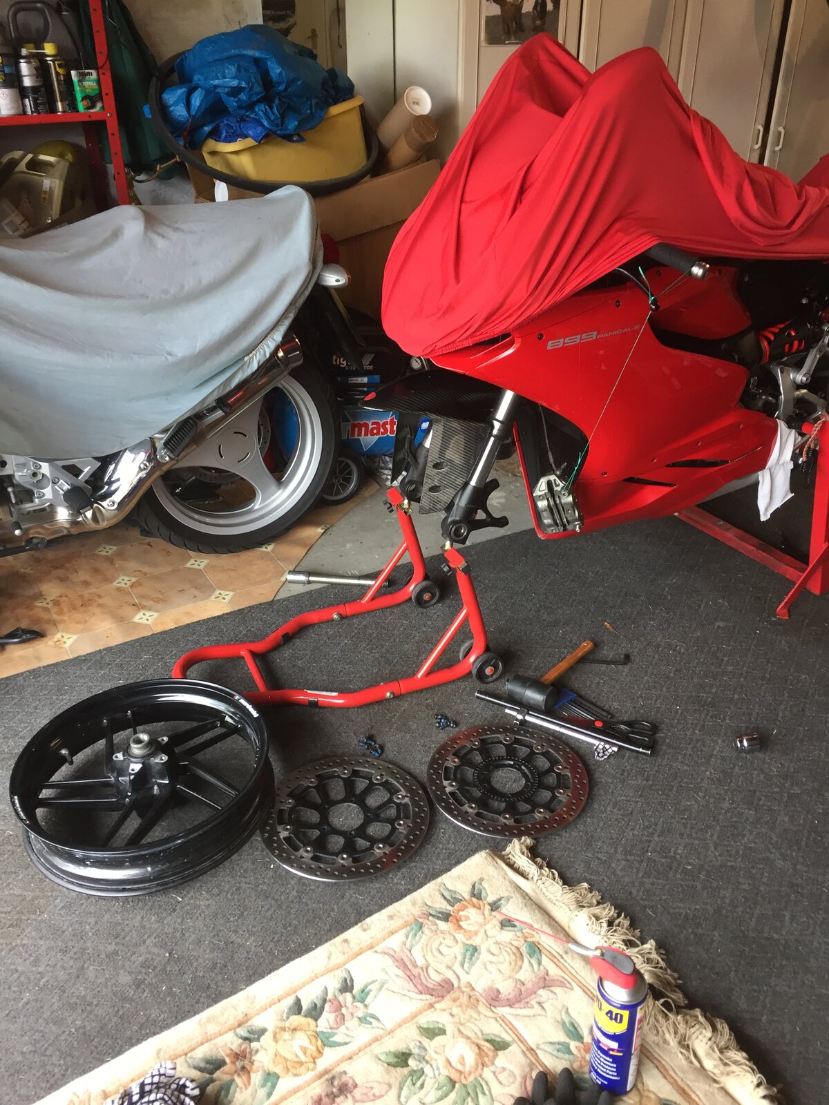

  4. I should have twigged this before I started, as Nelson said,…factory threadlock,…the bas#@* !!
    Reminded me of when I rebuilt the bevel drive on my old BMW, the BM threadlock was mega strong, a right bloody chew on that was!

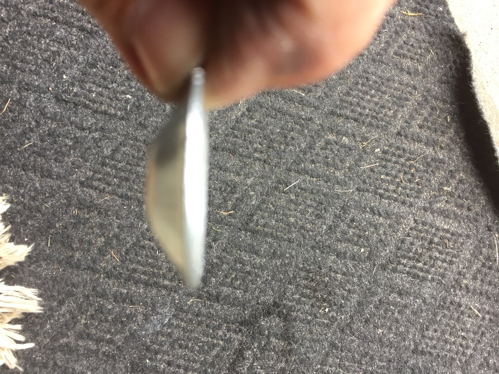

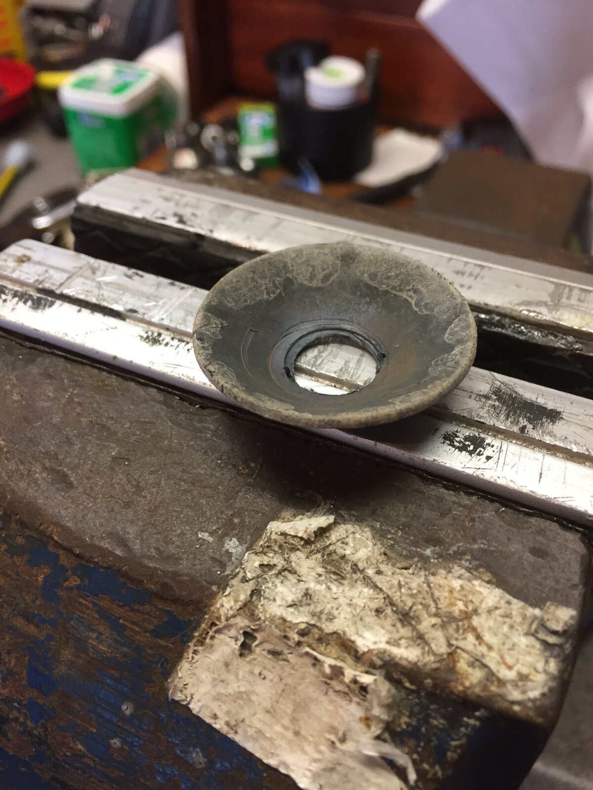

    Needed heat and lots of it, so I made a kind of heatshield deflector out of a penny washer by dishing it and opening up the hole to suit the screw heads, thought this would be the best way of directing the heat and saving the paint on the discs..

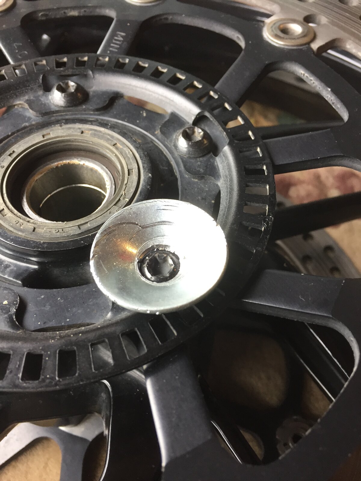

    Fits over there nicely…

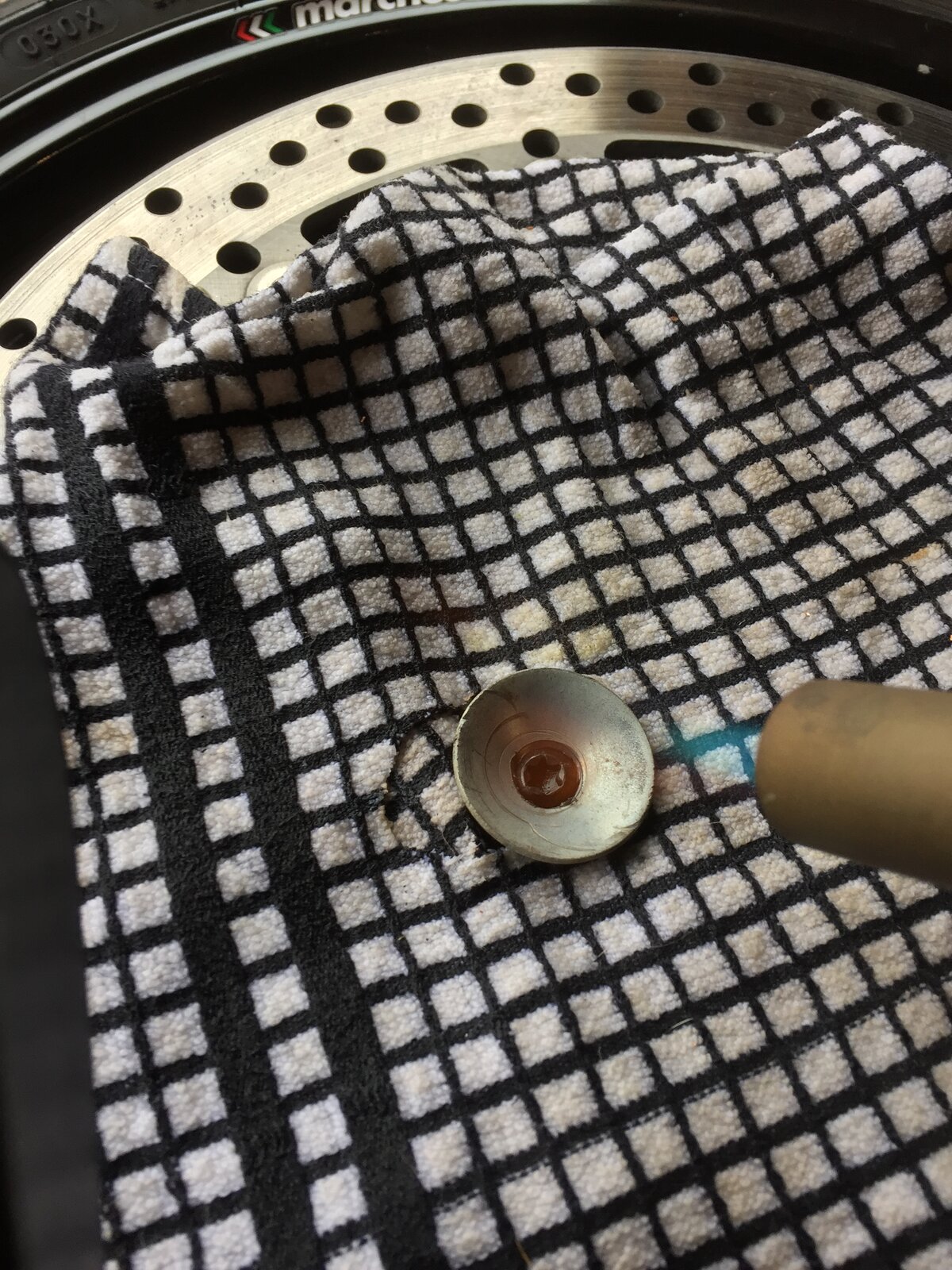

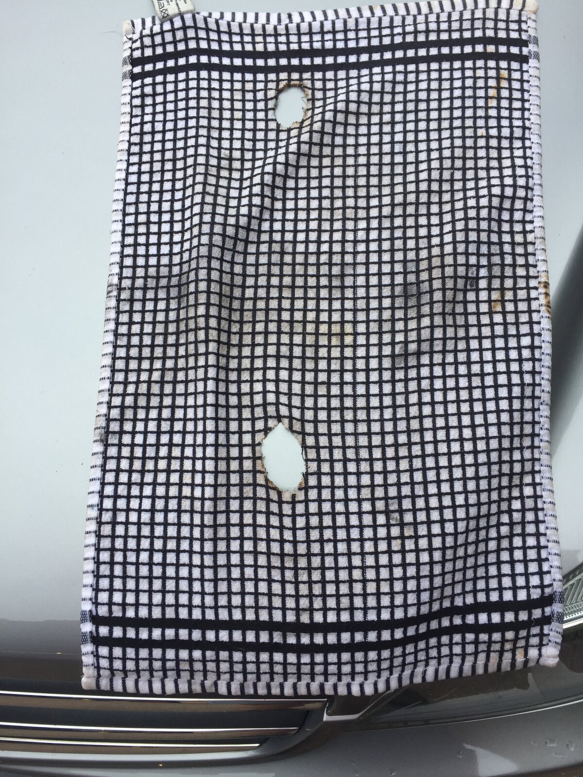

    Next step was to take the wife’s best tea towel, fold it double, soak it in cold water and cut a hole through both layers so just the screw head popped out …and give it some gas !

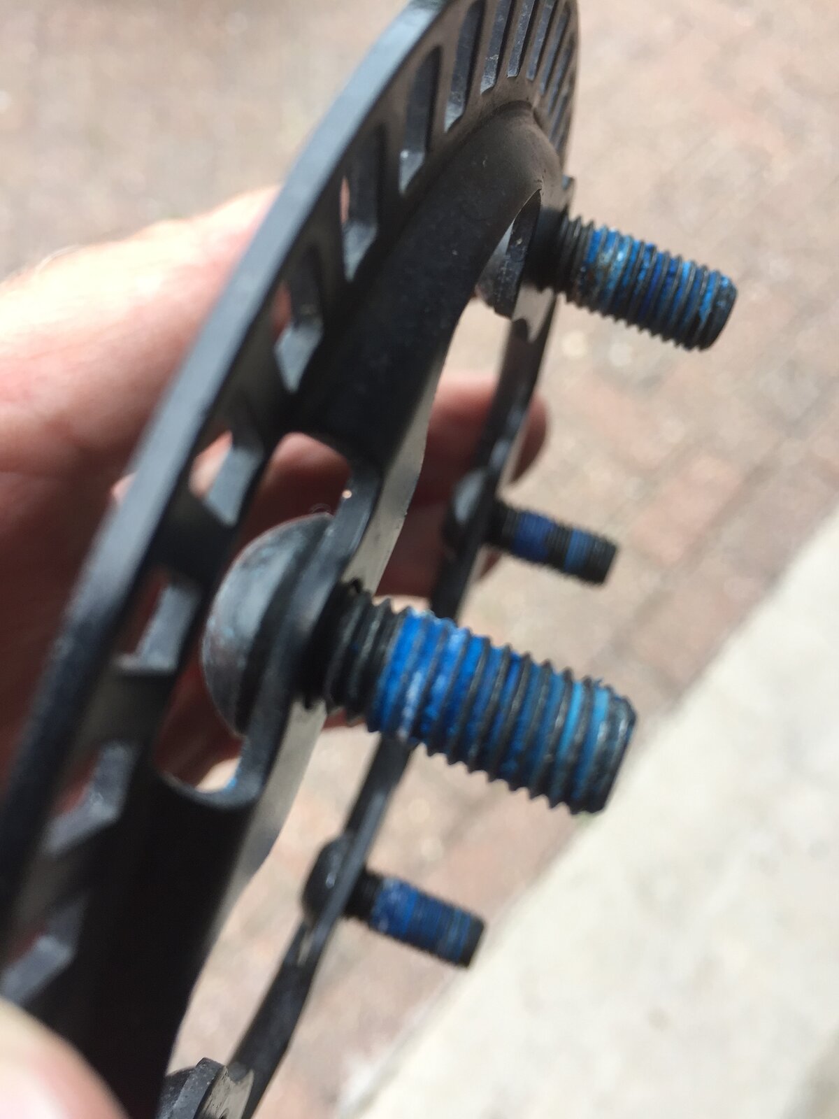

    I didn’t find the impact driver very effective tbh, After 2 or 3 screws I found the best results were by using the gun on the screw for a good 3 or 4 minutes to get LOTS of heat into it, then putting the Torx socket in and giving it a good whack, letting the screw soak all the heat in and then once the Loctite had loosened it’s grip gently turn it out, keeping it moving all the time so that the Loctite didn’t get chance to set again .
    Certainly plenty of Loctite on these buggers!
    Job sorted !

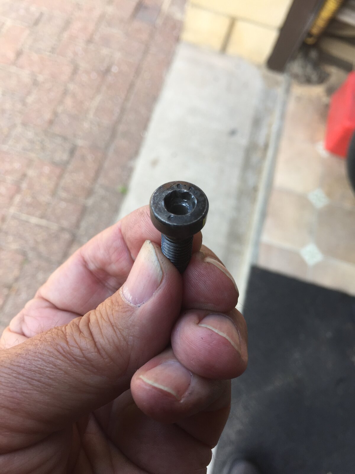

    Funnily enough despite not having Loctite on them, the rears were worse to get out than the fronts, mainly due to them being Allen heads but dead shallow engagement and made of cheese, I didn’t push my luck with these, so I just took the 3 off that holds the abs ring on as I was running out of gas by now , I’ll buy some new stainless ones.
    Worked a treat this thing did , it’s seen more heat today than a Saturn 5 ceramic tile :D !
    I’ll just hang the tea towel back in the kitchen,..she probably won’t notice anything :thinkingface: ?
    Thanks for the suggestions guys, relieved to get them all out in one piece :D :upyeah:
