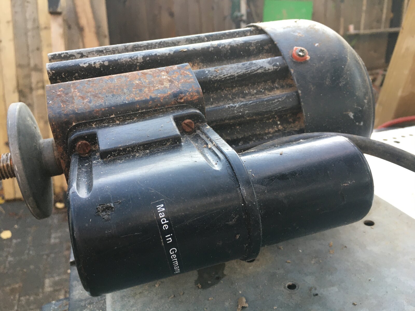

If someone could help please.. I was given ‘this electric motor by the Wife of a late friend of mine.. I know it worked recently, it was used to power his table saw.. I would like to use it for the same use but, unfortunately his brother cleared my friends workshop etc and just took the cable out and threw away a switch of some kind that starts it.. So I’ve a German motor with no plate on it we know it’s a good runner but have no idea what to wire it too. he was running it off 230 volt household supply but when we tried it it tripped the electrics on the house.. So I’m guessing I need some kind of relay or switch to cope with the power of the motor on initial start up... Can you help please .. cables appear to be 2.4 mm ish thick and it’s twin and earth.. X NOODS

All our saws and most of the industrial stuff i own has a 2 stage start up switch so the blade doesn't start instantly, that screws the belts and pulleys not easy to find the rite switch ! Do you have picture of the machine ?
