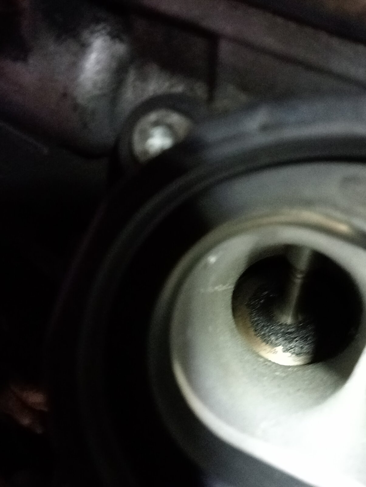

  6. just removed the airbox to check the injectors and found this on the valves. can you recommend a cleaner to use with a small wire brush. . IMG20250308175411[1].jpg

  8. recently i unplugged the PC ,but the bike ran worse. same question again, can you recommend a cleaner or just using a dry wire brush
  9. I'd leave well alone. You don't want any of that in the cylinders. Only way to clean the valves is to have the head off and stripped. The carbon build up won't be causing a problem.
  10. Ok thanks, I will use some cleaner in the fuel
  11. hopefully i have found a few faults after removing the airbox that has solved the problem. the plugs and airbox were dirty due to an oil breather plate inside the airbox being loose and there was a small fuel leak on the front injector. i thing the bike was dropped while being worked on before i owned it and the plate became loose. other small marks on the bike suggest this. the bike is still a pain to start but it is idling ok now. only time will time when i give it a good run when the salt goes away. plus i will put cleaner in the fuel for the valves. thanks for all the input. IMG20250308175843[1].jpg one thing i forgot to mention, the new connectors from the reg/rec to the stator/generator gets very hot while the bike is running.
