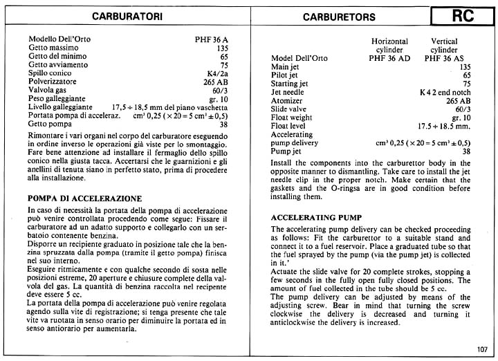

  7. Please see attached
    Please note the needle is a K4 with the clip on the 2nd notch ( not a K42)
  8. Yesterday evening I pulled the carbs and removed the float bowls. All jets seem to be the originals. I placed all jets and accellerator pump parts in my ultrasonic cleaner. After this work it seemed both pump jets where squirting fuel.
    I set the slides roughly equal with a drilbit of 6.5mm as some kind of base setting. Mixture at 1.5 turns out.
    The bike ran but had a sluggish pick up and idle revs seemed to float around 2000rpm after the throttle was blipped and slowly the rpm dropped until it stalled. After a lot of fiddling with all four screws I ended up with a mixture screw setting close to 2.5 turns out and with my vacuum gauge I could set both slides in sync. It idles for several minutes but still has the tendency to stall. I raised the Idle rpm to close to 1500rpm and now it idles stronger. I'l leave it like this for the moment and go out for a ride later today.
