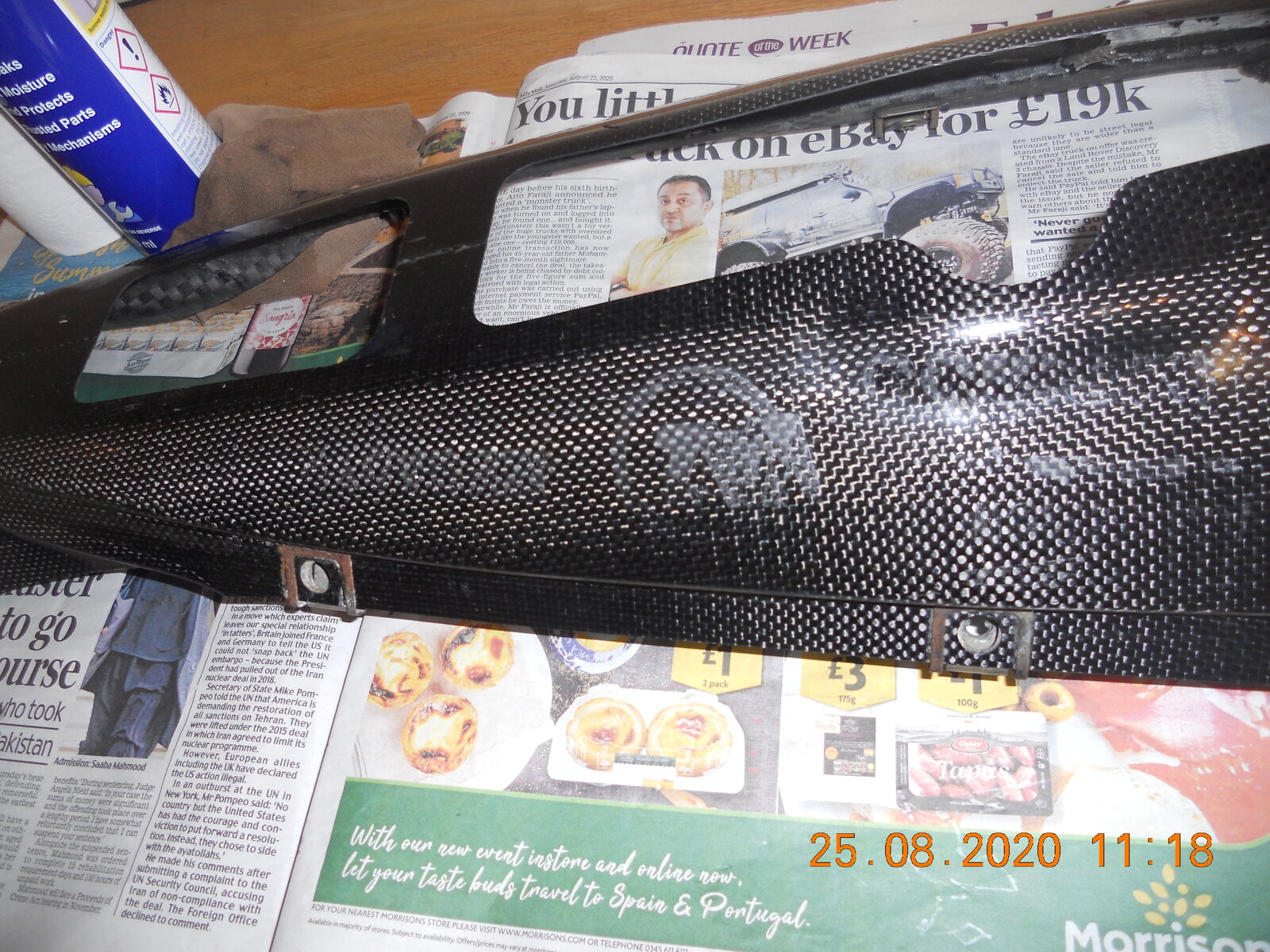

    Anyhow, I use GT85. Seems to lift residual adhesive etc. But that looks a bit next level. Not as harsh as brake cleaner etc.. :upyeah:
  2. You should be writing the next Harry Potter book;),it's just sitting on top of the surface and needs careful keyhole separation surgery & not black magic....experiment on your own C.F,:upyeah:

    But your right it's heavy duty adhesive that needs to unpropagate,gravitate itself elsewhere,PDQ...or it goes back on the bike as is for a few more rides this year.
  4. I'd agree with those that use Mr.Sheene, always use it & it never fails. Just spray some on & leave it to soak for a few minutes, then wipe off. Sometimes you might need a second application for more stubborn glue !
    I much prefer it to using any type of solvent, espicially on carbon, even more so on structutal carbon, (wheels for example).

  5. acetone, or break cleaner or nail varnish remover.
    Don't over think it, it's a hard resin and will stand up to quite a lot of crap thrown at it.
    If it's a polyester resin then acetone might attack it a bit more but whatever you use you shouldn't have that much of a problem on the substrate.

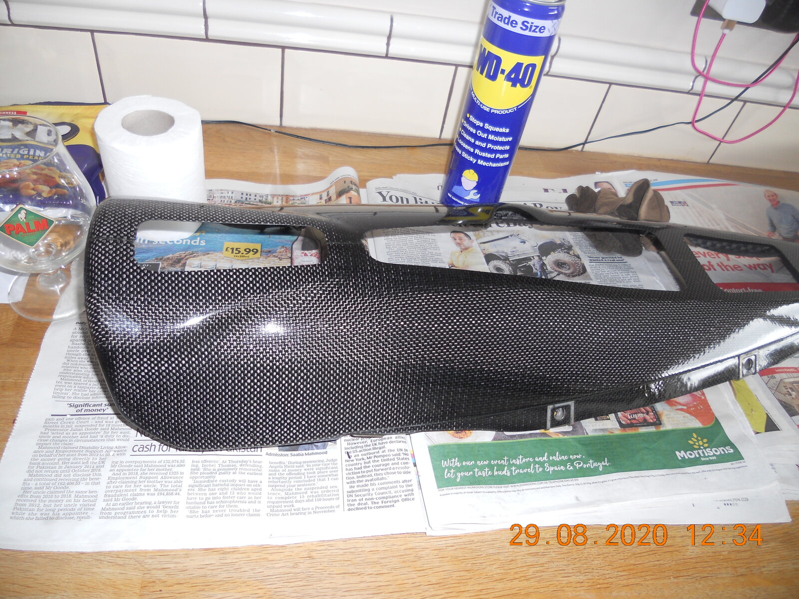

    I cracked it last night with a can of elbow grease and one or two stella's plus salted nuts,but carried on applying the WD40 and very happy with the result & No damage to the finished surface whatsoever.

  9. A really easy method would probably be using a finishing spot pad on a Dual Action machine with a cleaning polish if it i is just the remaining residue.
    As its a cleaning stage you would not be correcting the top coat but it will essentially polish out the remaining marks. Next time give that a try as it makes it a lot easier.
  10. Lovely many thanks for that advice,much appreciated.:upyeah:...it's back on the bike now and looks much better without them.IMO
