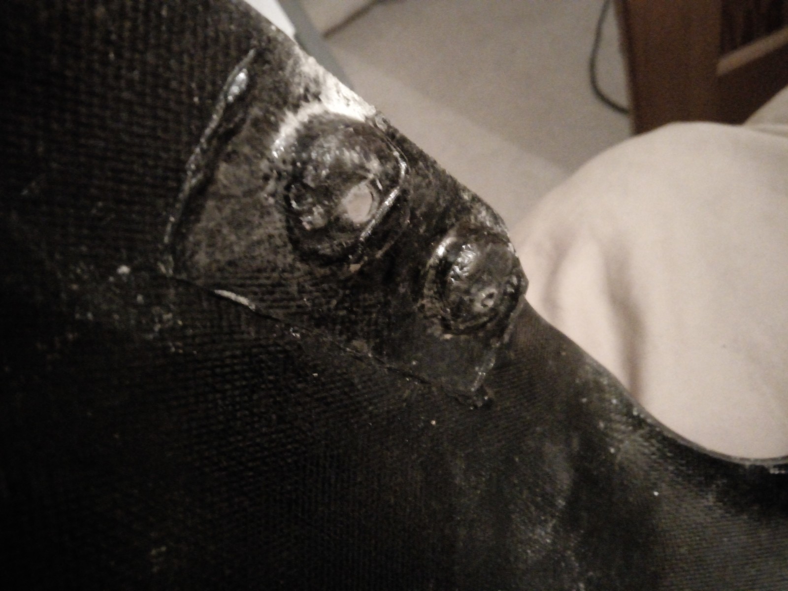

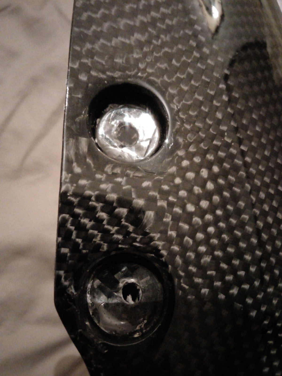

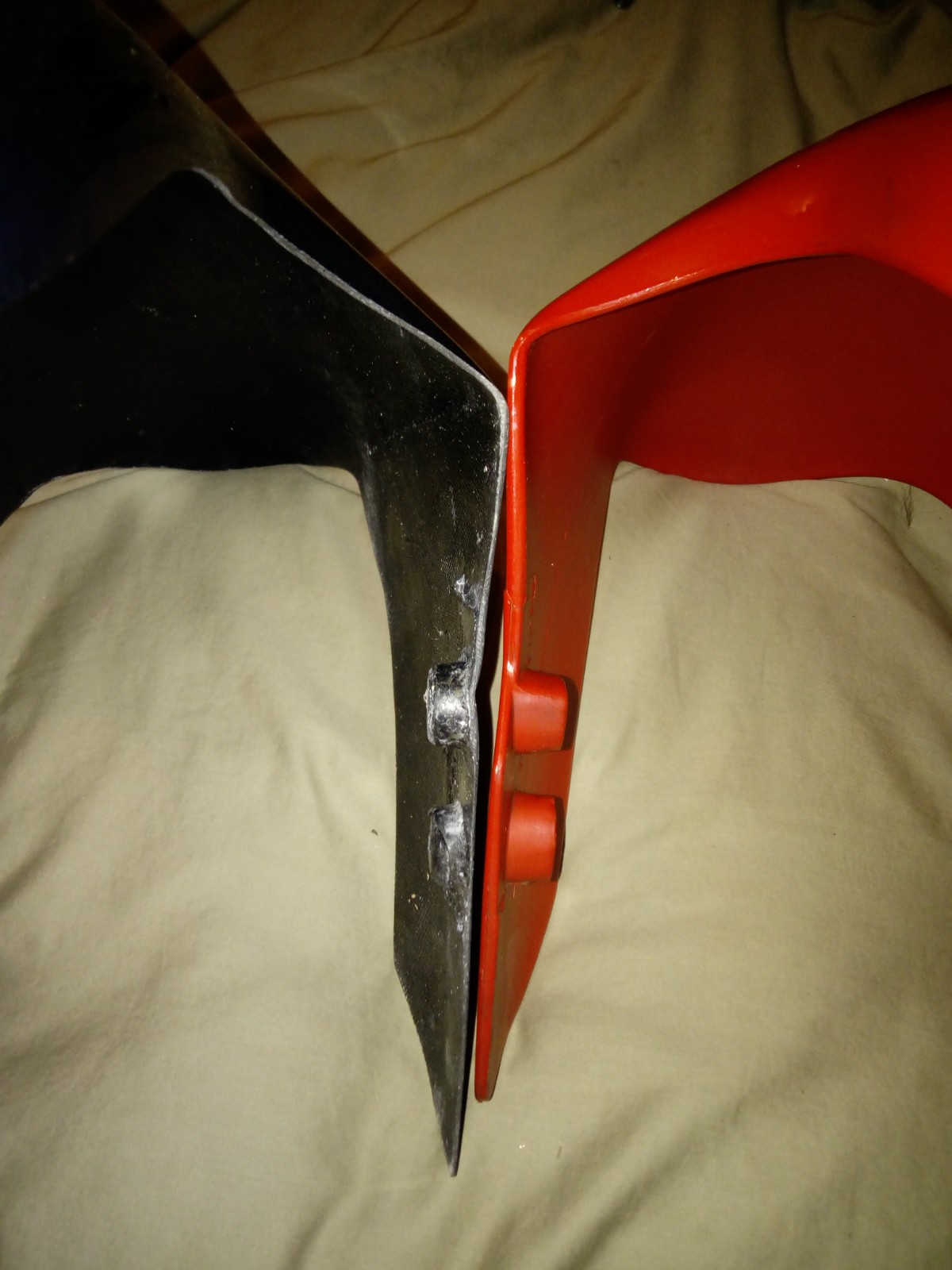

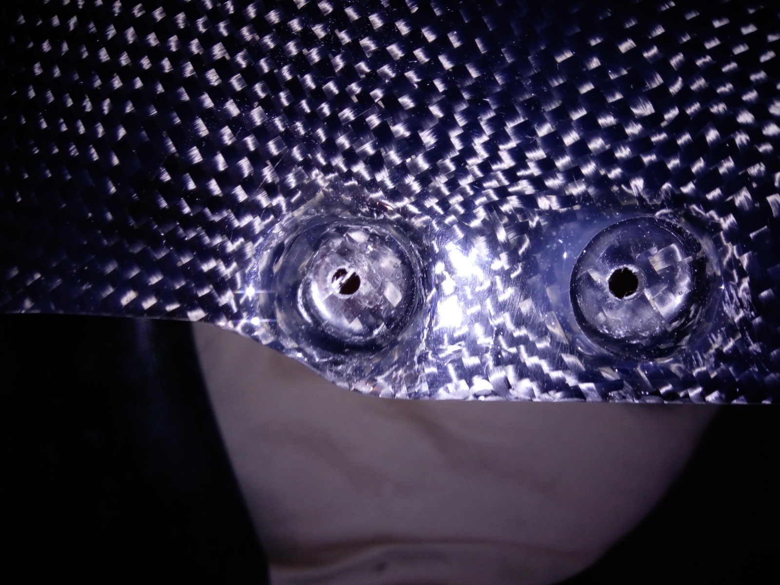

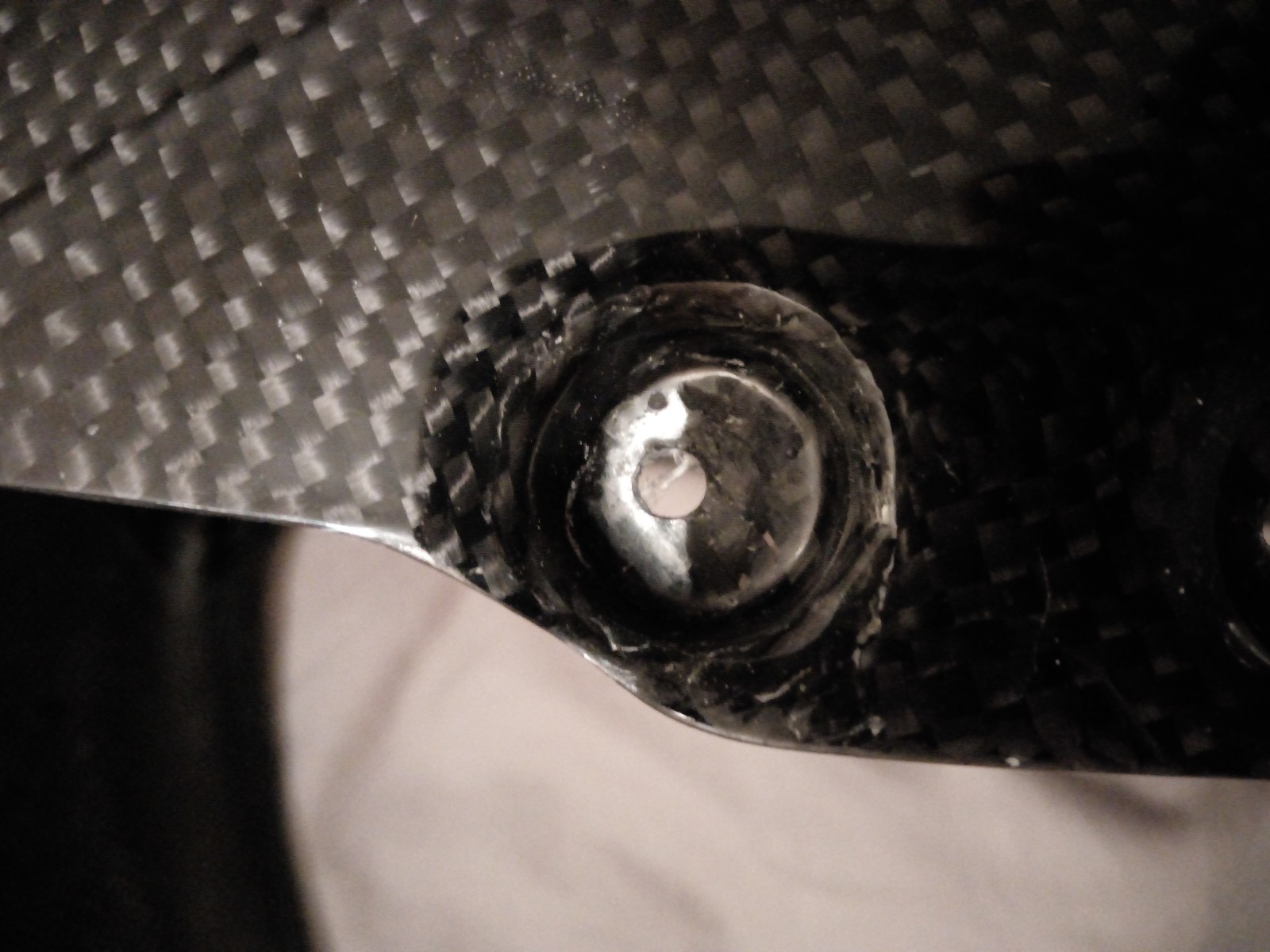

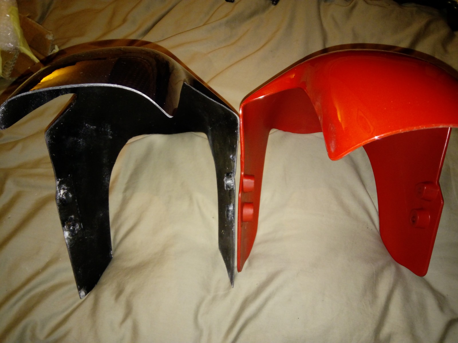

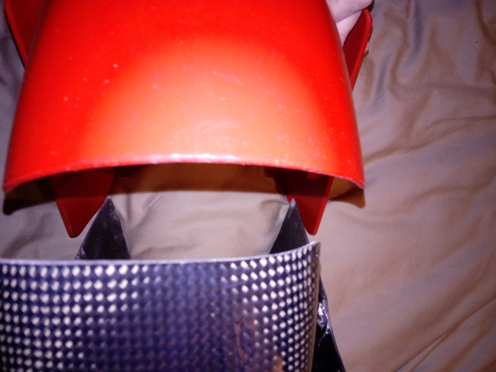

  2. I offered the mounting points up to the fork leg, and surprisingly not far off but nowhere near the OEM part.
    The sides are noticeably longer vertically. Won't know for sure until I get the bike fully reassembled.
  3. Slot the misaligned hole.
    The head of the fastener is big enough to hide it all.
    Use a round diamond or permagrit file and you’ll be fine.

  12. QB Carbon do not do a good front mudguard for the SS, I had three from them and they were all touching the tyre at the back. They blamed the mould.
  13. if they took the mould from the original ducati carbon part then that too touched the tyre at times.
    You need to understand with composite stuff that it's not production fit, and you have to do a bit of 'fitting' to get it to play right in many cases, so don't be at all surprised if holes need to be opened up or things tilted etc.
    Unlike the stock production part these things will sometimes flex or twist out of a mould, and made worse if the layup isn't balanced - which many of the stuff that's pumped out isn't.

  15. The OEM mudguard will sag over a period of time. You can see the OP's one has already started to do it if you look at the sides in the pic above.
    This causes the mudguard to either trap stones between the tire and the inside of the guard, or it will touch the tire.
    Unfortunately if the back of the guard touches the tire, it can get grabbed on the trailing edge and then you have a problem because it either wears the trailing edge away or it gets shoved up between the forks.
    I cured the sag on mine.....not hard to do if you have the right bits and pieces.
