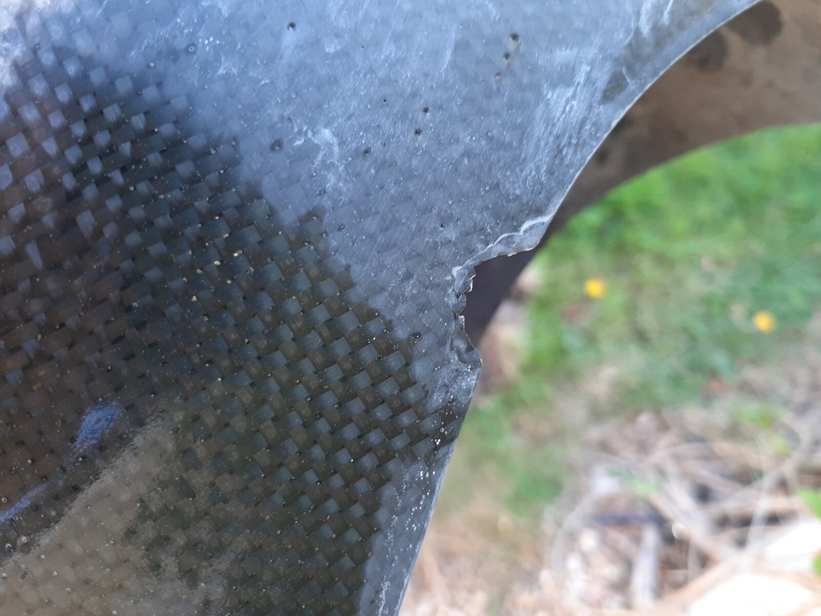

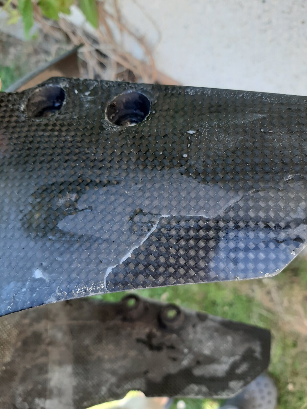

  1. Quite a while ago the front mudguard on my Superlight suffered slight damage due to some fool (ie me) moving the bike with the D-lock still on the wheel. I'm now working on repairing this which I intend to do with a small patch. It wont be perfect but will hopefully be better than before. As much of an issue in my eyes is the subsequent relacquering - in some places the existing lacquer has started to 'lift off' and I have pulled areas away where this is the case but I'm wondering what the advice is for dealing with the rest? I've been wet and dry sanding, starting with 240 and 600 grit, which is slooow going- should I just continue with this? Thanks in advance. Andy 20200419_152209.jpg 20200419_152239.jpg

    I’ve tried T-Cut over and over with little success.
    Any polish applied simply goes to temporarily brighten it.
    Lacquer might be the way forward.
  3. The top coat/lacquer seems quite hard and brittle or 'crispy' and isn't sanding off easily but with a couple of areas own to the carbon I'm resigned to removing of it - by some means.
  4. It is the original so that's useful info. Think I'll continue sanding the areas that need sorted then give it a go with lacquer and see what it looks like.
  5. The more time in prep the better the result. Be careful where the original lacquer has gone awol as you don’t want to rub the original resin and carbon away. Take your time and enjoy the process. :upyeah:
  6. Thing is there are a few places where the top clear layer (resin/lacque? - i can see that it imparts a slightly brownish finish to the carbon) Is lifting off or has chipped away so before I refinish it I want to al least feather the edged of the damaged parts down. Enjoyable, hmm, end result hopefully ok. Taking a bit longer than I'd thought but going carefully.
  7. Yup. You will have to feather it. Just take your time. And use a sanding block too.

  9. Bit more of this today- have flatted back pretty much the whole thing - advice would be to not try and do more than than unless.the top.coat is damaged?
  10. It should be super smooth when you run your bare finger tips over it with lots of soap water. You can really feel any imperfections that way.
  11. y, not there yet, that top coat is pretty tough - makes sense as it provides protection to the paint beneath.
    My mudguard is stamped "MS Production" in yellow which I guess indicates it isn't original?
