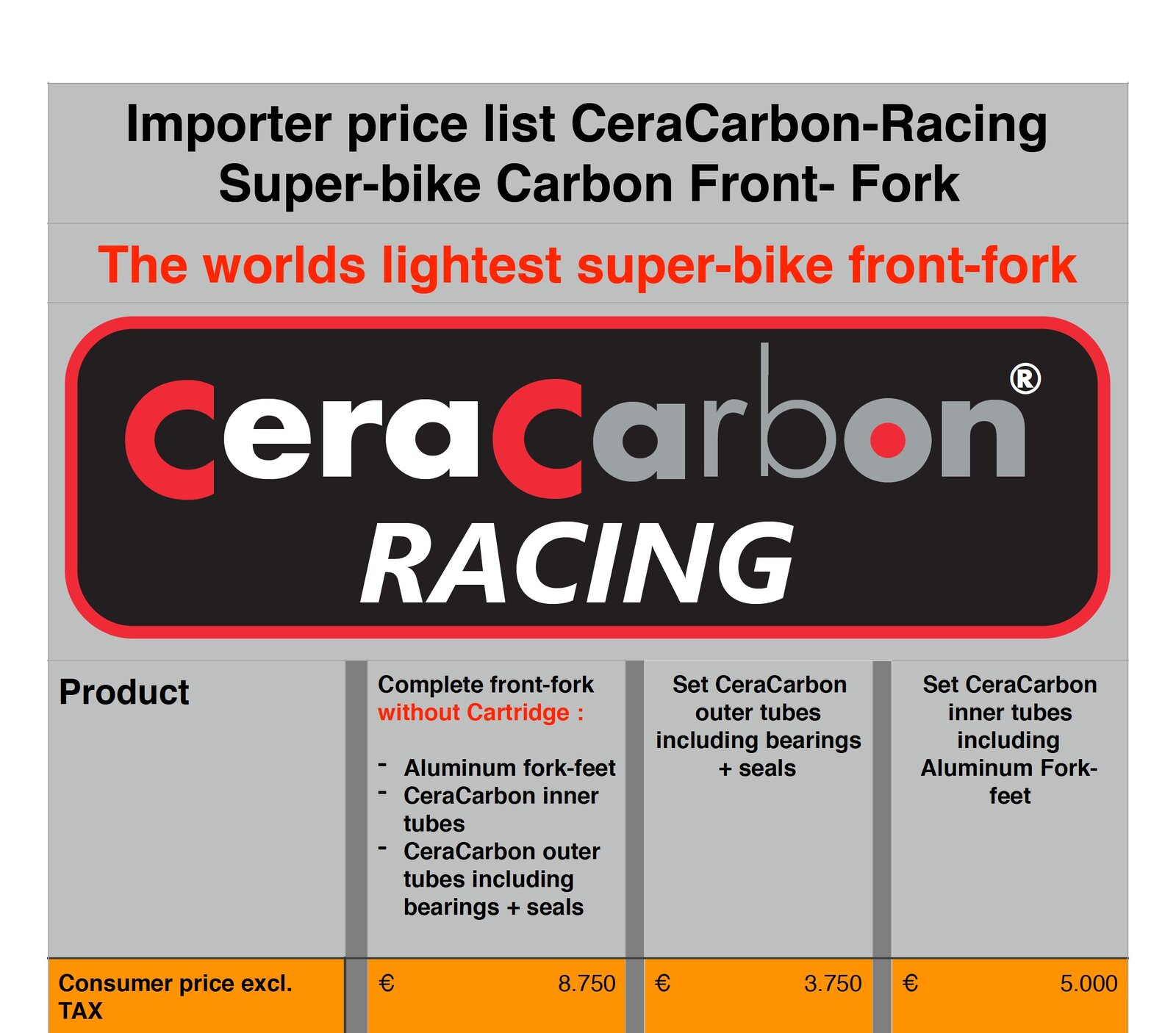

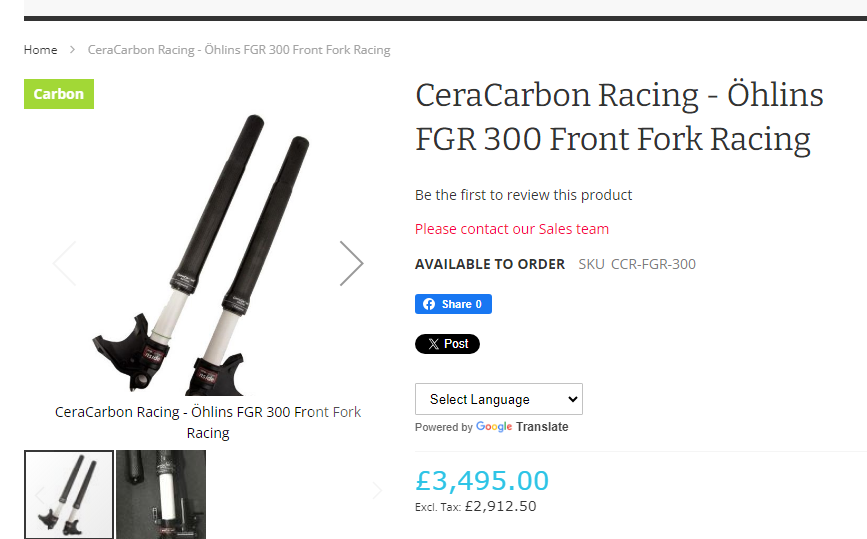

    The world's lightest wear resistant products.
    CeraCarbon front-forks are currently still custom-made to order.
    Fork Tube options:
    • CeraCarbon Racing Outer Tubes (Set) - mostly Plug & Play.
    • CeraCarbon Racing Inner Tubes (Set) - assembly to take place at CeraCarbon, fork feet and the cartridge to be supplied by customer.

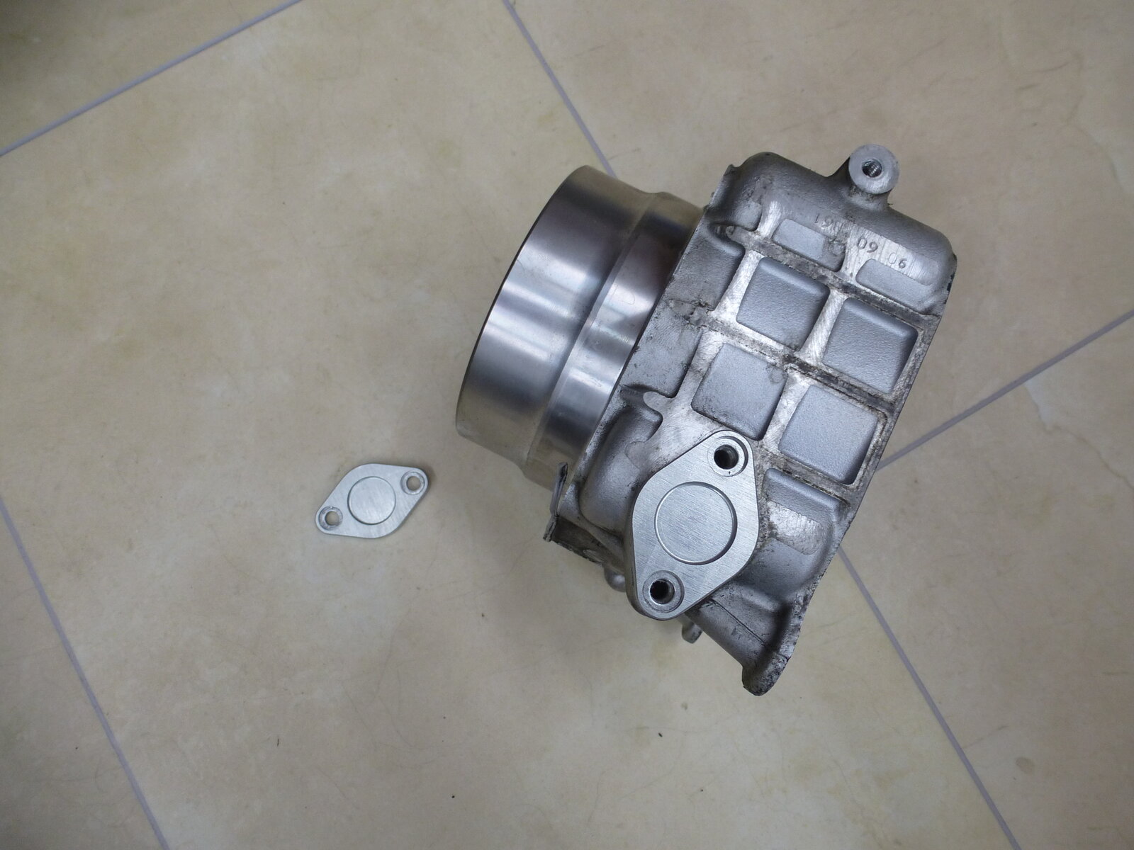

  5. :D

  6. Yep, that’s what I was quoted:sob::sob:

    And if you take a factory Ă–hlins fork you only have a Ă–hlins. But not a Carbonfork. And i have this CeraCarbon-fork since may 2018.

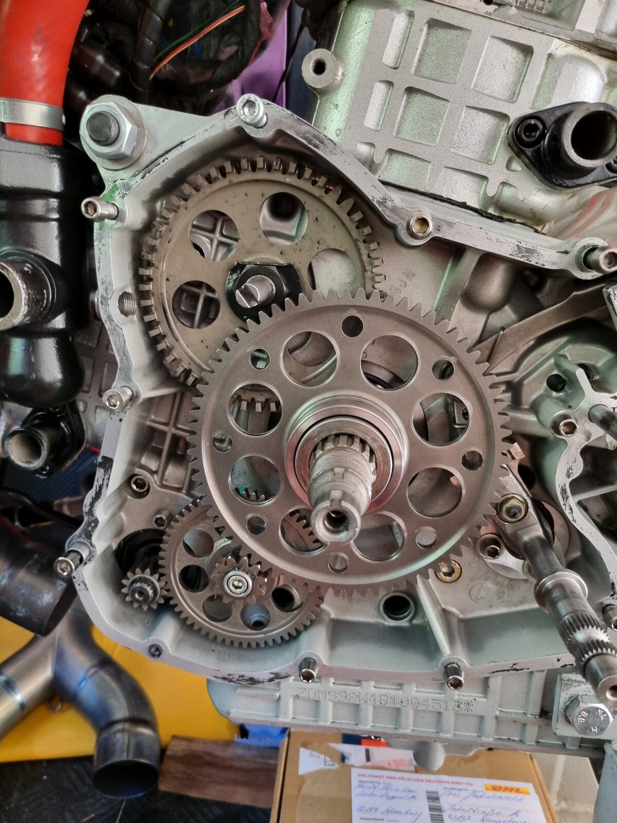

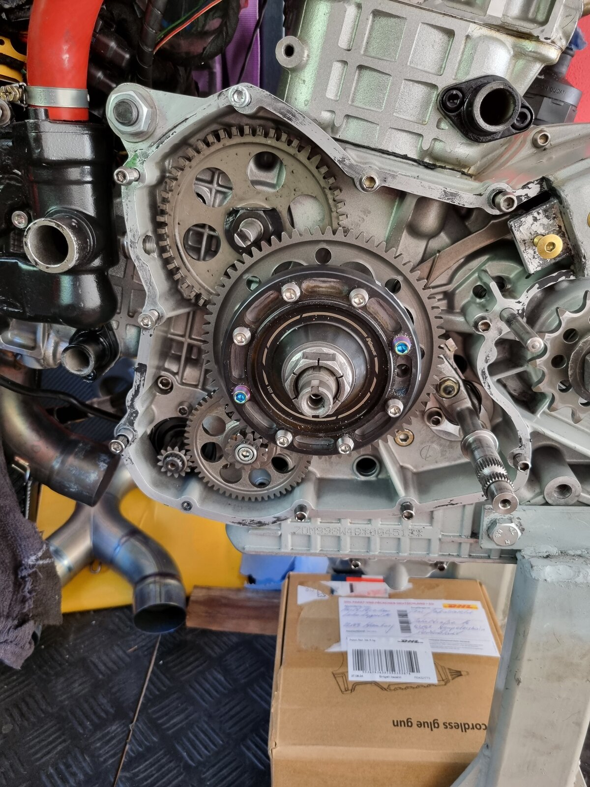

  10. Update:
    The engine is now 3kg lighter. Parting out the alternator, lighter flywheel.

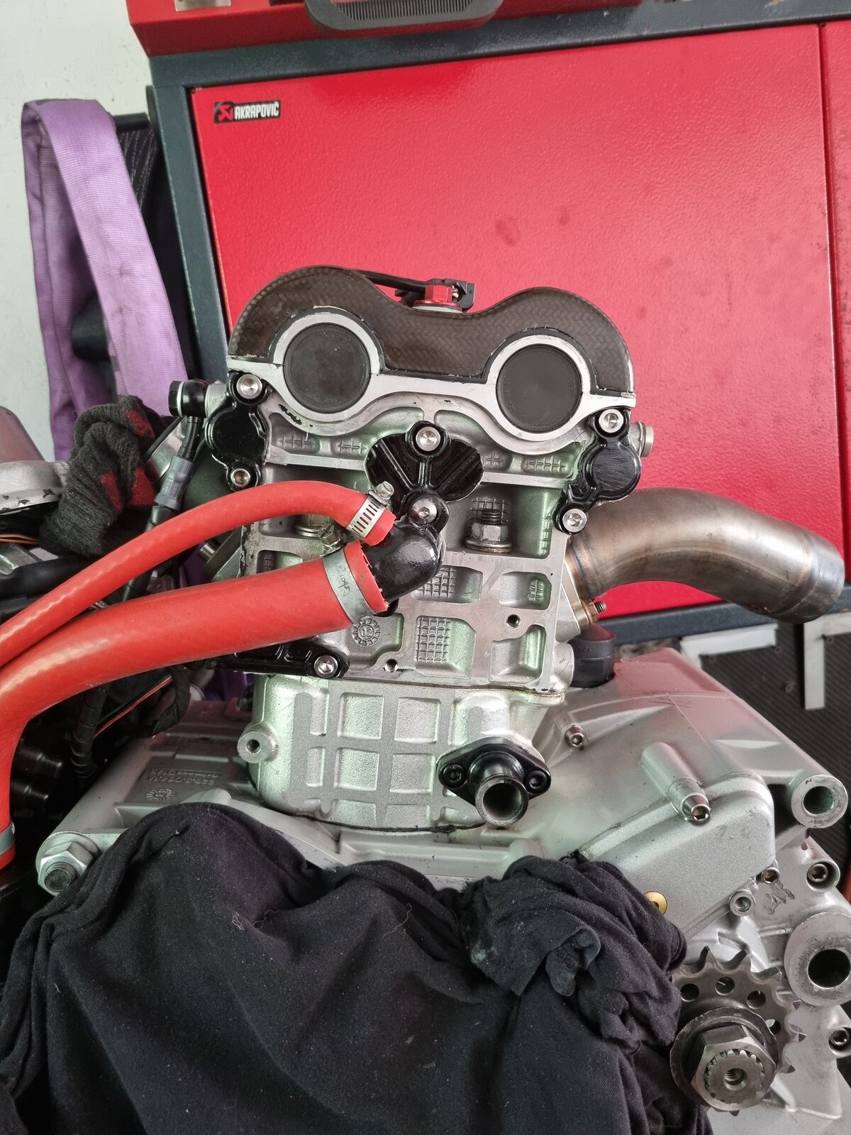

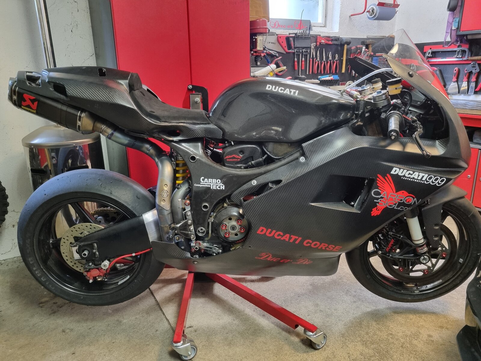

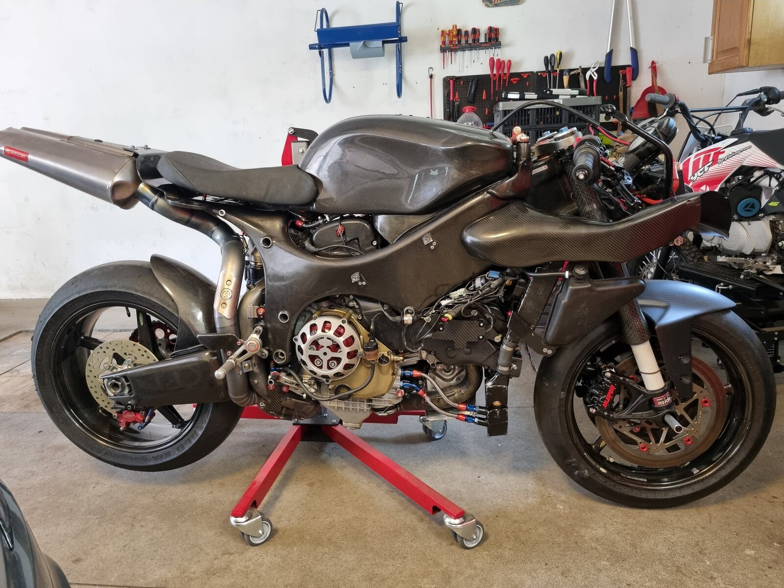

  13. Update.

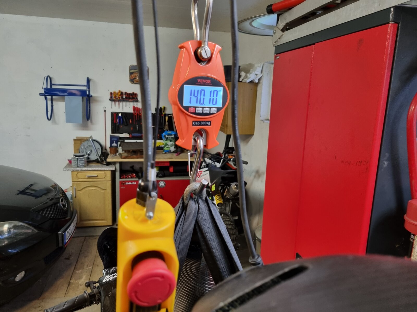

  14. Dryweight. Without Oil and Water. But its not ready. I think 139kg middle is possible.

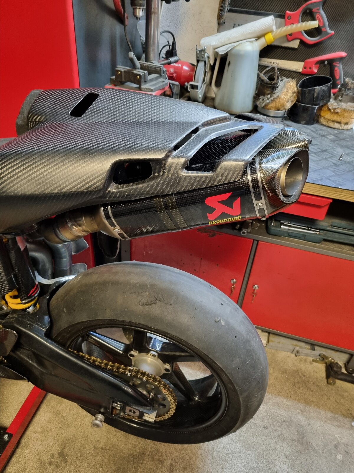

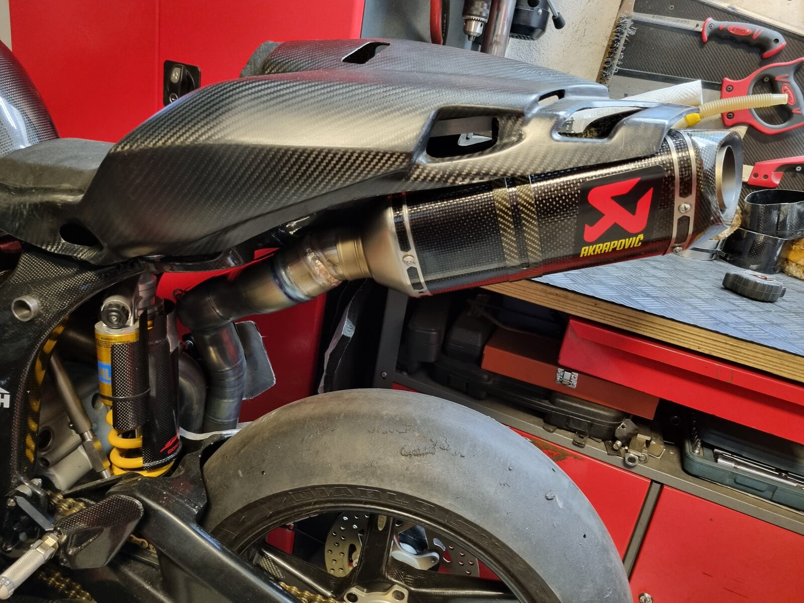

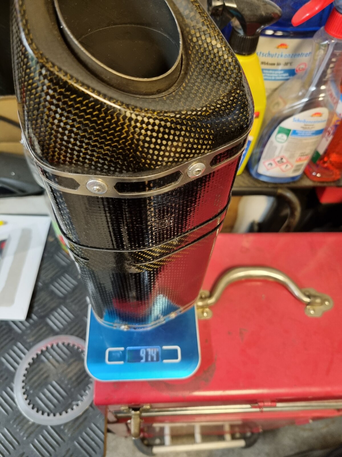

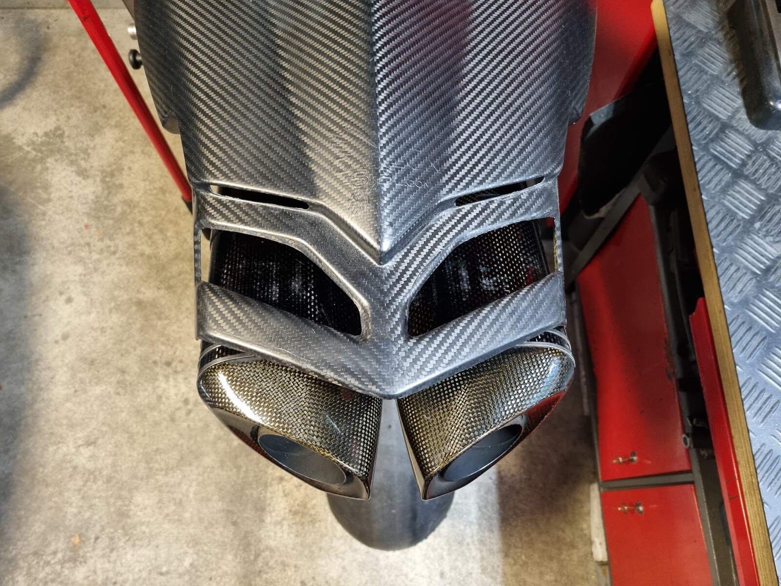

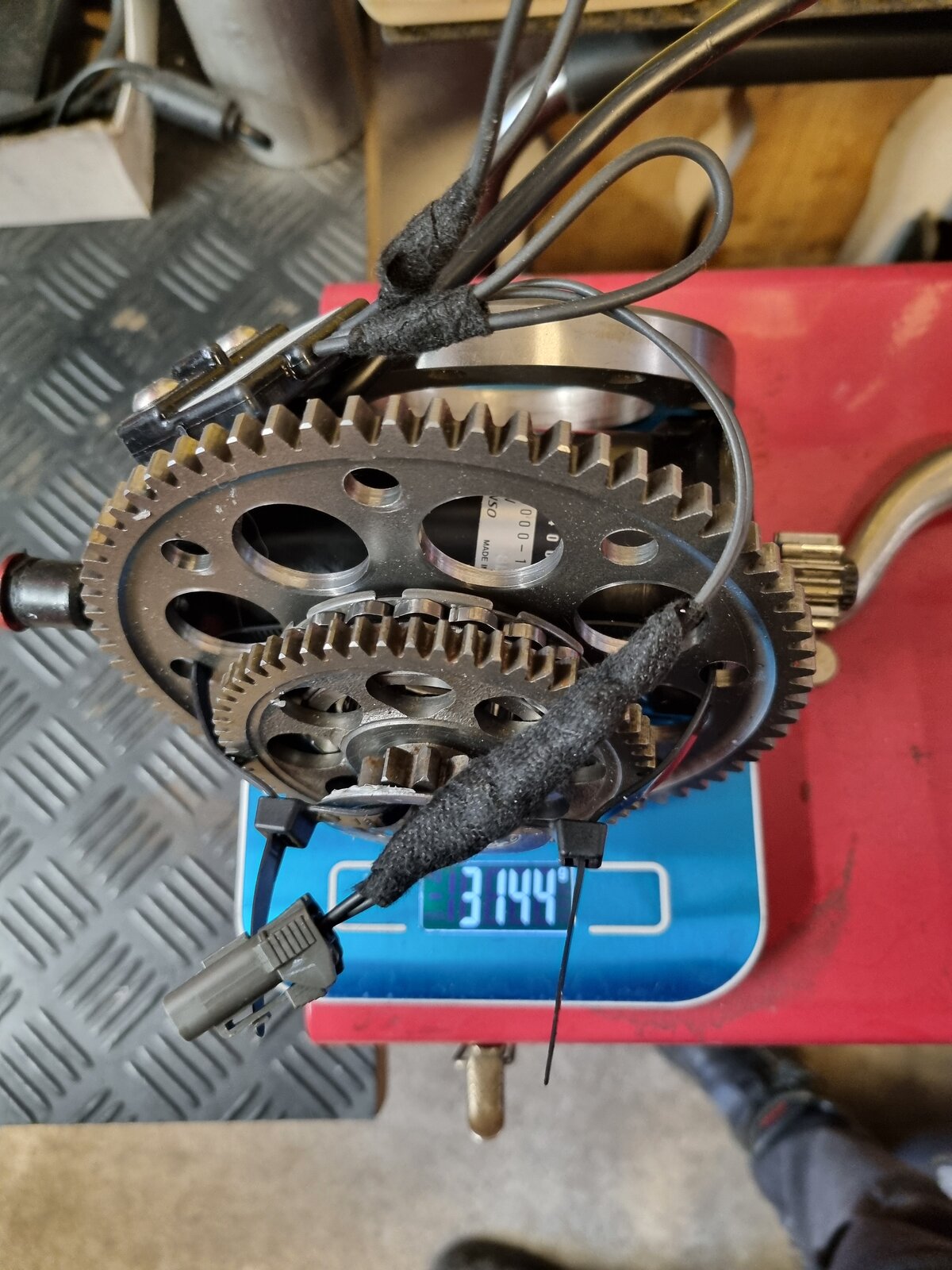

    As the next step to reduce the weight i'm parting out the starter, starter relays and the complet assamble. Saving over 3kg.

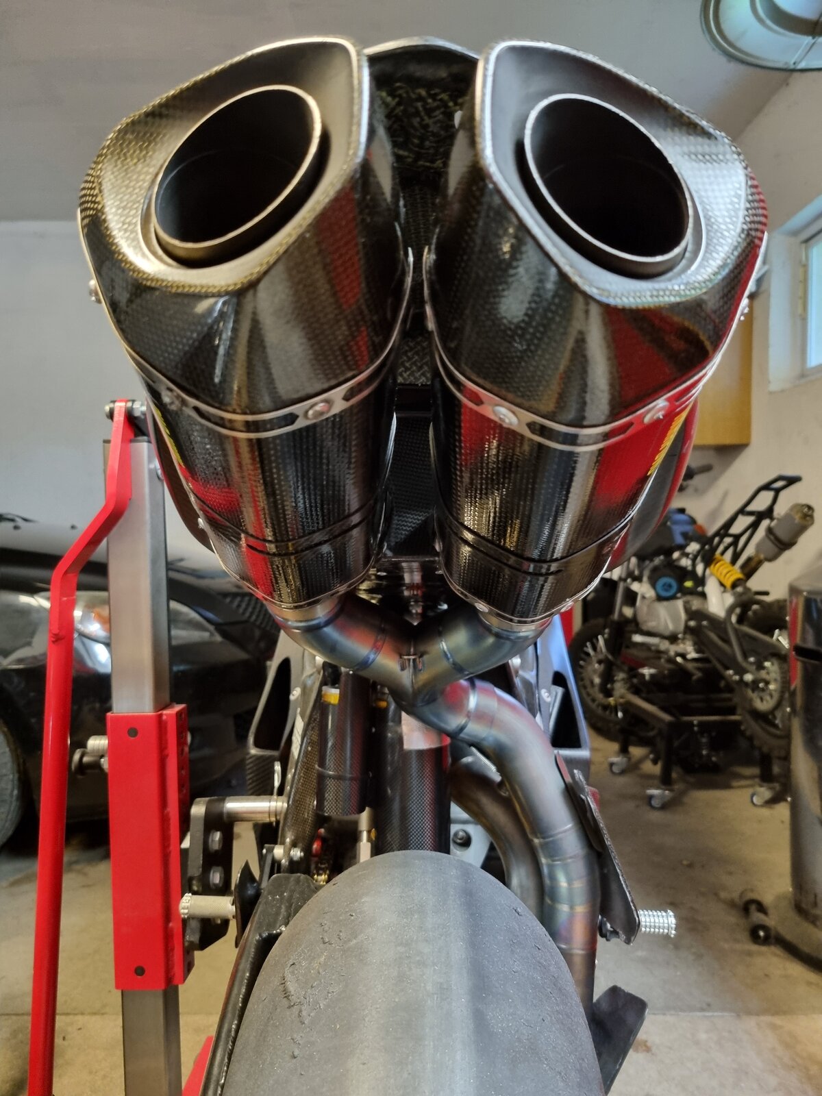

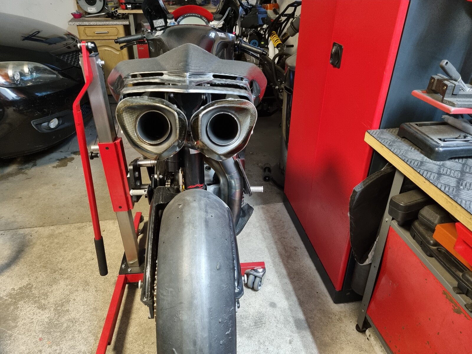

    As the next i change the cans. In my opinion the Motocorse-can looks not so good. Now i have the Carbon Akrapovic cans Ducati 1098/1198. Shorter(from 320mm down to 250mm), this was perfect. 1 can is now only 974gr.

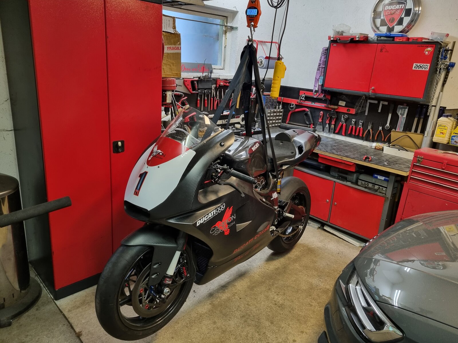

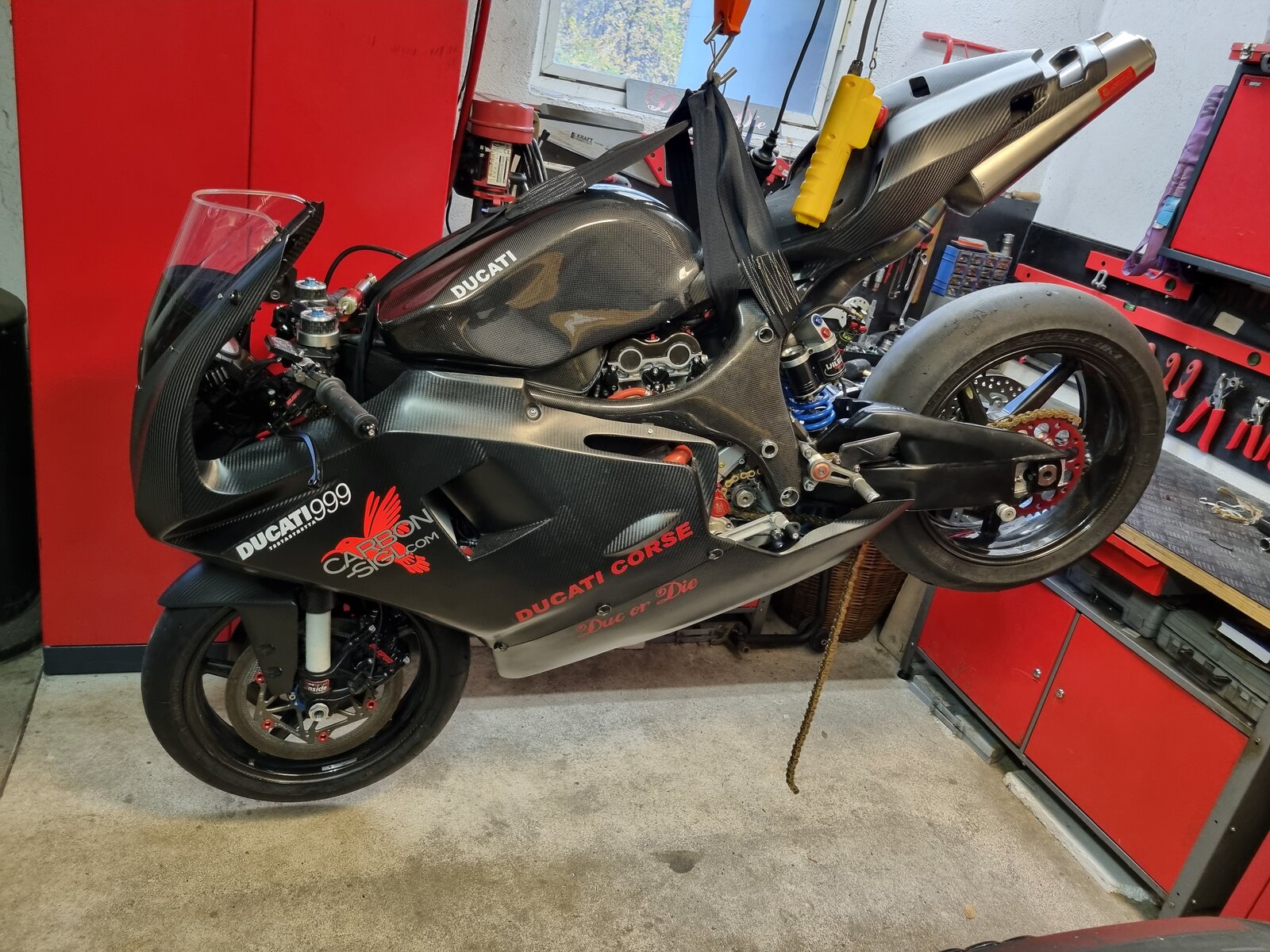

  19. And the new dryweight is:
    135,5kg
    :D
  20. Wow wow wow!!!
